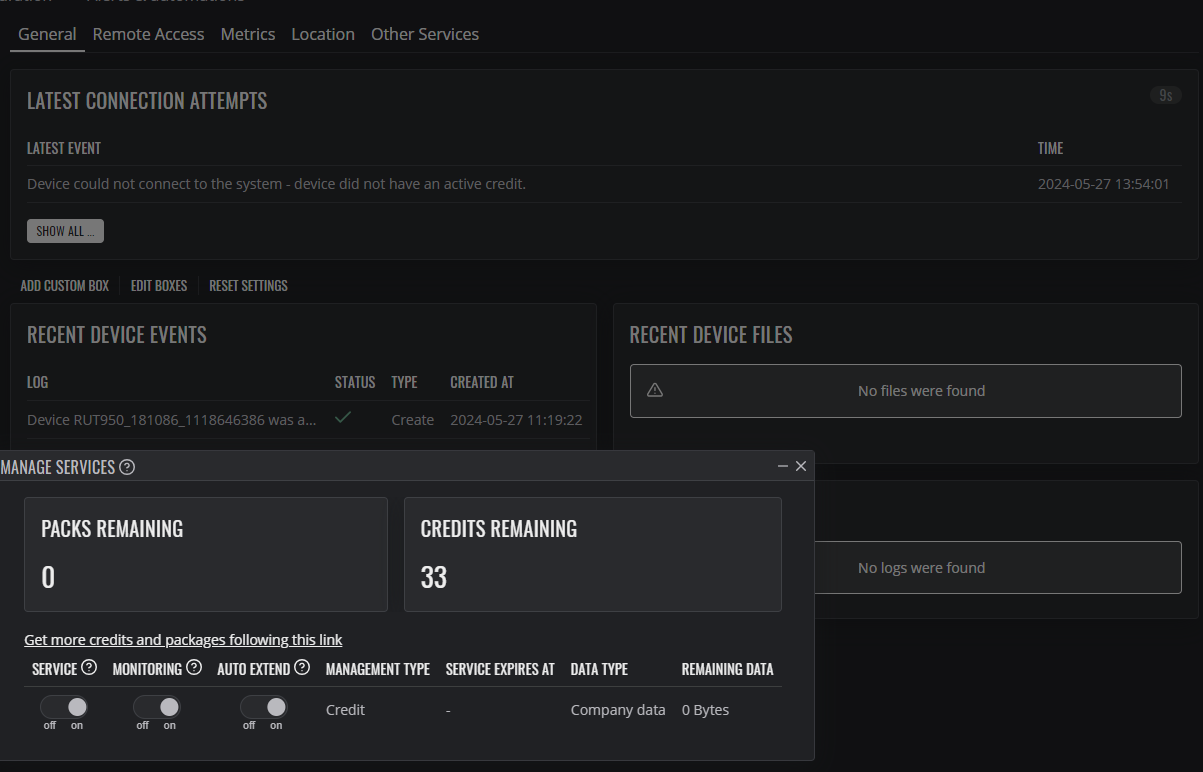

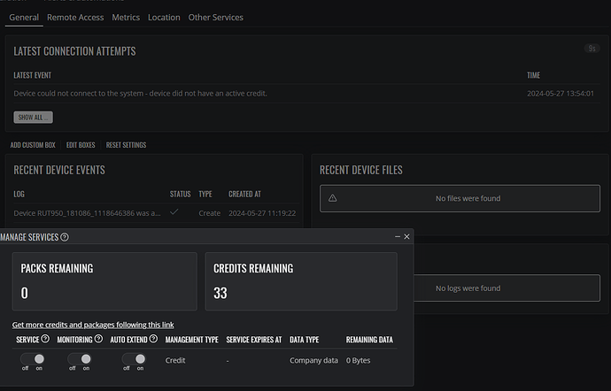

I’m trying to connect a router to the RMS, but I get an error: “Device could not connect to the system - device did not have an active credit.”
However, we have licences (credits remaining 33)

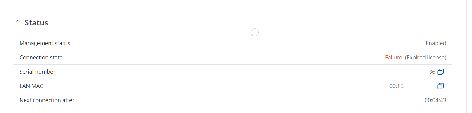

In the router, the connection type is enable, the status of the connection to the RMS is failed (expired license).
I am using the hostname : rms.teltonika-networks.com
Do you have any suggestions how to solve this problem?

The RMS service is enabled, as is “Connection type”.

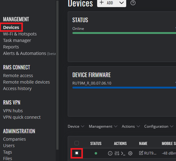

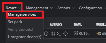

Just to make sure we are talking about the same thing, I mentioned that you should enable the Service on your device in RMS. To do that, please follow these steps:
  1. In RMS go to Management → General and select your RUT950.
  2. Press ‘Device’, and from the drop-down list select ‘Manage services’.

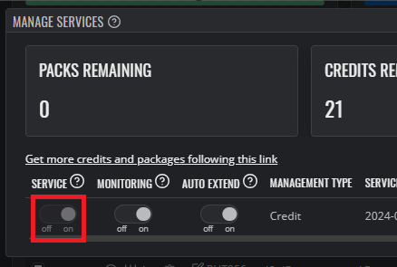

  3. In the pop-out window, make sure that ‘Service’ is enabled.
Please let me know how it goes!

In the RMS, manage service is actived and RUT950 uses the latest firmware version (07.06.11)
Thank you for confirming this information. Could you please try unregistering and then registering your RUT950 to RMS to see if the issue persists? Thank you!

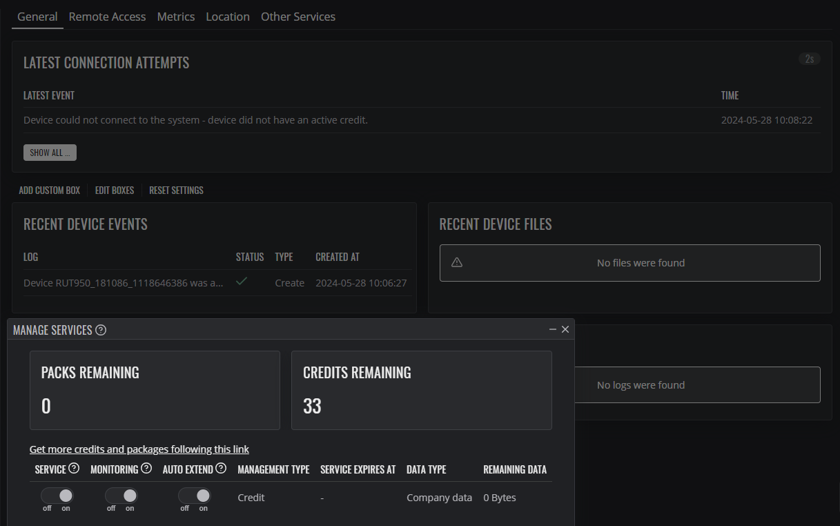

I have just unregistered and registered my RUT950 again and the issue persist.
screenshot of the RUT950:
Could you please try adding your RUT950 to RMS one more time and check if the issue persists? If it does, I will send you a form to fill out so I can contact you privately.

The RUT950 is now connected to the RMS.
What was the problem?
I’m glad to hear the issue is resolved!
The device was previously added to a different company, and when you tried to add it to your company, it attempted to connect to the other one. We have removed it from the previous company, so it should now connect to your RMS without any problems.
