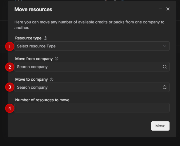

As a temporary workaround, you can manually transfer resources from the parent company to the child company. To do so, please navigate to Administration → Resources → Actions → Move resources. This will open a window similar to the one shown in the screenshot below:
In this window:
  1. You can select the type of resources you want to move (credits or management packs).
  2. Select the company from which the resources will be taken (FROM).
  3. Select the company to which the resources will be transferred (TO).
  4. Specify the number of credits or management packs you wish to move.
Once all fields are filled in, click the Move button and the selected resources will be transferred to the chosen company.
