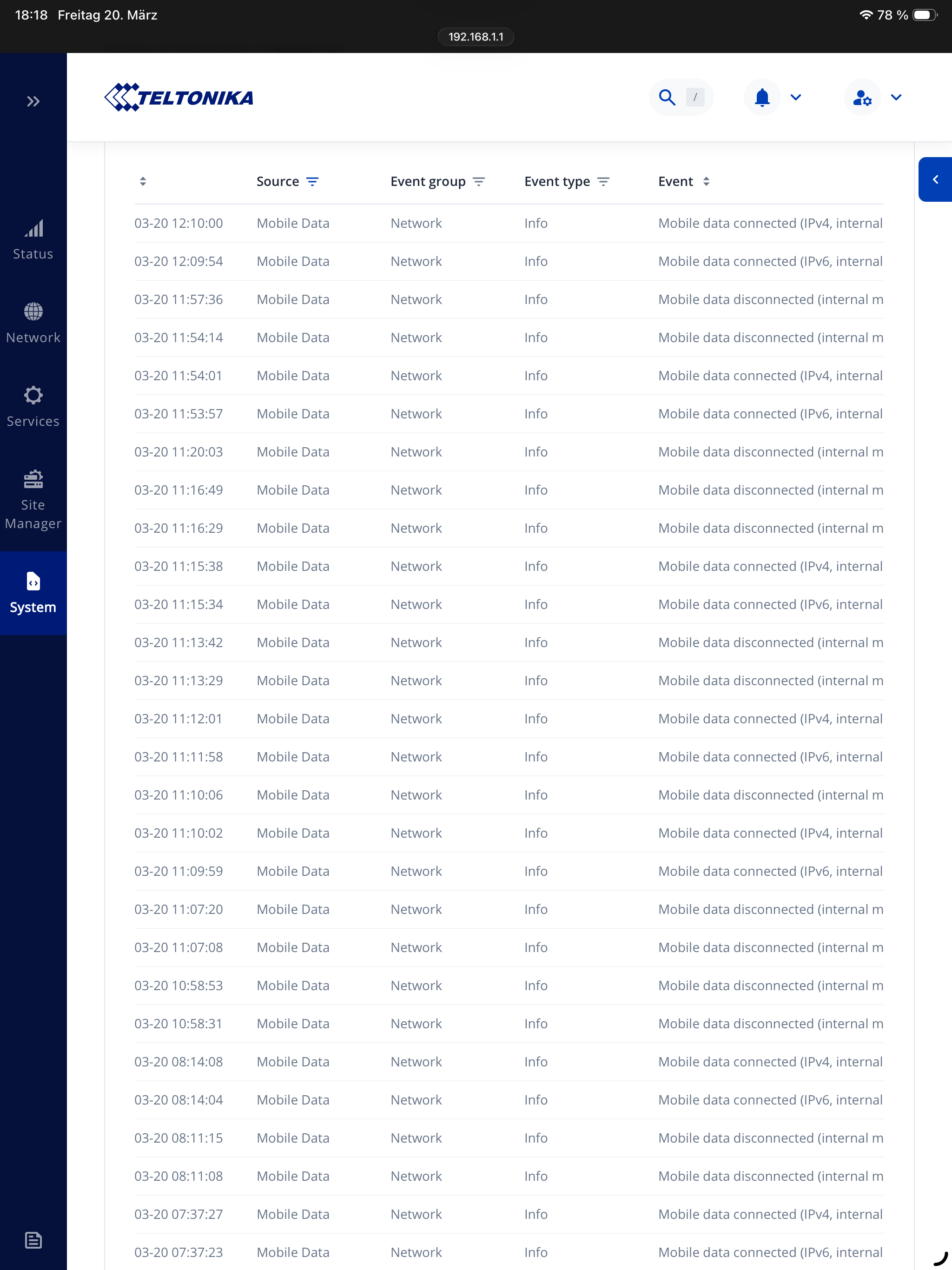

After the modem firmware update the modem became unstable and mobile connectivity cannot be established reliably.
Typical symptoms:
gsmctl -I returns N/A
gsmctl -q returns N/A
Internal modem shows limited service
Data connection disconnected
mobifd and gsmd running but unable to retrieve modem info

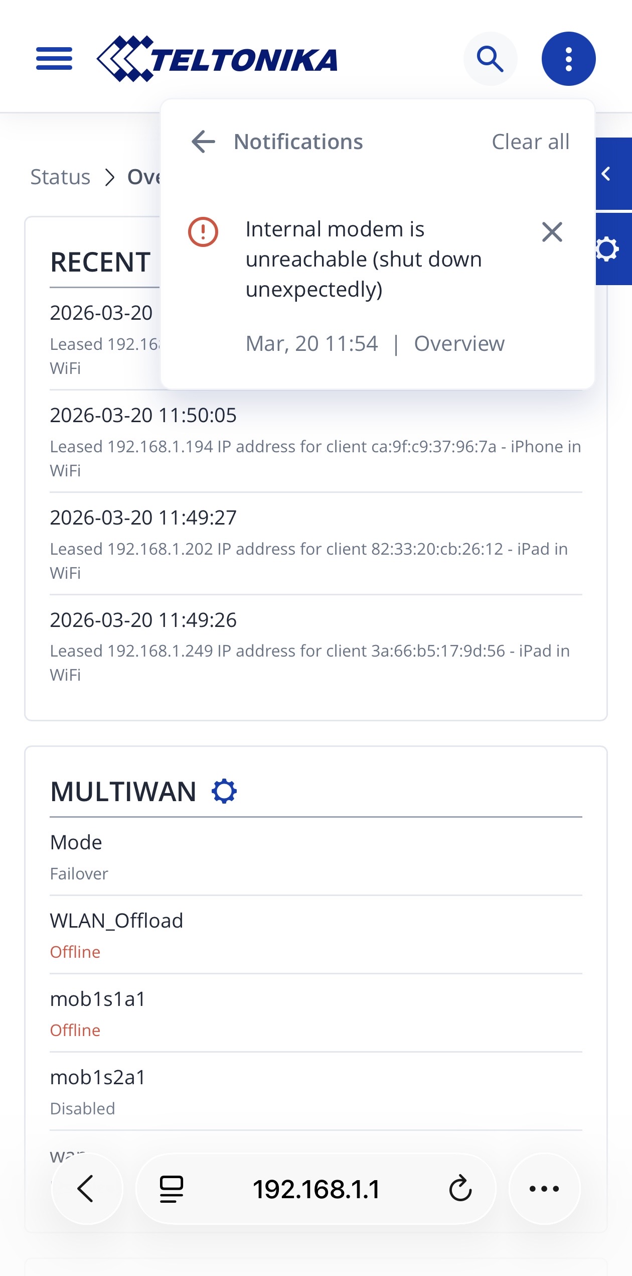

However modem frequently reports:
+QNWINFO: No Service
After modem reset:
AT+CFUN=0
AT+CFUN=1
Sometimes results in:
+CME ERROR: SIM failure
After this event:
gsmctl stops working and modem state becomes inconsistent.

Modem sometimes detects RF but fails registration and eventually reports SIM failure or becomes unavailable via gsmctl.
Since the problem started directly after modem firmware update this may indicate modem firmware corruption rather than configuration error.
