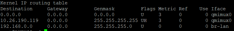

root@RUTX09:~# route -n
Kernel IP routing table
Destination Gateway Genmask Flags Metric Ref Use Iface
0.0.0.0 0.0.0.0 0.0.0.0 U 3 0 0 qmimux0
10.162.118.68 0.0.0.0 255.255.255.255 UH 3 0 0 qmimux0
45.74.0.0 0.0.0.0 255.255.255.0 U 0 0 0 PURE
192.168.0.0 0.0.0.0 255.255.255.0 U 0 0 0 br-lan

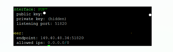

I think the WG is connected
WG show
Could you show the full wg output ?
Hi @flebourse
Can you let me know the CLI command to show the output you would like.
Many thanks for your quick reply
Just wg. Of course hide the keys.
If I disconnect and then do wg I just get the command prompt again.
Thanks for coming back to me
As shown, the tunnel doesn’t appear to be connected.
What is the value of the “latest handshake” line ?
Strangely there isn’t one. I will go and try it again and will come back to you.
Do you know what the ipv4 gateway address should be?
0.0.0.0/0 might interfere withe the default route. Use 0.0.0.0/1 + 128.0.0.0/1 instead.
No, not yet.

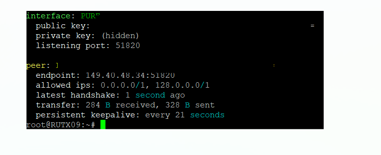

So the tunnel isn’t connected.
Hi again @flebourse
Thanks for your patience.
This time the tunnel appears to be connected. Change Allowed IPs to 0.0.0.0/1 + 128.0.0.0/1
Thank you. I can confirm I have done this

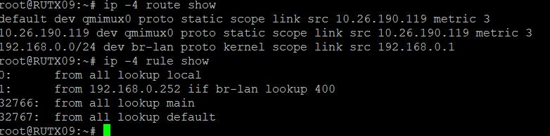

What are the outputs of:
ip -4 route show
ip -4 rule show
the route PURE is no longer showing
