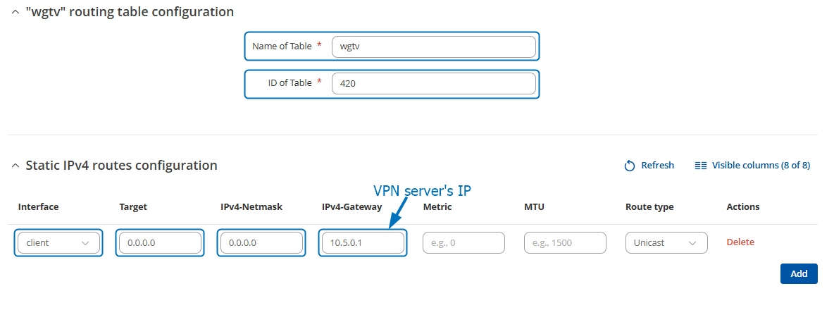

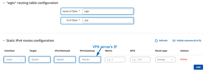

2. Add Static Route to the Table
  • Inside the routing table configuration:
    • Add a static IPv4 route
    • Set Interface to your wireguard client
    • Use the VPN server’s IP as the IPv4 Gateway
    • Click Save & Apply
    • Screenshot from my setup for reference:

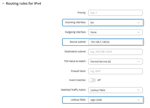

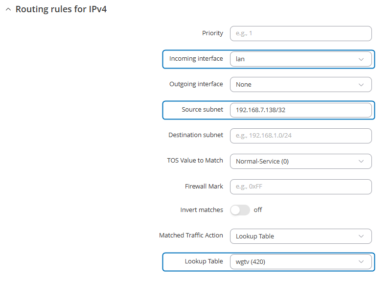

3. Create a Policy Rule for the TV
  • On the same Policy Based Routing page:
    • Click Add under “Routing Rules for IPv4”
    • Set:
      • Incoming Interface: lan
      • Source Address: Your TV’s local IP with /32 (e.g., 192.168.1.120/32)
      • Lookup Table: The one created earlier (e.g., 400)

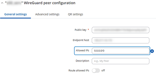

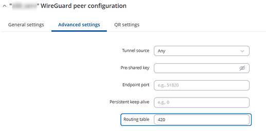

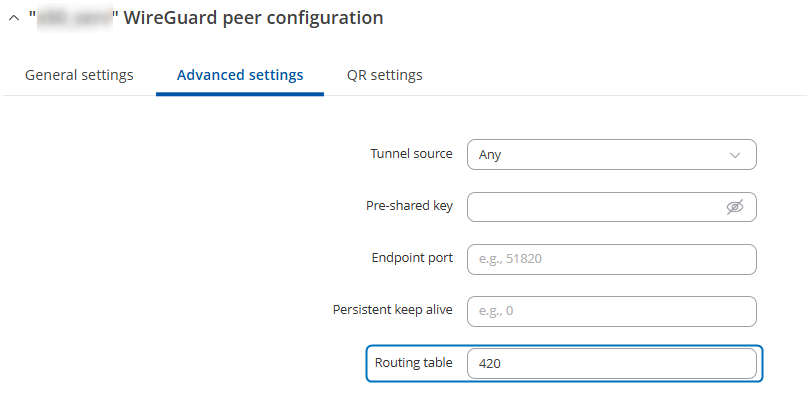

4. Adjust WireGuard Client Peer Settings
  • Navigate to Services → VPN → WireGuard
  • Click Edit on your client configuration
  • Scroll down and press Edit on peer’s configuration:
    • In Allowed IPs, enter 0.0.0.0/0
    • Go to Advanced Settings
After completing the configuration, this setup should ensure that all traffic from your TV goes through the wg VPN tunnel.
Note: If the setup doesn’t work, enable Route allowed IPs option.

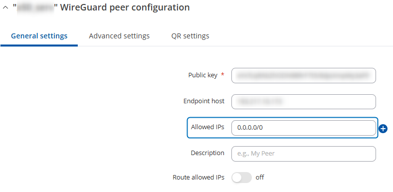

and part B, to spice things up, would it be possible this “routing” TV>VPN>internet to happen only when the TV tries to connect to a specific IP address/host (my IPTV provider), so VPN will only work when it connects to that IP, but the rest of the TV stays out of the VPN tunnel?
TV>internet
and when i use iptv which connects to a specific host/ip then
tv>vpn>iptv host.
Kind regards and thank you for your time!
hey @anon65719490 any chance i could do this? the previous post i made.
Yes, replace the 0.0.0.0/0 value in the Allowed IPs list by the address of your IPTV provider.
