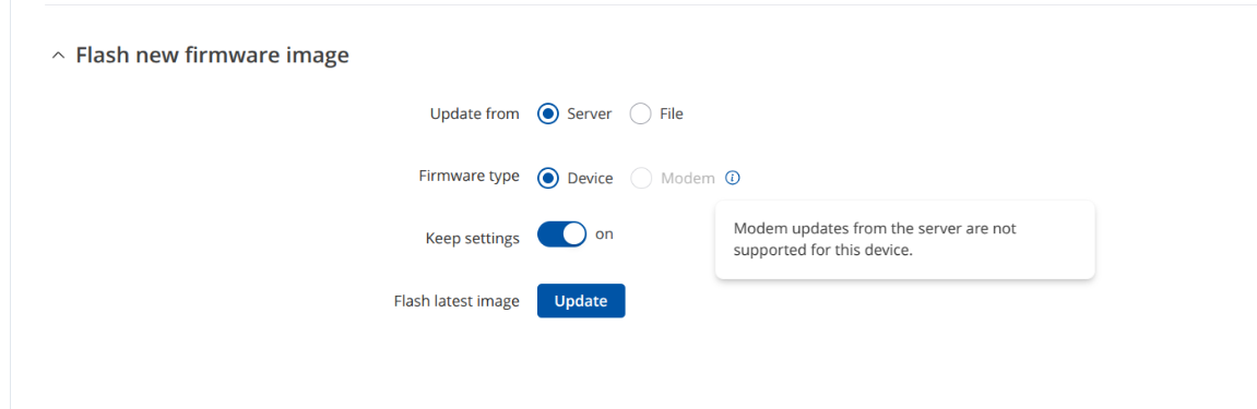

I recently bought TRB500 5G gateway. I already managed to update the firmware version from the server, but not the internal modem firmware. When I try to update the internal modem it is just grayed out and informs: “Modem updates from the server are not supported for this device”. Where I could find new firmware for the internal modem?

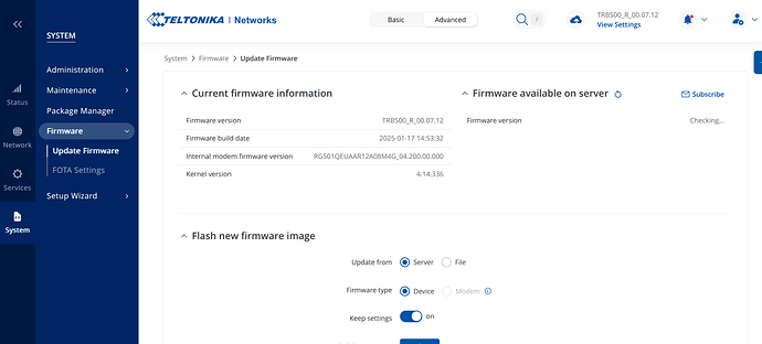

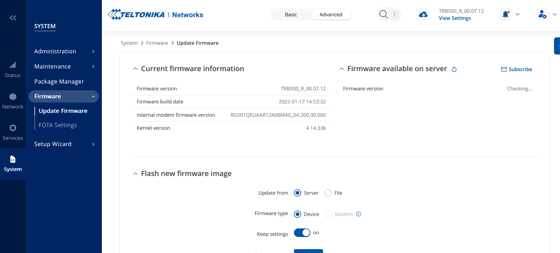

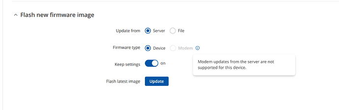

I don’t know if I’m doing something wrong then. Here is screenshot from the update page.
There where also another discussion about internal modem update, but it was already closed. Here is link for that discussion.
TRB500 can only be updated by going through Teltonika Staff.
They will ask you why you think you need/want this update and then they will guide you through the process.
No official download available for TRB500 modem firmware.

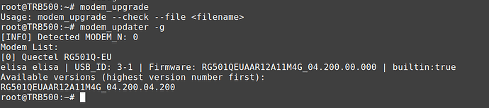

I finally managed to update the internal modem firmware.
Here are the steps that I used to update TRB500 internal modem firmware:
I don’t take any responsibility if something goes wrong!!
  • Install SSHFS package via Package Manager;
  • Login as root user to your TRB500 and run following commands:
opkg update
opkg install modem_updater
modem_updater -g     # you should see you current firmware and available versions
modem_updater -v <version>

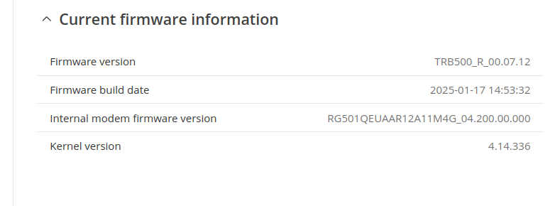

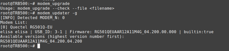

But there’s one strange thing about the version numbers. The internal modem firmware version available in modem_updater is RG501QEUAAR12A11M4G_04.200.04.200, but after the update, the new firmware version is RG501QEUAAR12A11M4G_04.200.00.000.
I think the update was applied (previously R12A08, now R12A11), but the end of the version number didn’t change. Here are some screenshots from the webui and cli.
Does anyone know a solution for this?

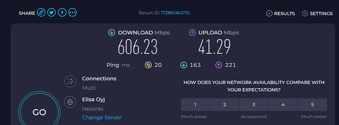

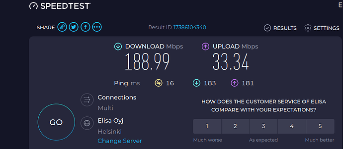

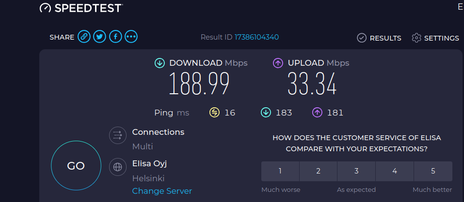

I’m also experiencing issues with download speed when changing the WAN mode.

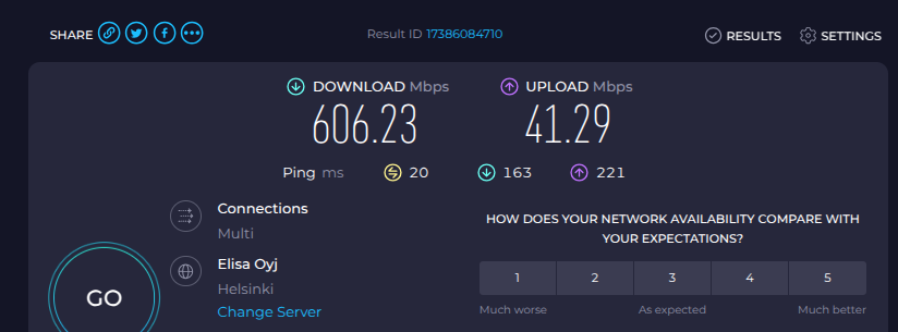

For some reason, the download speed is very good when the WAN interface mode is set to NAT, but when I switch to bridge mode, the download speed drops below 200 Mbps. In both cases, CPU usage reaches 100% during the download test.
I noticed that others in this forum have reported the same issue:
Do other Teltonika models have this issue, or is it only the TRB500? From what I’ve read on the Teltonika Community forum, some users seem to be experiencing the same problems with the TRB500.
@TeWe Do you have experience with the RUTX50? Does it have the same download speed issue when using bridge mode? It also seems to have a more powerful CPU than the TRB500, maybe it could help?
