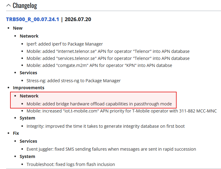

  • By the way, the firmware changelog mentions the Passthrough mode but not Bridge mode. Is there a reason for this limitation, or will a solution come also for Bridge mode?

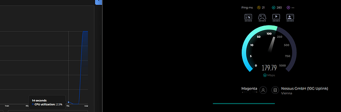

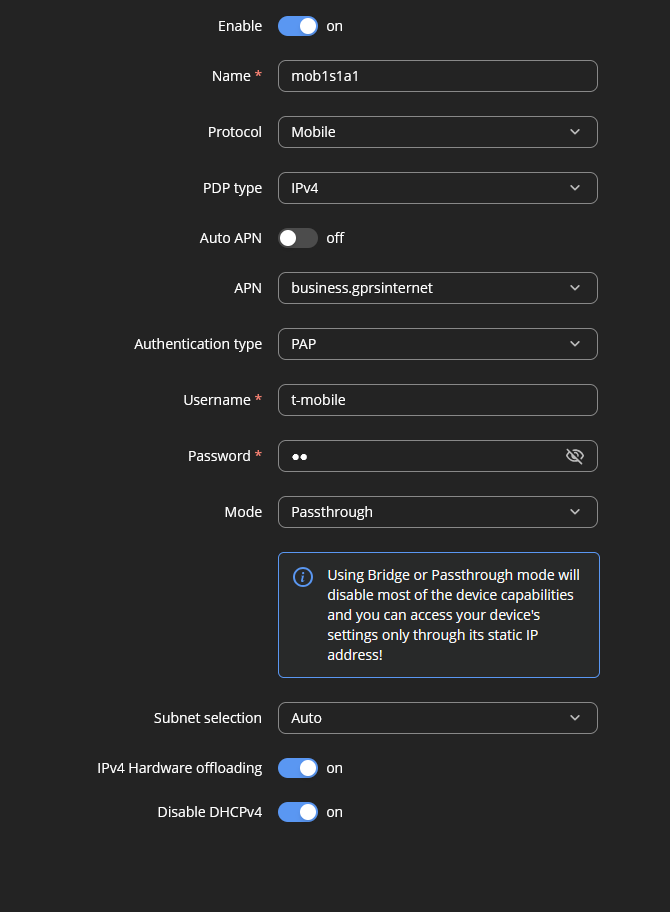

I took the time and made some screenshots and documented my findings. Attached first the config of my modem:
Data is not confidential and the standard setup for Magenta Business SIM in Austria (Magenta is our local T-Mobile Name). Here you can see the new toggle and Passthrough mode selected.

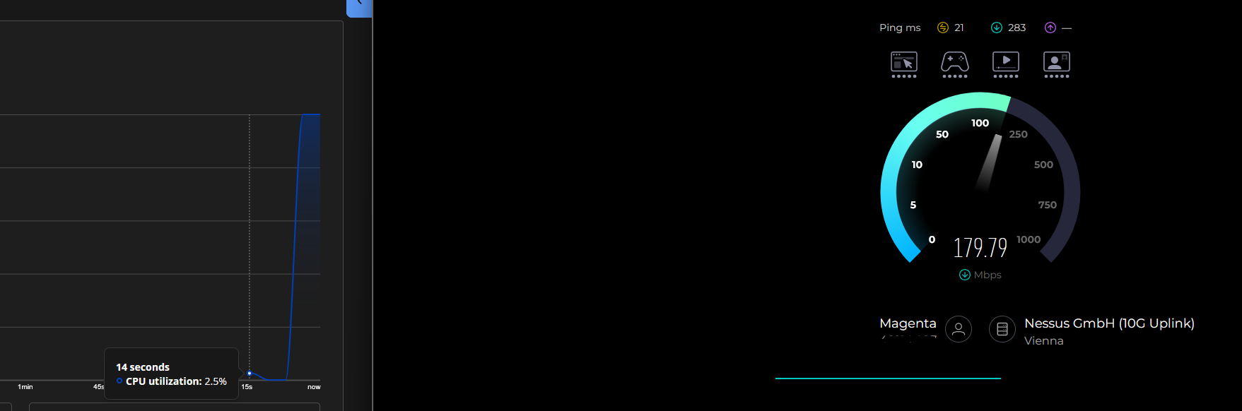

Next we have a speedtest to Nessus locally in Vienna. Settings are as in the first picture. You can clearly see that the CPU is pinned again at 100 percent and we get 180mbit constant. (just like mentioned in my first post). Just so i know that i am not going mad, i have an old iPhone 13 next to me with one of our Magenta SIM cards inserted, achieving 380/13 on the same APN. Upload is worse but maybe the iPhone is struggling there.

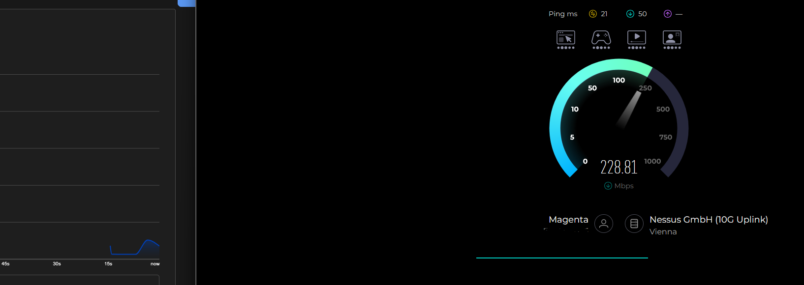

Next a speedtest with NAT mode, nothing else changed, same physical position, same APN, just a change in Mode. CPU is at a low 4-5 percent, speed is instantly at 220-230mbit down and especially look at the ping… 283 vs 50ms (idle ping is same, but as soon as we hit traffic it goes crazy. CPU bottlenecking for sure)

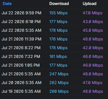

Also attached the Speedtest Log of our UniFi Setup. We have an automatic Speedtest at 5AM (to a server chosen by the UniFi System, but always the same) You can clearly see the speed before the update. (here we were running an old FW with NAT Mode, TRB500_R_00.07.19.4, because anything newer blocked our 5G reception) And instantly when i got your message on the forum on the 21st i decided to upgrade and check out the fix. (with some speedtest forced by me but also a speedtest at 5am)

@svgyda, could you please test this out with the option “Disable DHCPv4” turned off, keep in mind offload will apply on on the one device that has the wwan IP address.

We tried the option you mentioned already before, but when we turn “Disable DHCPv4” off we don’t get a working connection somehow.
Pinging from the CLI of the TRB500 works but our Firewall has no internet connection or possibility to ping anything on WAN side. The firewall gets the public IP assigned to its interface and that’s it. Not sure if the gateway address is being correctly assigned to the Firewall. It looks like it gets the 192.168.2.1 of the TRB500 as gateway address but also gets our public IP as the interface address. Maybe here lays the problem as it should get a gateway address assigned according to the upstream IP of our provider?

I now see that 00.07.24.1 is listed as stable … and then one would expect the feature “Mobile: added bridge hardware offload capabilities in passthrough mode” to work.
