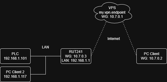

Could you please share a network topology diagram that includes IP addresses?
Additionally, please provide the updated WireGuard configuration, as this will help me better understand the current setup.

Network topology:
Wireguard Configurations:
