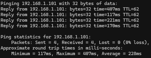

RUT241 Wireguard: WebUI/SSH but no LAN Access
Nailed it. That was exactly right - thank you @sthyr
The RUT241 is not a responder a fixed port isn’t necessary (and is error prone). Delete the option listen_port β€˜51820’ line entirely from the configuration.
An easyier way to delete the SNAT rule: iptables-save | grep -v SNAT | iptables-restore
