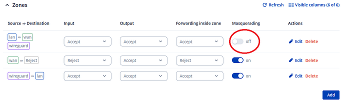

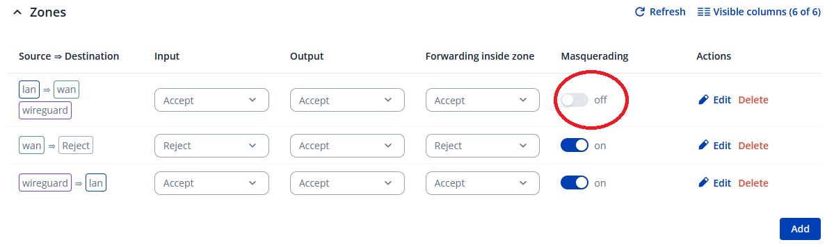

I turned on masquerading on the lan. That’s all.
The numeric value of my.vpn.endpoint is the public IP address of the Wireguard server (not 10.7.0.1).
So the ping is originating at the wireguard server public IP → RUT LAN IP (192.168.1.1) and back to the wireguard server public IP. The server SSH session is just never seeing the reply.
As in lan => wan + wireguard ? Can you confirm ?
In the echo requests from my.vpn.endpoint to 192.168.1.101 the source address appears to have a curious value. Why is another question.

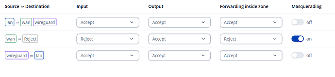

I just toggled this switch.
Disable masquerading for bothe lan=>wan+wireguard and wireguard=>lan, and retry the ping. What is the tcpdump output ?

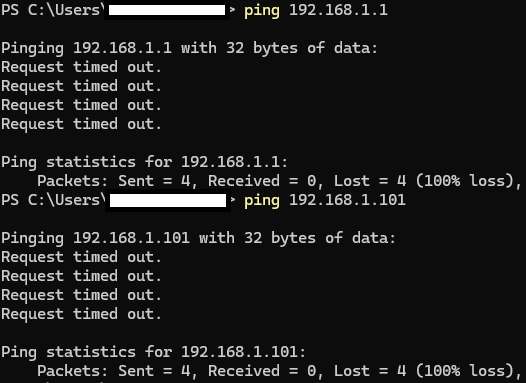

What is the result of this ping ?
Apologies - I thought I included the screenshot. All timed out. Still not working.
