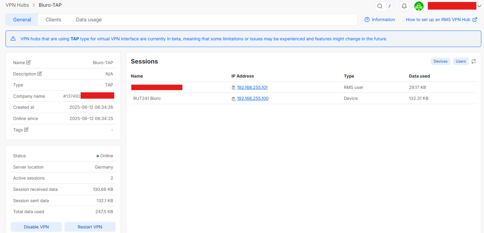

Hi Marija,
I’m currently testing TAP mode, which is available in RUT2M_R_00.07.15.

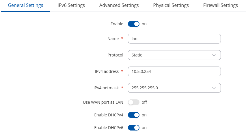

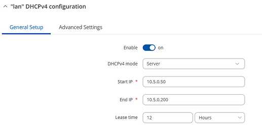

I have RUT241 with this LAN config:

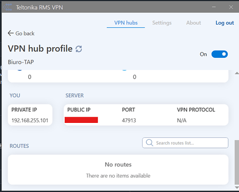

I created a new TAP mode VPN Hub, downloaded the latest Teltonika RMS VPN (0.9.0.8), and enabled VPN, but I got IP address out of range:
My idea is to create VPN connection that will give my PC (the machine running Teltonika RMS VPN) IP address in range that is configured on RUT241 router.
Can this be done with TAP mode?
Do I must add/change some settings on router?
