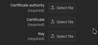

Today, I am trying to configure a RUTX08 via the RMS and set the machine up as an OpenVPN client. The key material (private key, certificate, ca certificate, crl) was uploaded manually since I already know that the RMS cannot do that.
But, alas, I cannot tell the RMS to use key material that is already on the router:
And when I click on “Select file”, a local file selection box opens on my client. I’d expect either a dropdown of the files that are already on the RUTX08, or a text field where I can enter the file name.

Currently, this functionality is not available in RMS.
As a workaround, you can use the CLI to specify the certificate paths for the OpenVPN configuration.
First, run the command:
uci show openvpn
This will display the OpenVPN instance ID. In the example shown in the image below, you can see where the instance ID appears.
Once you have the correct ID, use the following commands to set the file path for the certificates and keys:
uci set openvpn.<instance_id>.ca='/etc/certificates/ca.crt'
uci set openvpn.<instance_id>.key='/etc/certificates/client.key'
uci set openvpn.<instance_id>.cert='/etc/certificates/client.crt'
uci commit
Please let me know if this helps.
It does, quite well. Thank you.
