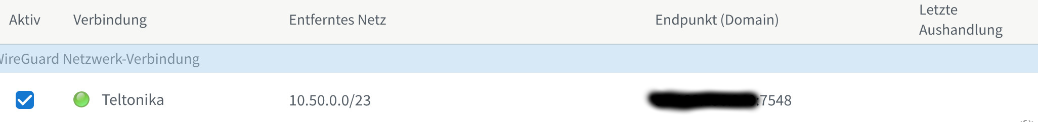

and have been able to get a “green light” in the Fritzbox:
but unfortunately no “last negotiation” timestamp, though Fritzbox logging does say:
