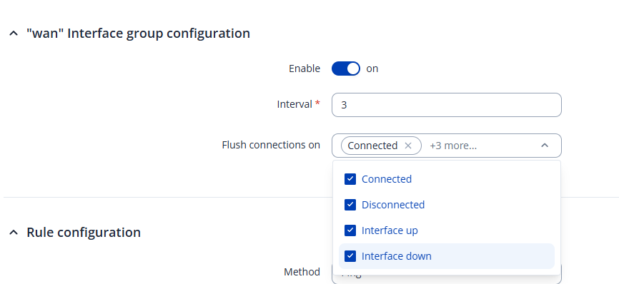

In addition, not sure if it is having any influence in a ‘wireguard’ scenario but in the failover settings at NETWORK > FAILOVER > MULTIWAN > INTERFACE ….. for each interface that can be potentially used in failover (e.g. wan, mob1s1a1, etc.), try setting the ‘flush connections’ as per below, if the previous suggestion doesn’t bear fruit.

And actually in my Wifi Interface there was no flush connections defined. I changed this as well. Now I need to check it this evening.

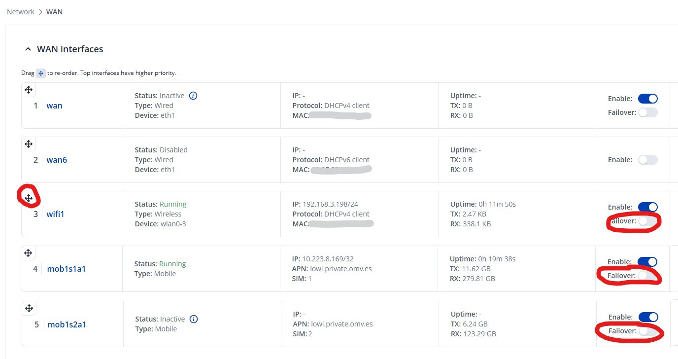

  1. remove any failover switches that are set to ‘enabled’ by going to NETWORK > WAN > WAN INTERFACES - Save & Apply.

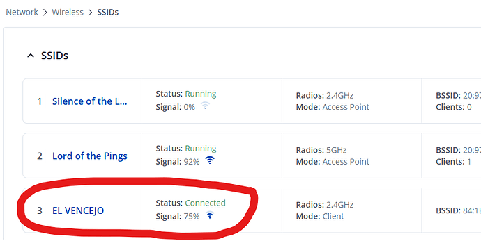

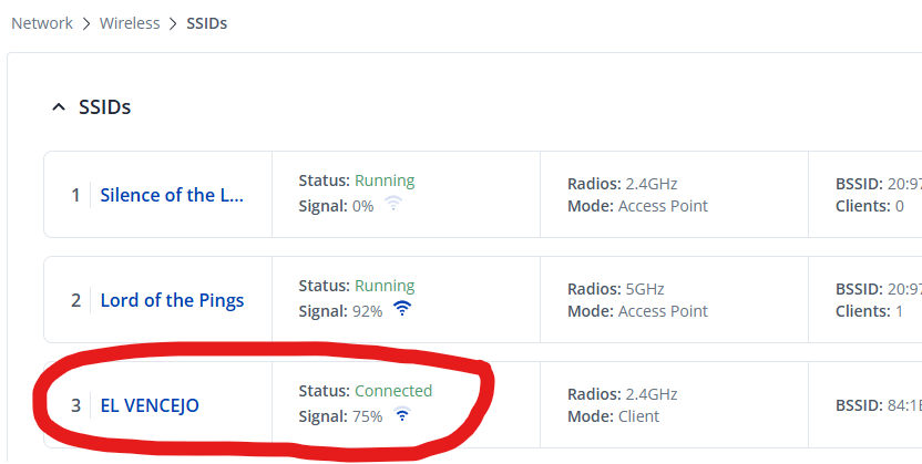

  3. on the same page NETWORK > WIRELESS > SSIDs, scan for the wifi SSID you want to setup as a Client. Join the network and on the next dialogue box for the wifi1 settings click on Save & Apply. You should now see the the Client SSID, in this example named El VENCEJO, is now connected
  1. now we prioritise the WAN Interfaces, so that your wifi1 interface has priority over your mobile interface. Go to NETWORK > WAN > WAN INTERFACES, grab the handle beside wifi1 and drag it to be above you mobile interface - Save & Apply
And it’s ready for testing with your wireguard tunnel. Should the WiFi uplink go out of range, it will switch to mobile and once WiFi is back in range, it should reconnect as it has a higher priority.

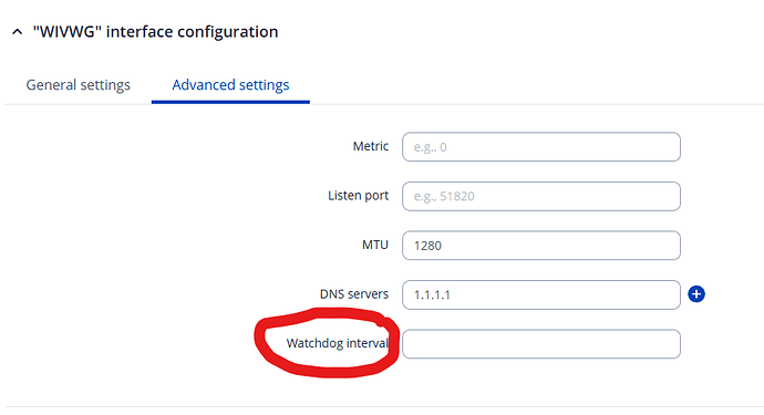

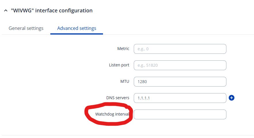

I checked the WireGuard settings again. With the reintegration of the watchdog in firmware 7.19.2, there was no default interval set in the advanced settings and you mentioned it would be then standard 60 sec. After adding the interval, it started working for me. Obviously if it is blank it doesn’t work.
Thanks for your help!
