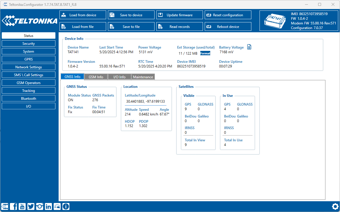

I suggest you check the RTC time in the status section when you connect the configurator.
You can send me a creenshot
BR
laith
The RTC time is correct. Screenshot is attached
