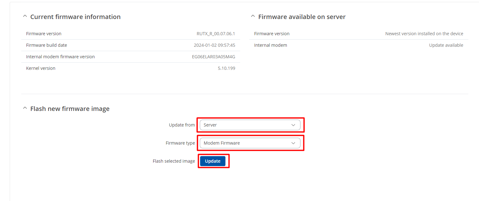

Kindly upgrade the Modem Firmware of the devices that are having issues with Verizon operator to ensure that fixes will be applied on the previously known issues to it.
Steps:
  1. Login to the WebUI of the device and navigate to SystemFirmwareUpdate Firmware.
  2. Choose the Update from Server option and make sure the firmware type is the Modem one.
Note: Make sure this will be done on a test environment and/or a test device so that it will not distrupt any of your active operation.
If the issue still persists, I recommend reaching out to your designated sales manager or reseller that you purchased the devices from, since this may require a deeper troubleshooting based on the issue you were having.
