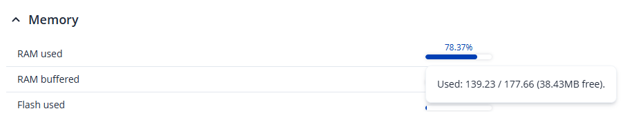

Problem/Question 3:
Why is the RAM capacity only listed as 177 MB? According to the specifications, the TRB501 has 512 MB of RAM. Furthermore, the occupancy rate is consistently around 80%. Is this normal behavior?

I have also low memory shown (177MB instead of 512MB) but no modem crashes.

But if the RAM ist really 177MB instead of 512MB I need a replacement anyway. What is the status in this fault?
