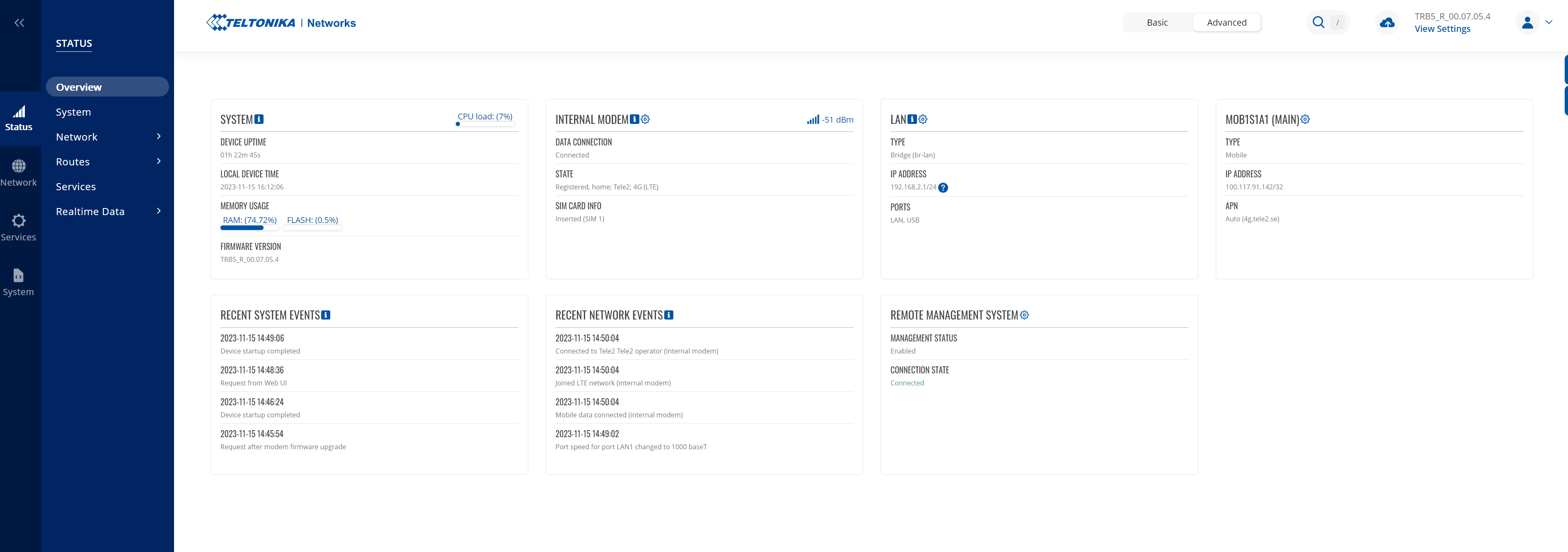

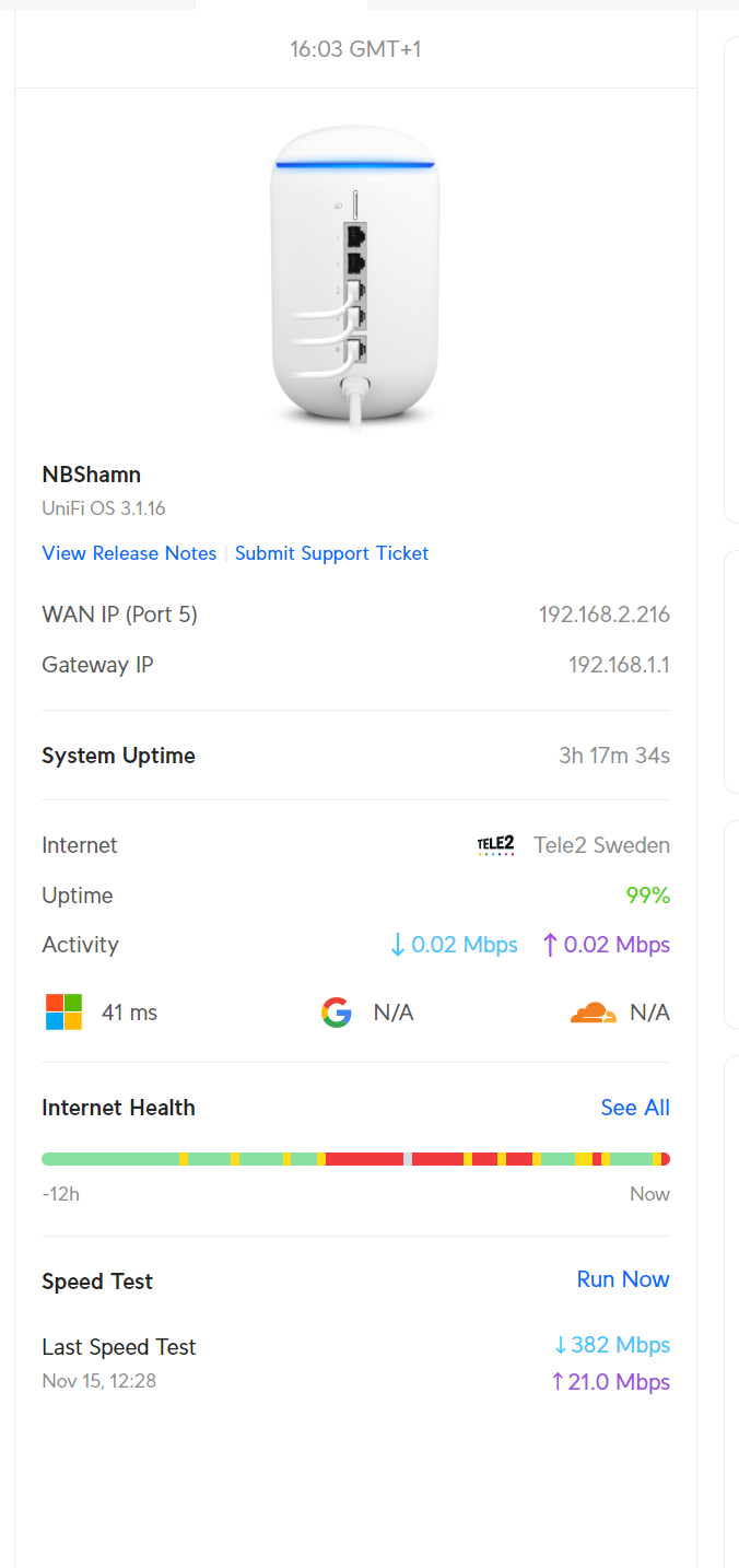

Hi again, now it went down, se attched files, I dont know how to get in the TRB files, but her is some pictures
If TRB500 is directly connected to another router, I’d suggest configuring the TRB500 in Passthrough or Bridge mode, just to avoid triple-NATing. This can be done by navigating to Network → WAN → edit mob1s1a1 interface, and change it from NAT to Passthrough mode. This will directly relay the mobile IP address to your router.
Without having access to more information it’s hard to troubleshoot the issue. Perhaps the speed drop only happens during certain times of the day?
