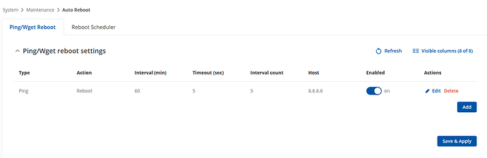

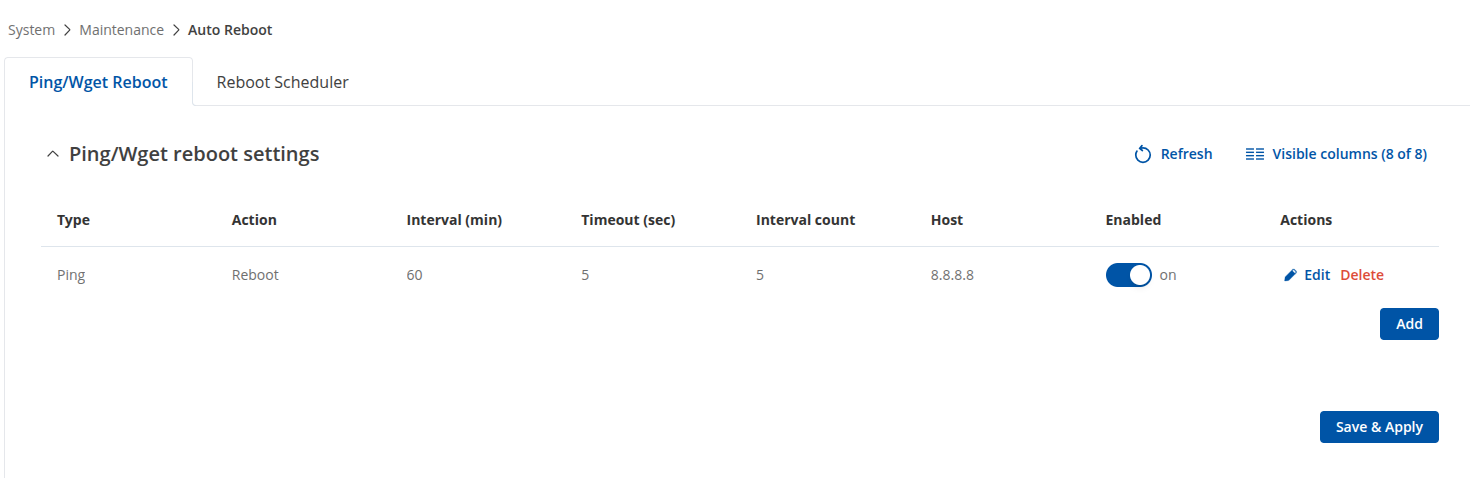

- Could you confirm whether Ping Reboot is not enabled under System → Maintenance → Auto Reboot?

Ping reboot was activated some weeks ago, but the logs config that this is not the issue. The modem is experiencing repeated “Unexpected reboots” more than once per day.

I would greatly appreciate if you could revise the troubleshoot and event logs that I recently downloaded.
The behaviour has not improved in the past month..
Alberto
Thank you for the update. As mentioned, to assist you effectively, we’ll need to continue this process privately. You should find a support request form in the inbox of the email address you used for your forum registration. Kindly fill out the form, and please reference Ticket ID: 13551 when submitting it. Once the form is completed, we’ll contact you directly via email to investigate the issue in detail and help work towards a solution.
