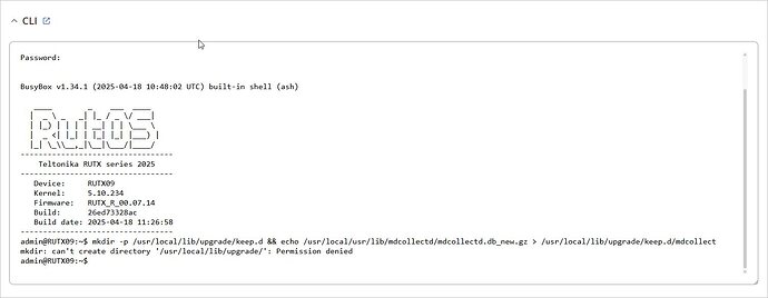

I’m not good on command line things, but I’ve logged in to the CLI, pasted the command provided and it says: mkdir: can’t create directory ‘/usr/local/lib/upgrade/’: Permission denied
What do I do?
Did you login to the CLI using …
User = root
Password = [insert password you use to login as admin]

No, I used my usual login name of admin and usual password. I’m guessing the root username is the key. I’ll give it a try. Thanks @Mike
Hi! I have the same problem. What to do?
Using your PassWord you have logged in using the UserName “admin”.
Try using your PassWord but instead use the UserName “root”.
Using the UserName “admin” gives you admin level access to the system, using the UserName “root” gives you an elevated or a higher level of access, a much more powerful level of access to the system.
Careful though, “root” access to the system gives you much more power to do stuff but used incorrectly or make mistakes and you can also do a lot of damage too!!
Hi! Thanks. I used “root” and it solved the problem
It was necessary to log in directly to the command line interface (I use the PuTTY) as the ROOT user; using ADMIN and SU was not sufficient. Once logged in as ROOT, the command executed without issues, and the subsequent firmware upgrade from version 14 to 14.2 completed within the standard timeframe of until 5 minutes.
