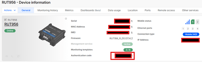

Hello Arturas,
There are no errors or exclamation marks in Device Status. Status in RMS in RMS is grey and clicking produces “Not Activated”
Connection log for this unit has repeated events of “The device is redirected to the authentication system.” with Status codes of 20 and 0.
The firmware requires an authentication code but RMS never provides the authentication code.
7.14.2 firmware is faulty. I confirmed by this downgrading to 7.07.3 and RMS connected no problem. Went back to 7.14.2 and unable to connect to RMS again.
Does Teltonika test firmware before releasing? This is second faulty firmware I have located which has cost me a lot of time and frustration.
