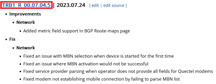

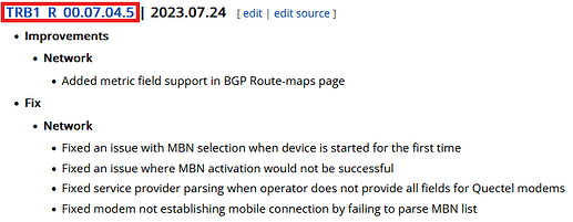

Hello.
I have tried this, but i am getting this error.
I can downgrade like this
TRB1_R 00.07.06.4_WEBUI
TRB1_R 00.07.06.2_WEBUI
TRB1_R 00.07.05.4_WEBUI
TRB1_R 00.07.05_WEBUI
but not down to
TRB1_R 00.07.04.5_WEBUI
Regards
Jan.
If your device was made after November 2023, the latest firmware version that can be downgraded is 07.05. You can find more information about this on the following page: TRB142 Product Change Notifications.
Marijus
Hi.
Thank you.
Then that is the problem, it is the new devices.
Then we are stuck until you will find a solution to the problem.
if you need any further information, feel free to contact me.
Regards
Jan.
