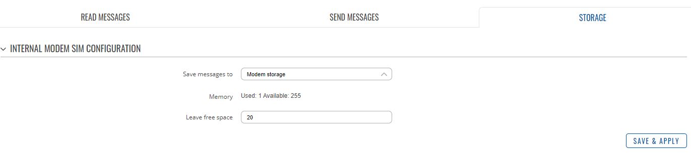

Could you clarify whether SMS messages are being stored in the flash memory or the SIM itself?

The storage is set to Modem storage, I assume that it is the flash storage.

And with the storage setup like this
The messages are not stored.
The logread shows the SMS removing from the memory after the action is done.
