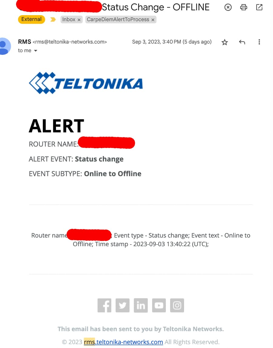

The RMS platform sends unwarranted EVENT SUBTYPE: Online to Offline
I use RMS to get me warnings when my RUTX11 goes offline. But this happens a few times per month while the device is still up. It shows no downtime.
Is this a problem in the RMS platform?
How can I check on my RUTX11 what the real cause is for RMS to report my device as offline? By boat is stationary at the moment, good cell reception.
Thanks, Simon

The message I get from RMS:
