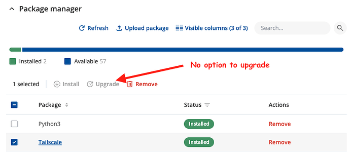

No new update is available in Package Manager.
Image from Package Manager

Just a quick PSA: be careful when updating Tailscale arbitrarily as it can break. I suggest sticking with the version available with whatever package manager bundles for your firmware build. In the 7.17.x track, you can get up to 1.86.2 which is fairly recent.
See RutOS firmware 7.17.x + Tailscale (any post-1.70 version) = broken for more…
Hello @andrewfromlondontown,
I’d like to inform you that performing manual updates to the service can lead to various errors.
We officially declare which Tailscale version is supported by RutOS and ensure that it is fully integrated into the RutOS ecosystem. Manual updates break this integration and may cause the service to stop working.
When you update your device’s RutOS firmware, it will automatically include the latest Tailscale version supported by RutOS. Support for newer Tailscale versions will be added in the future.
