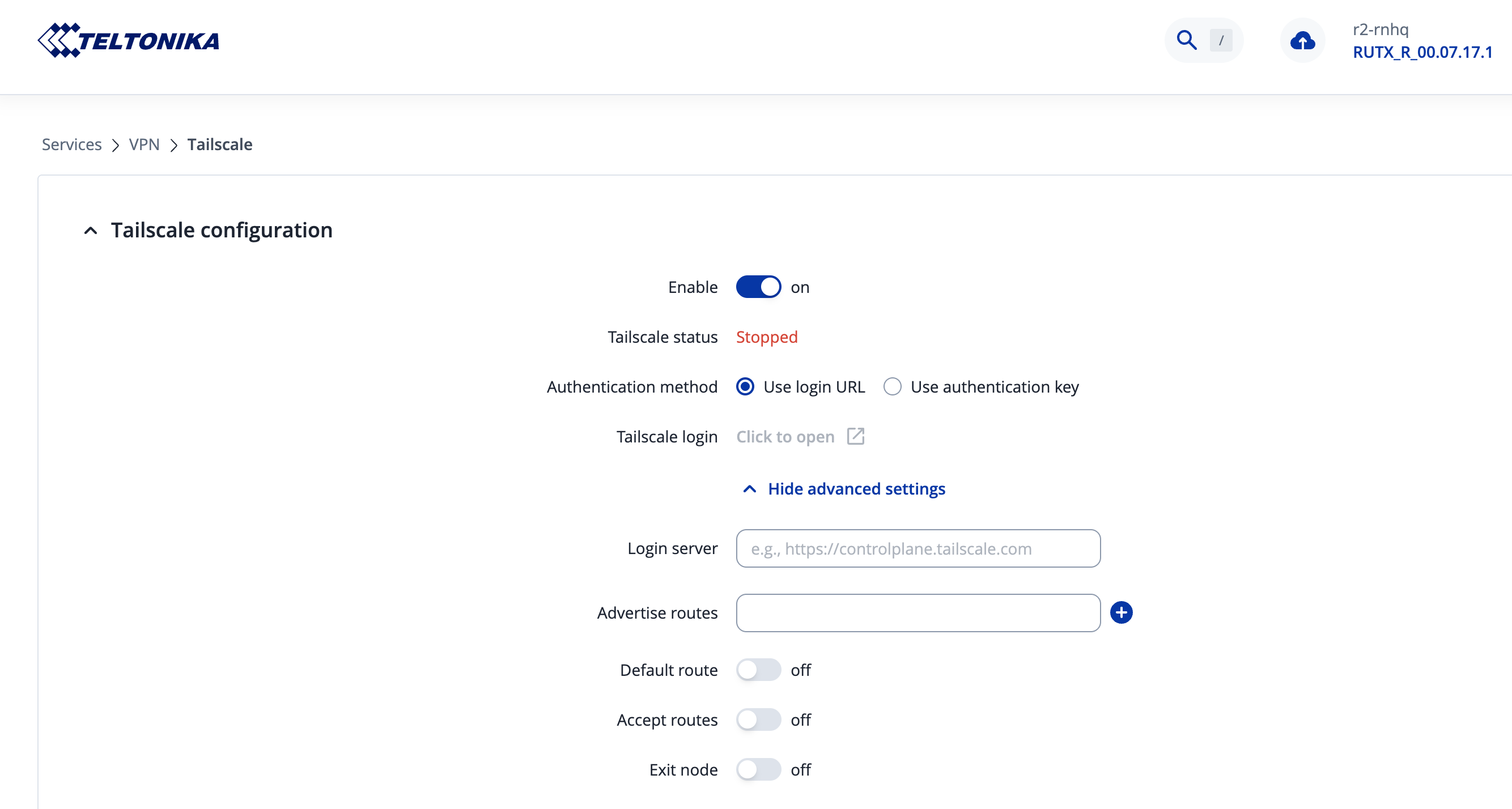

When the device first boots, tailscaled is not started, and so the /var/run/tailscale/tailscaled.sock socket is not active:
root@r2-rnhq:~# tailscale status
failed to connect to local tailscaled; it doesn't appear to be running
From CLI, it can be run manually just by typing tailscaled after which, login and connectivity work, but the GUI still says “stopped”
