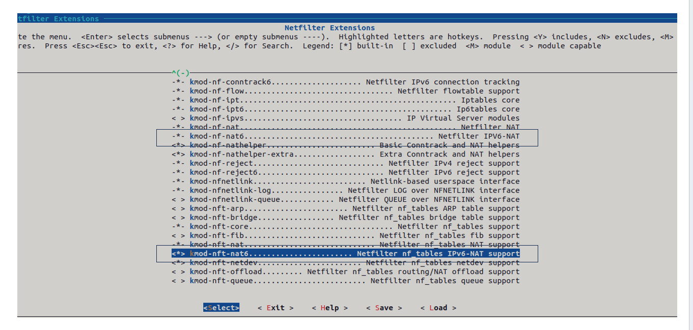

Hi, as discussed in the Does RUT955 support IPV6 NAT - Networking Solutions - Teltonika Community we want to share the following SDK settings:
which we used to enable NAT66 for ipv6.
We would be happy, if the NAT66 feature can be entered into the mainline firmware for the RUT9x devices.
Thank you and best regards, Matthias
