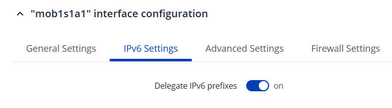

NAT66 is not supported on our devices. The recommended approach is to use IPv6 Prefix Delegation, which allows the router to receive a larger IPv6 prefix from the mobile operator and assign subnets to the LAN.
You can enable this by navigating to Network → WAN, clicking Edit on the desired interface, and enabling the option under IPv6 settings.
Please ensure that your mobile operator provides a delegated prefix, not just a single /64 for the WAN interface. A larger prefix (for example, /56) is required so the router can delegate a /64 to the LAN network.

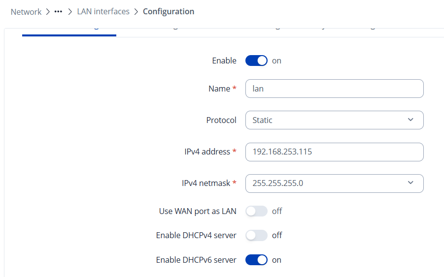

Additionally, make sure the DHCPv6 server is enabled on the LAN interface.
