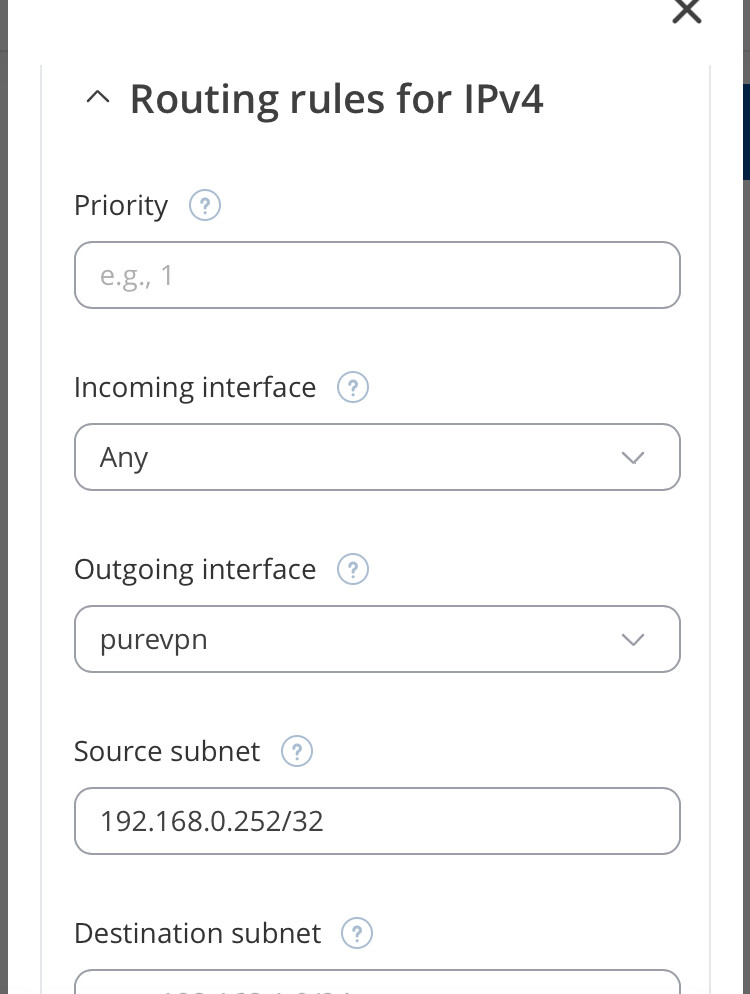

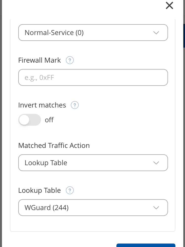

I have them set the rule as

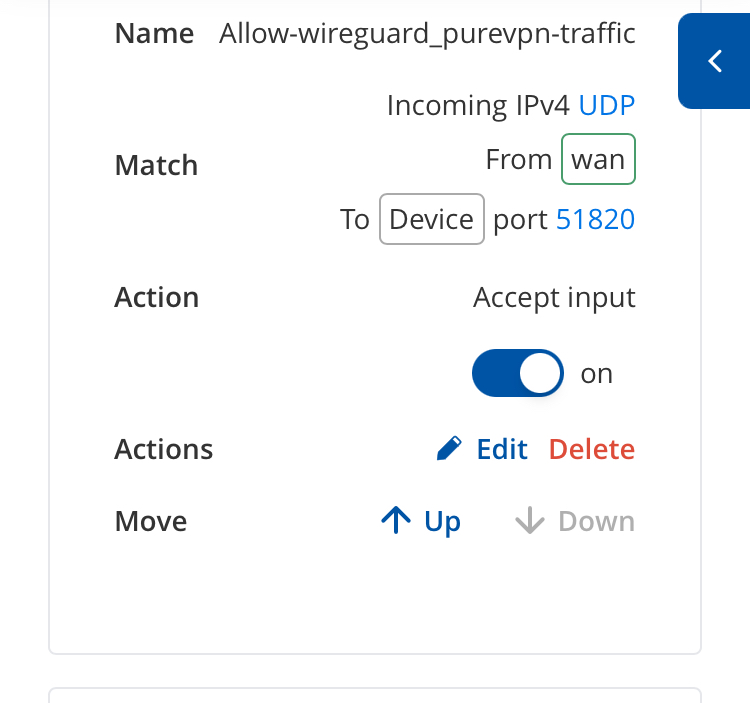

I have checked the traffic rule

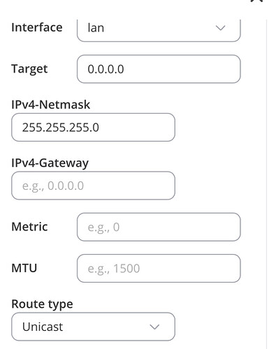

If the assistance is still needed, your setup (routing only specific IPs via the VPN tunnel while keeping all other traffic through the ISP mobile interface) should be achievable using a policy-based routing rule combined with a few WG client’s adjustments, as described in a similar topic here:

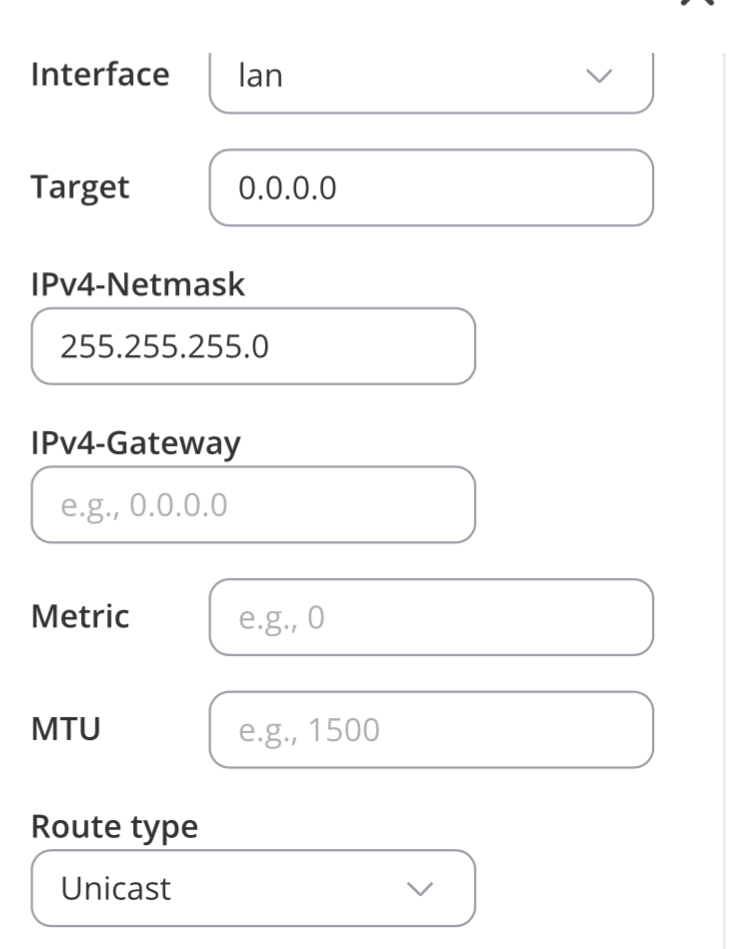

From what you’ve shared, it seems that in your first screenshot, the IPv4 gateway in the routing table’s static IPv4 routes configuration is not specified, which should be your VPN server’s IP address.

  • In Network → Routing → Policy Based Routing, create a rule where:
    • Incoming interface = lan;
    • Source IP = 192.168.0.252/32 and 192.168.0.253/32;
    • Lookup table = 244.
  • And in your custom routing table, the static route via the WG interface using your VPN server’s IP as the gateway is configured correctly.
