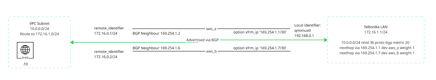

Thanks for the response - yes no problem, here’s a rough diagram of our configuration:
I followed the AWS article which was really useful, our only difference is that we ended up having to use route-based IPSec.
End to end connectivity is working fine between clients connected to the Teltonika LAN (172.16.1.0/24) and the VPC subnet (10.0.0.0/24). We want to configure the router itself to be able to resolve DNS queries, however it can’t reach the DNS server in the 10.0.0.0/8 network.
I think the reason is that traffic is being sourced from the link-local IPsec Tunnel Inside IP address (169.254.x.x).
The target VPC has a route for the Teltonika LAN, so we are looking a way to force all traffic destined for hosts on BGP-learned routes to use the Teltonika LAN interface IP (172.16.1.1).
Hope that helps explain the situation a bit better!
