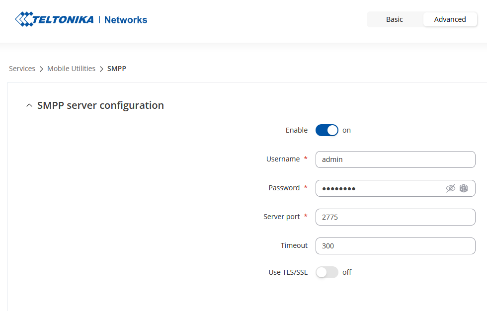

thank you for your answer but settings is correct:

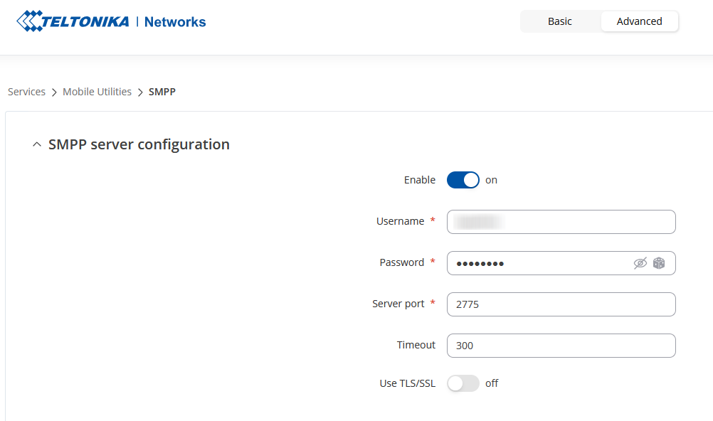

SMPP settings:

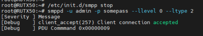

Alternatively, you can run the service from CLI with debug:

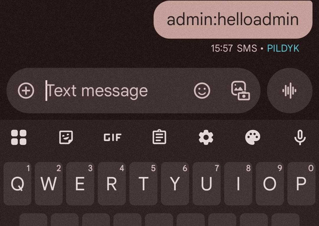

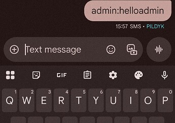

However, there is a nuance that the SMS message sent to the router must have a specific format (so the SMPP service knows where to forward the SMS): <id>:<message>
Screenshot for reference:
smppsend1.py received SMS:
So not all SMS messages are forwarded back (ID needs to be specified). If you want to read all the received SMS messages, then RUTOS API (/messages/status endpoint) would be a better option:
