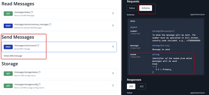

Than I need to call Send Message Api call, and pass the parameters. Including security token. How do I do that? What would be example?
Using Curl I managed to get authenticated and get session and token. Then I tried to send SMS.
curl -X POST “https://10.179.246.116/api/messages/actions/send” -H “Content-Type: application/json” -H “Authorization: Bearer 6ee154f4b42a41839d20a4ded7d8c8e8” -d ‘{“data”:{“number”:“0038599xxxxxxx”,“message”:“Test API”,“modem”:“1-1.4”}}’ -k
I kinda figured this is how it should work, by logic. Sec token is copied from authentication few seconds before that. And it did not show error, but I did not receive a message.
And now I have a problem. Api shows only parameters for Send.
How do I send session token with it? Did I do it right?
What is a modem parameter? Modem name, modem ID, what? I found this 1-1.4 somewhere on the Internet. Is that right?
How do I know what modem to use? We have two sim card slots, so I guess it is more than one destination, what is syntax to choose modem? I use only one SIM at the time, in Slot1
Also, what should be user rights for a user to send SMS?

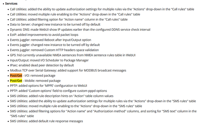

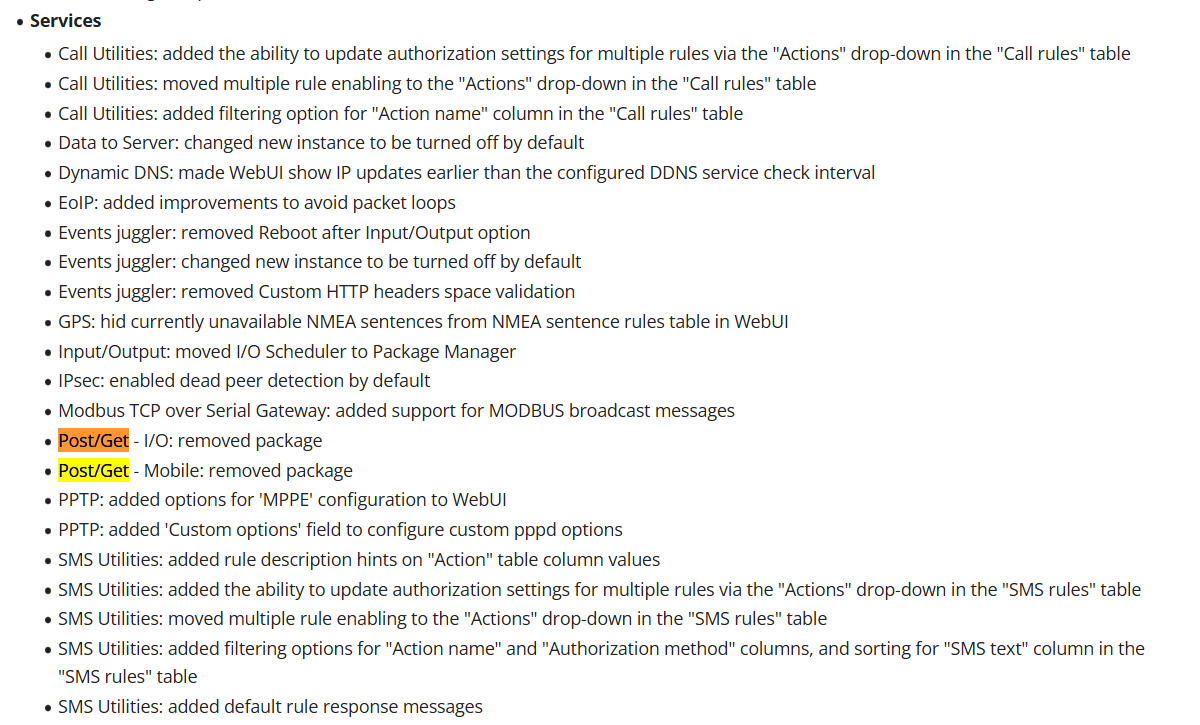

These changes have been announced within the forums first, found here: Implementation of Read-Only System Files and Mobile and I/O POST/GET Service Removal with RutOS 7.14
Then in the Product change notifications: RUT956 Product Change Notifications - Teltonika Networks Wiki
Then in the changelogs of the firmware (any device): RUT956 Firmware Downloads - Teltonika Networks Wiki

As for showing changelogs, it is even worse. First, it is written in deliberately obscure language to conceal your intentions. It is listed as “Improvements” in a list a meter long, with a name that is deliberately vague “Post/Get - Mobile: removed package”. Instead of BIG RED line in first line of release note “WARNING: Customers that use HTTP Mobile send API to send SMS messages make note that functionality is REMOVED in this FW and will not be supported anymore. etc.etc…”.
Also, I didn’t download 7.14. I downloaded last stable one at the time 7.16.3. I went few releases back to see if there are blaring problems stated in release notes… If you take the release notes and paste them in Word, the vague and, frankly, hidden sentence mentioning “removed package” is 16 pages down from FW I downloaded. And I did actually go a browse thorugh it. But FW 7.14 was marked “ Removed.” Good practice is to keep all the release notes from removed vesion propagating to next one that is recomended. Why? Because by removing it because of error, you create new version that replaces it. One removed was never, in fact released, so all notes to it are both irrelevant and invalidated. And fixed version is the one that makes the changes not one that does not exist.
And finally, from change notification web page:

It’s definitely possible to achieve this with Zabbix and our API. If you’re not comfortable writing the webhook script yourself, you can use a tool like ChatGPT to help generate the code - just provide the following details:
  • Your Teltonika router model and firmware version
  • The Zabbix variables you want to include
  • Examples from our API documentation
The general logic of the webhook would be:
  1. Authenticate with the router by sending a POST request to obtain a temporary session token. Example:
    Login API example
    (This example may need to be adapted to JavaScript for use in Zabbix.)
  2. Send the SMS using the authenticated token with a second POST request to the /messages/actions/send endpoint.
    Full reference:
    Send SMS API endpoint
The modem ID and other required parameters can be found in the same documentation - just make sure to select the correct device model and firmware version on the page:
