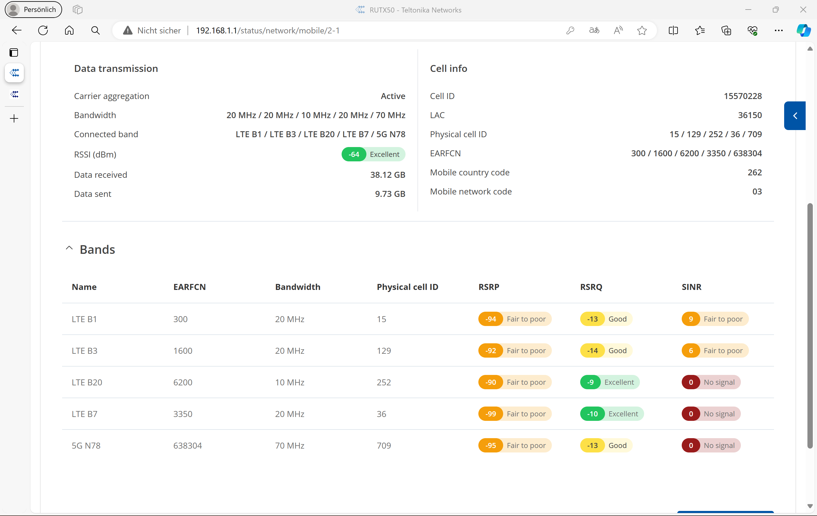

Can you go to Staus - Network - Mobile and post a screenshot of your “Bands” graphics on the bottom of the page?
This will help to see what’s going on with your mobile bands…

I’m no expert but for me the RSRP values are poor, the RSRQ values are not great but better and the SINR values are terrible.

The antennas that come with the RUTX50 have a gain of 4 dBi which is weak, while my Samsung A22 5G with built-in antennas measures a stronger signal because its built-in antennas have a stronger gain
Since you stated that it is a vehicle, it is strongly recommended that you buy a roof antenna with the highest possible gain, at least 10 dBi
You can try placing the RUTX50 on the roof of your vehicle for a test to see if it measures a better signal.
