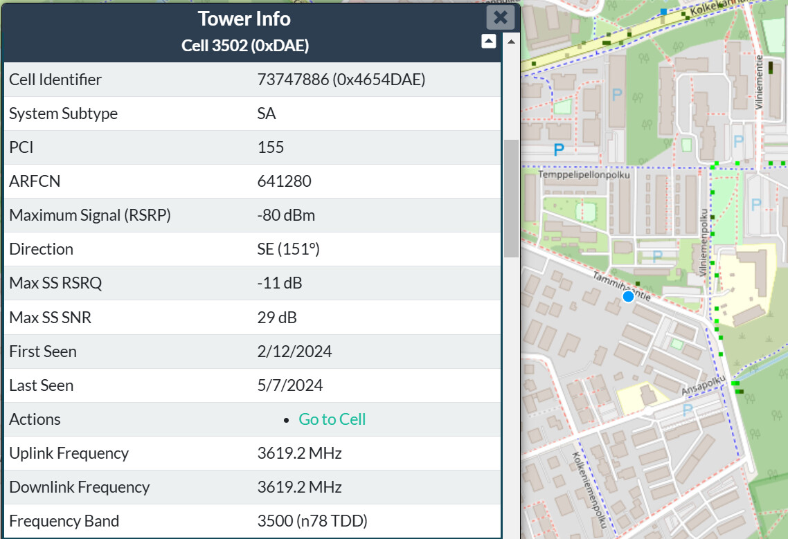

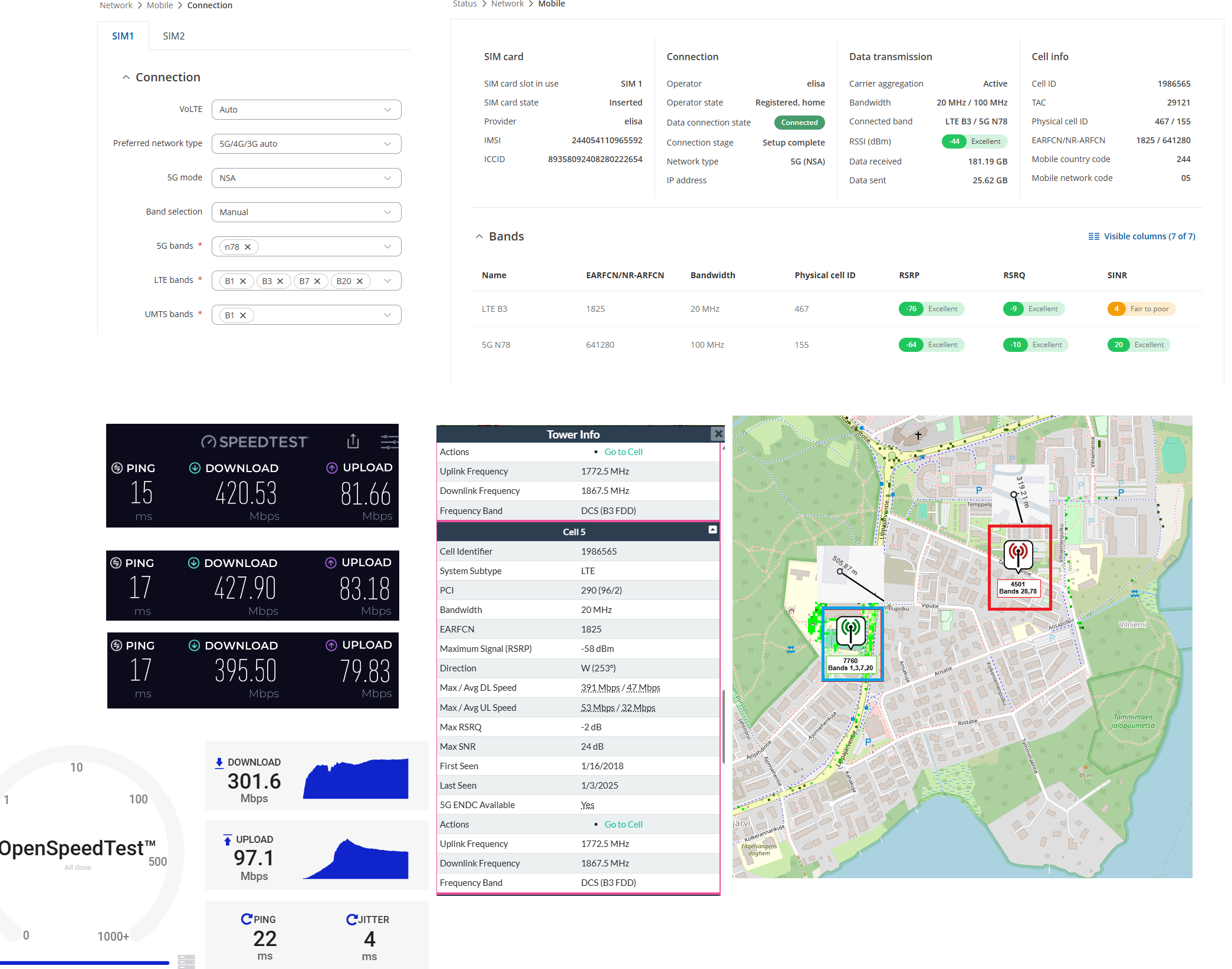

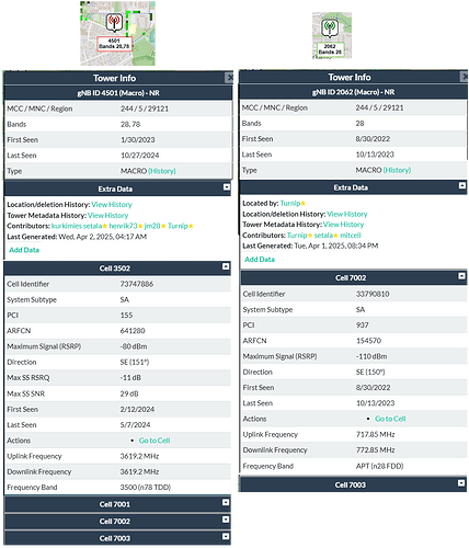

So the question, the rep mentioned this what I assume is a relatively new 5G tower in the area, or at least the closest one to me. On cellmapper which he told me to check, its “4501” and “Show Hex Values” sets it at 1195 - I don’t fully understand the difference.

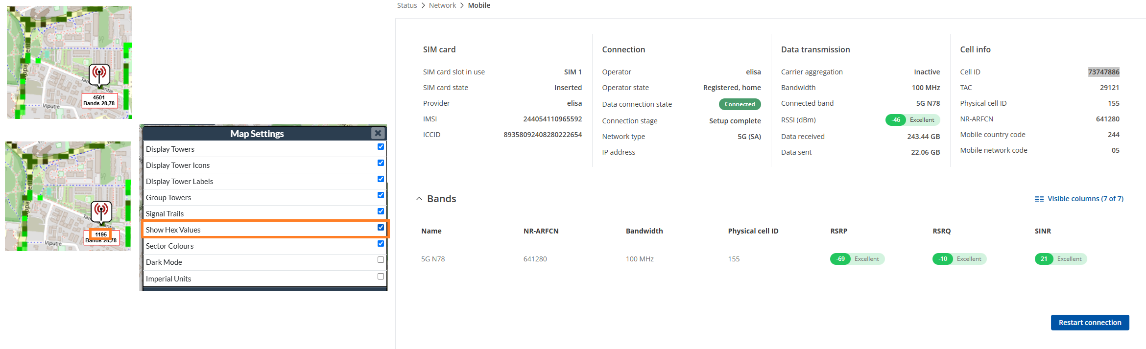

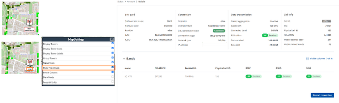

I am not able to determine which 5G tower I am currently connected to and this “4501” can I in some way select that as a tower to lock to?
Hi @davyjones,
The number provided by the Elisa rep represents the tower ID of the carrier. It means basically nothing to the router. To determine if you’re connected to the correct cell (on this particular tower) you need to press on the cell in cellmapper and check it’s Cell Identifier. In your case, n78 band has ID of 73747886 - exactly the same as the cell you’re connected to:
Additionally, your signal parameters are very good for such a wide band, so I’m certain it’s the correct cell.
As for the speed test - could you clarify if this test was performed after switching to 600/50 plan? Could it be that it takes some time for the change to take effect?

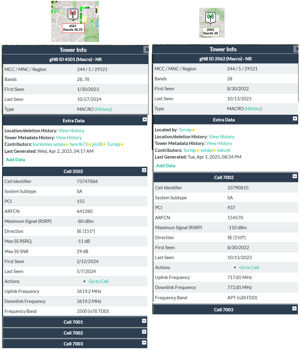

Thanks @Daumantas sorry stupid me did not notice the even very obvious scrollbar so I did not see the additional info. And indeed it does appear to be the same tower.
Do you now what the addtional panels in the same column of info indicate, are they different nodes on the same cell tower or something since the physical cell IDs are not the same.
And sorry, no the the plan switch to 600/50 has not occurred yet, the guy said to reboot the router sometime tomorrow evening.
Each cell tower usually contains multiple physical cells. The most common cell arrangement is 3 cells, each covering 120° of area, and combining to cover the entire 360° around it. That’s what you see with band n28 in your cell tower as well - 3 different n28 cells, each pointing to a different direction.
As for why there is only one n78 cell - I’m not too sure. It could be a matter of network planning, or simply cost saving (or maybe the remaining n78 cells are not mapped?), but your carrier likely had a good reason to design it this way. If you were to lock onto n28 band on the router, it would likely connect to the n28 cell that is pointing towards your general direction. From what I’ve seen - cells on the same tower also share the PCI.
As for the remaining parameters - a lot of them are specific to the devices that mapped them on cellmapper, and the main useful parameters are PCI, ARFCN, band, and of course, cell identifier. They can help you “map” the cell to the parameters you can find in the Mobile status page on the router.

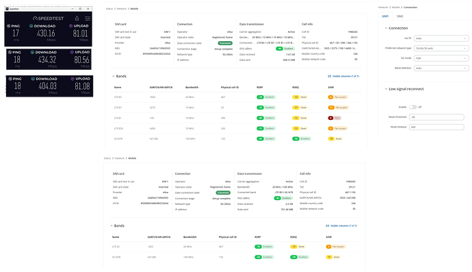

@Daumantas very, very useful info, many thanks! Actually I have had the device connect to N28 when I added it in Network > Mobile > Connection > 5G bands*. I added it there as cellmapper had shown it also being available and when connected to it over SA the speeds were not as good so I removed it.
I will try the N28 again later just to see if it’s the same tower. I guess it would be. And I will report the 600/50 speeds on e.g. N78 tomorrow as well. Is the RutOS System> Maintenance > Speed Test preferable since it’s native to the device?
It’s better to use a LAN device for speed testing, as when the speed test is ran on the router itself it consumes quite a bit of the router CPU resources, thus reducing the speed. But it’s worth trying both. Since your signal is very good, I don’t anticipate any issues.

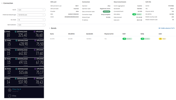

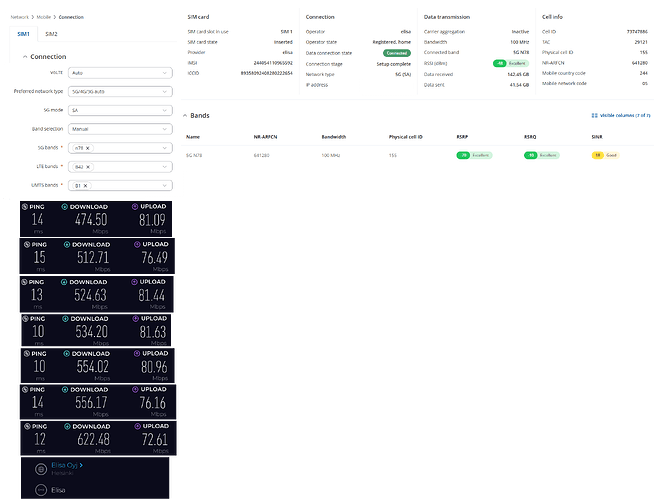

@Daumantas The connection now seems to have switched to the 600/50 selected yesterday. The overall performance is not any better or at least from a first test of it.
Could you try a few different speed test servers? Latency seems to be quite high for n78 and standalone 5G

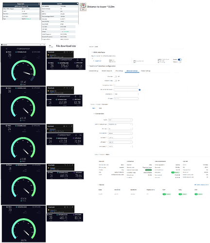

@Daumantas thanks, I did some tests using 3 services I’ve been trying out.

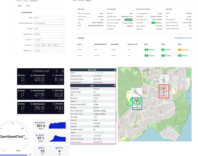

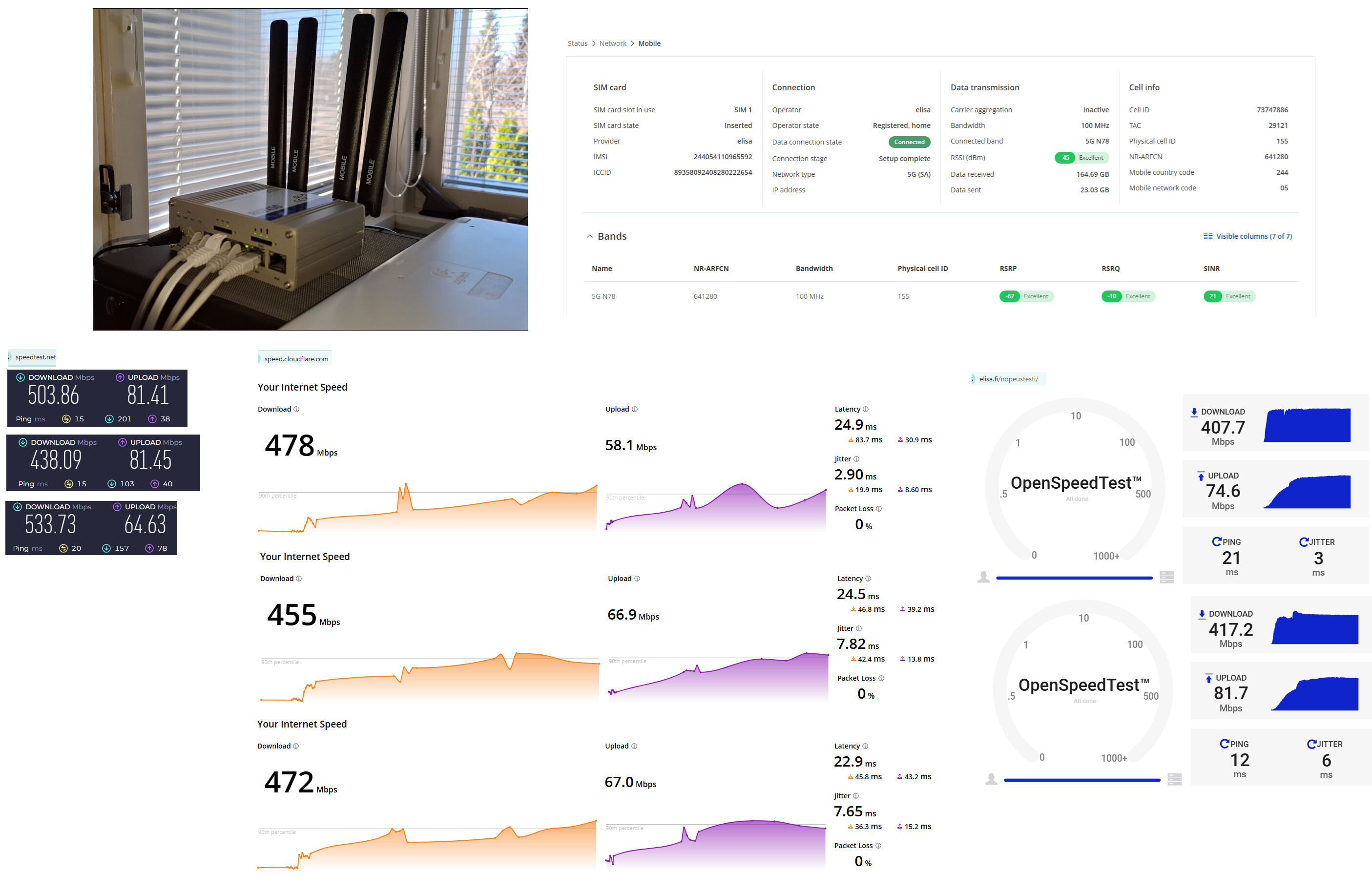

@davyjones for testing purposes, would it be possible to test the router by bringing it outdoors? I have a suspicion that this is not a signal issue, but it’s worth a try.
Also, could you try performing the same test on your phone? The phone likely has support for 5G CA, so I expect the speeds to be a bit higher, but I’m wondering if this could be an issue with congestion on this tower

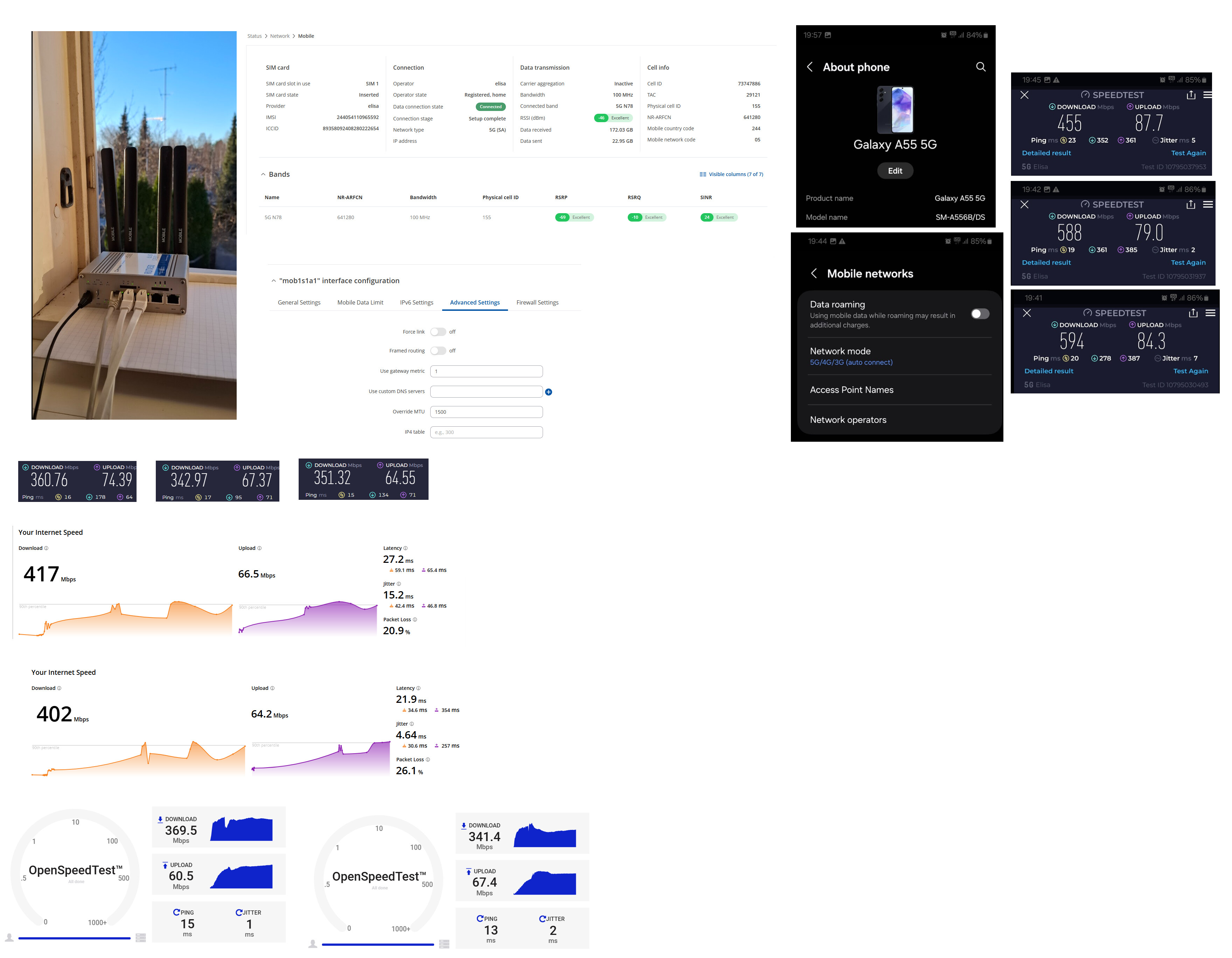

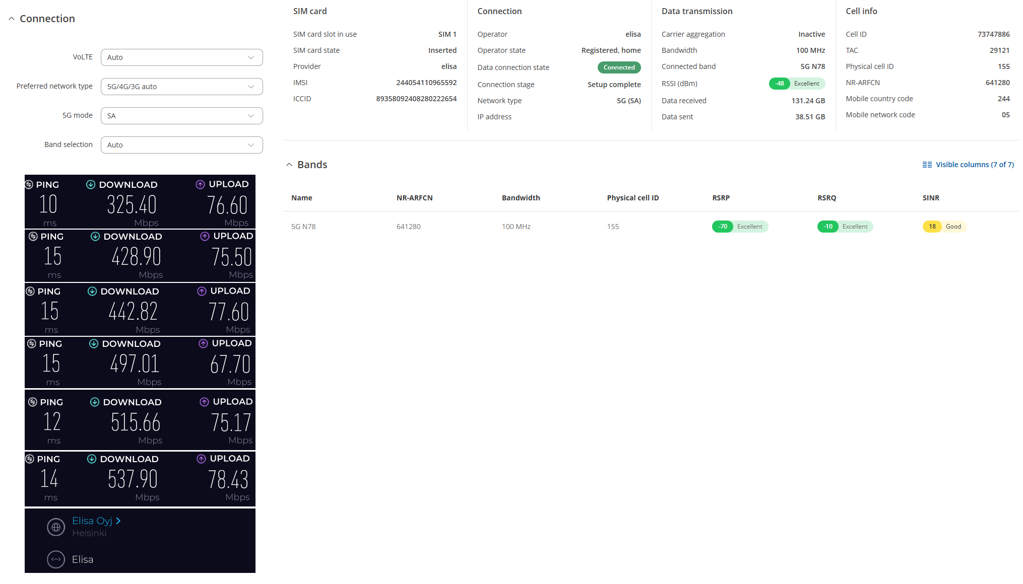

Okay so RUTX50 in open window.

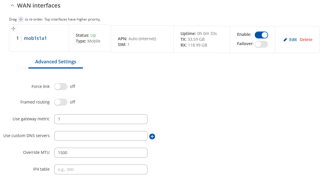

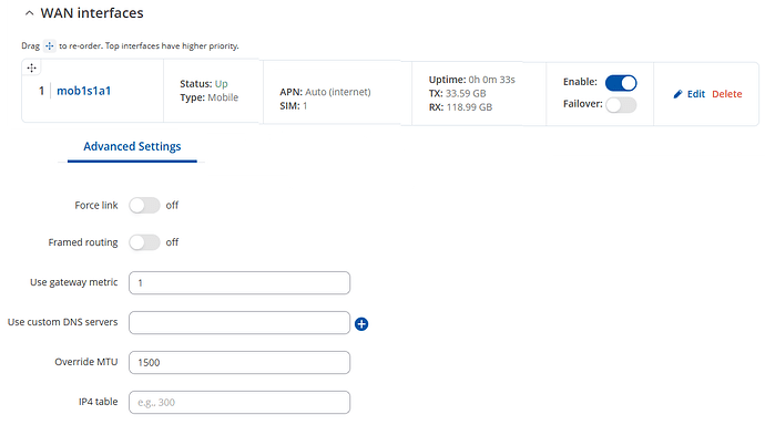

Note I have MTU value also set on the WAN interface so I don’t know if that makes a difference or if using e.g. the speedtest desktop app might also show different data.
Then Elisa SIM from from RUTX50 in Samsung GALAXY A55 5G held in open window

It’s suprising to see such variations in the speed on the router. I presume the latest tests were done during evening when the load on the cell tower is much greater, and that could explain it.
As for MTU - 1500 should be fine unless you’re experiencing issues browsing the web.
Is the window you tested from oriented toward the cell tower?

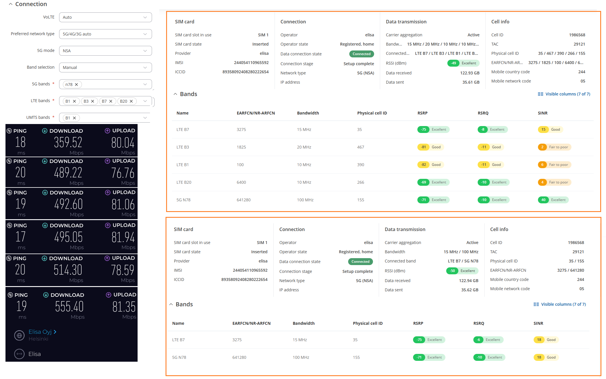

Just for reference - could you try configuring 5G NSA and check the difference? Make sure to only leave n78 for 5G (no n28).
Hi @Daumantas yeps evening time. The new 600/50 was supposed to offer greater priority though…

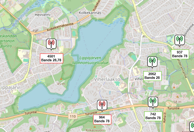

And yes direct line of sight to the towers and the home is on higher ground. In red the 5G SA N78 tower (~300 m) and and in blue what I assume is the 4G LTE one (~500 m) but it’s not PCI 467, unless I have the wrong one. And the rest of the info is based on this 7760 5G NSA connection on LTE B3.

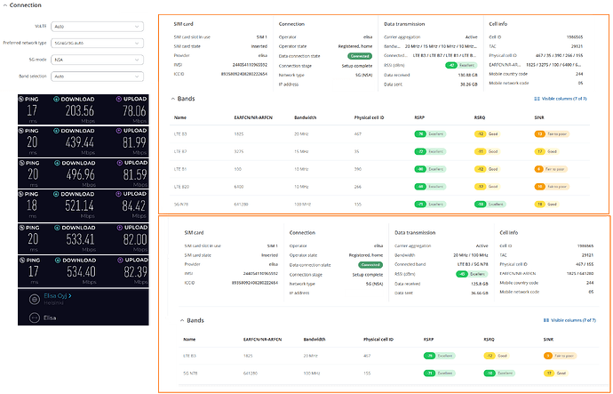

When it’s on auto for 5G NSA the status seems to bounce between 2 and 5 frequencies.
The I tried 5G NSA without the custom script, as I wasn’t rebooting and just used your LTE B42 and 3G B1 (since there’s no 3G) suggestion and the speedtest desktop x64 client, performance seems better than browser. I’ve never seen a 9 ms ping before so that was interesting.

I am 300-500 meters from the node the Elisa rep said they would lock the Huawei external router to.

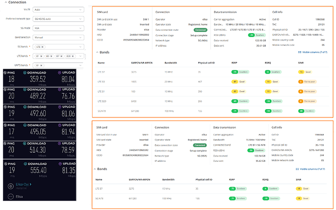

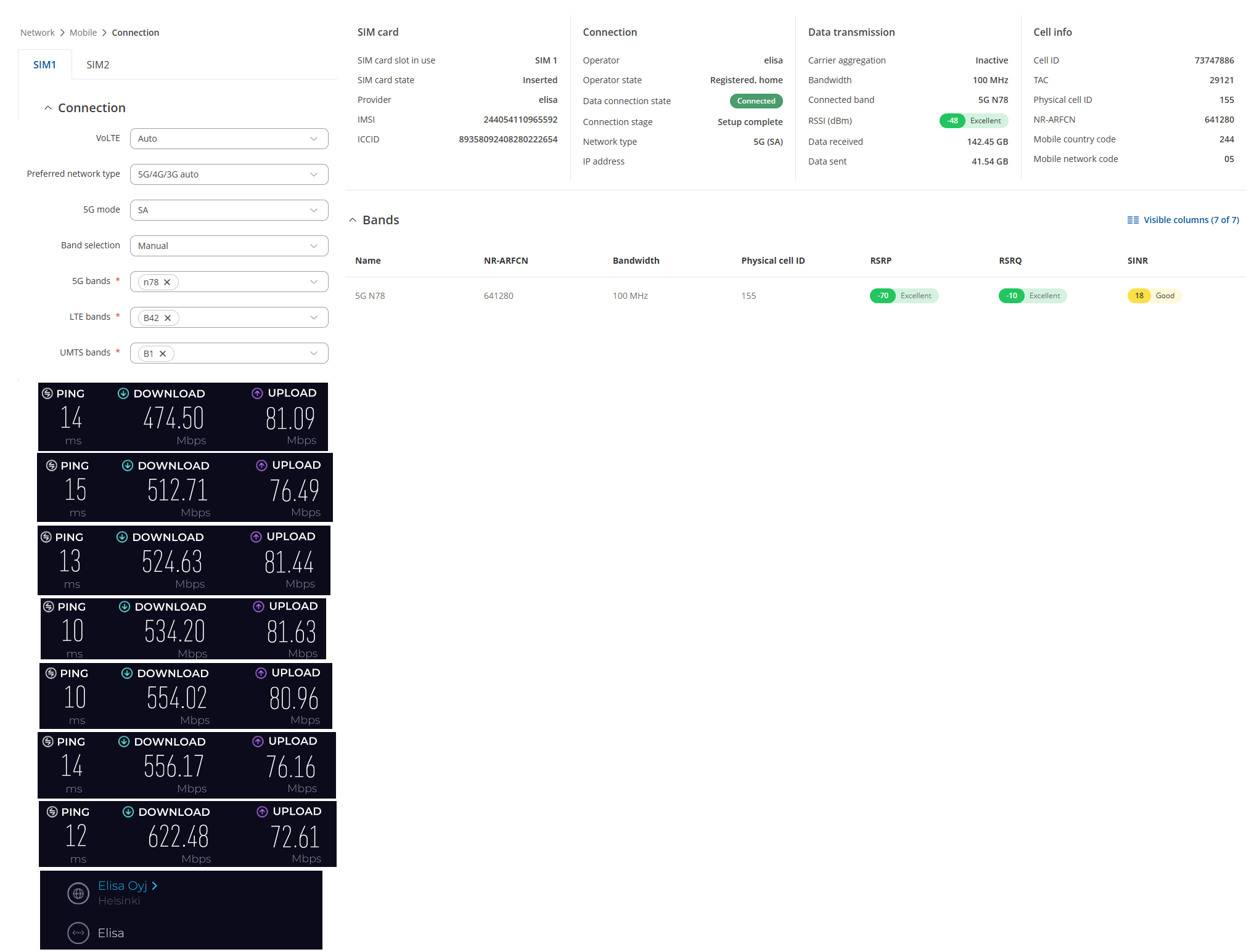

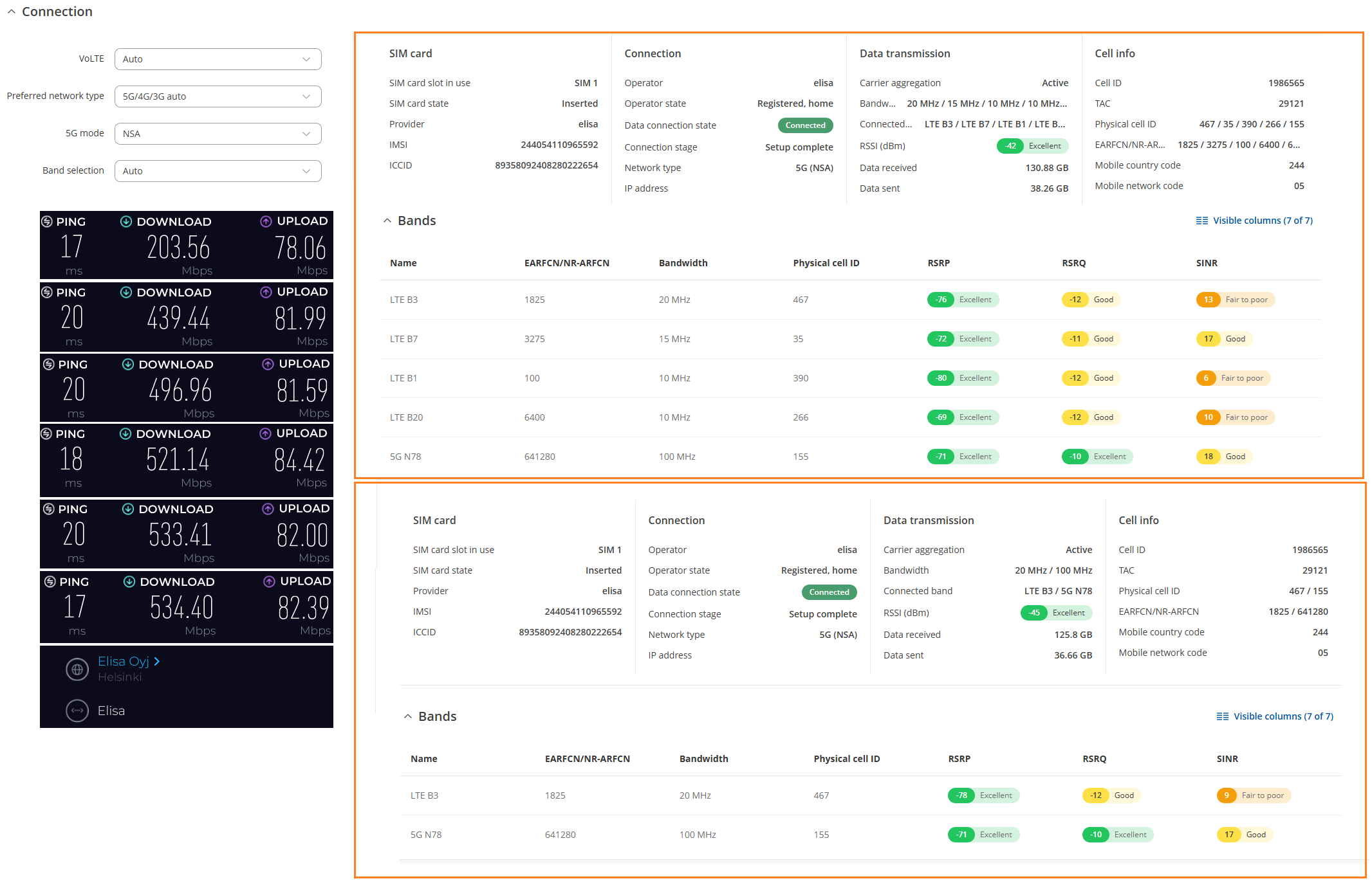

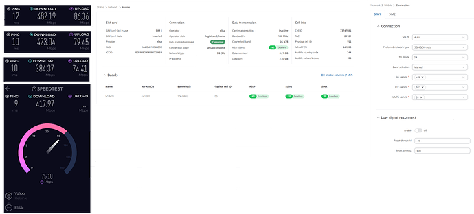

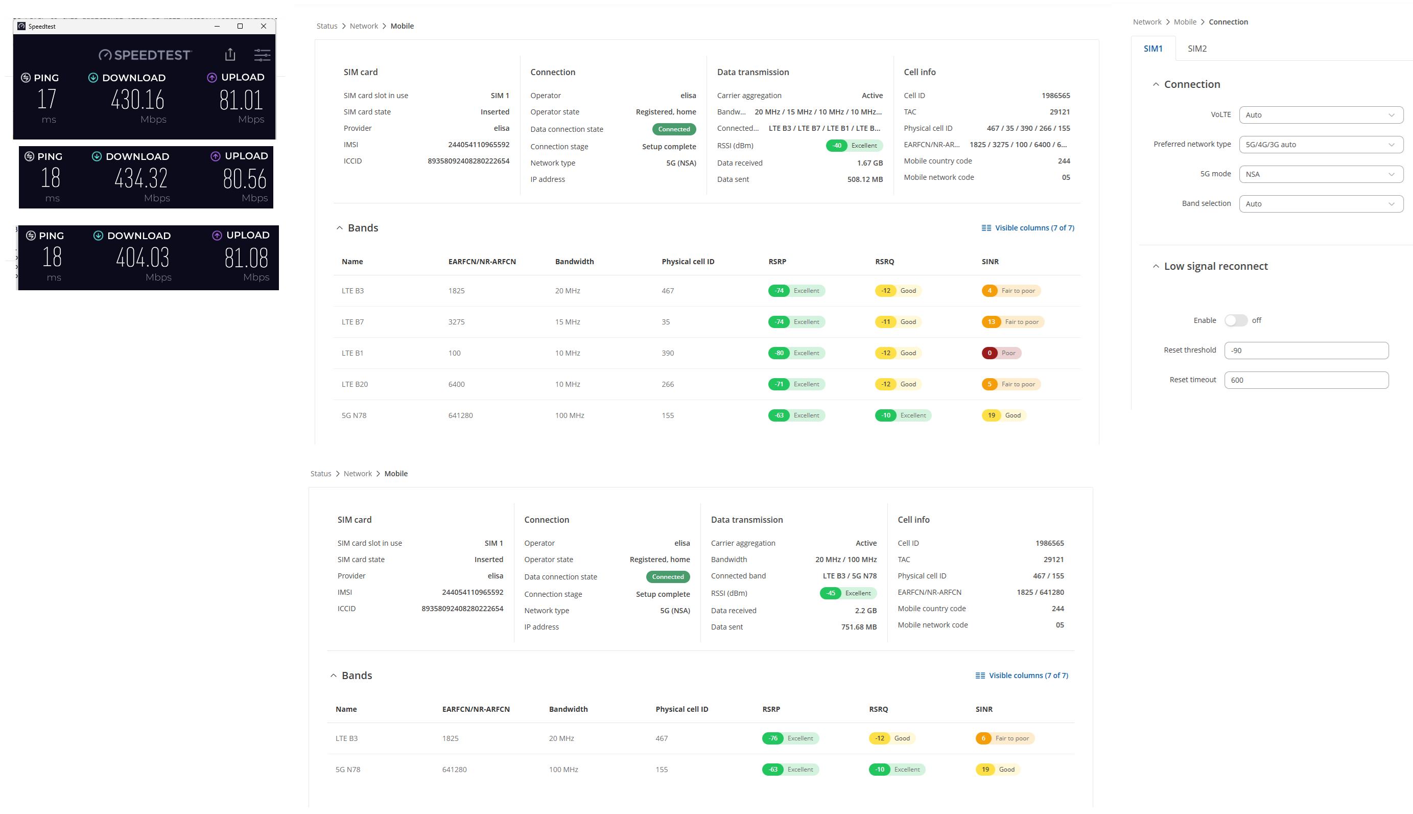

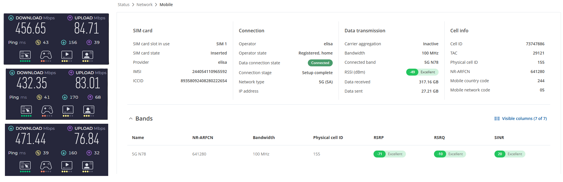

And some connection test results for 5G NSA vs SA on auto vs manual
Tested on a Sunday morning - just to note for the “connection priority” thing when there should be more devices connected since 600 has higher priority than 300 and 1000 even more.
1. I set the MTU to 1500 on the SIM 1 WAN inteface and it’s at the top of the list. All other WAN interfaces not being used have been disabled.
2 5G NSA on Auto - note when on NSA the device actively switches back and forth between the bands, so 2 bands, then 5 and back to 2 etc
3 5G NSA on manual bands (auto/cellmapper shows the available bands to select)
4 5G SA on auto

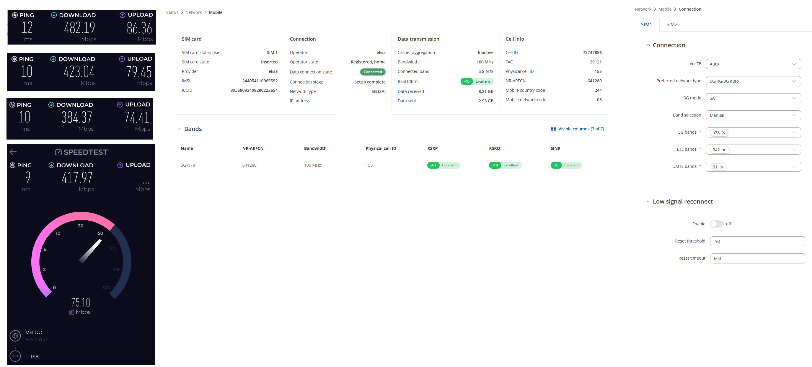

5 5G SA on manual - this was the first time I had seen the DL go close to or above 600 mbps
Hi @davyjones,
A lot of useful information here, thank you!
Indeed the behavior seems strange. Having 5G SA on auto or manual band selection should make no difference. Were these tests ran back-to-back? Perhaps you could try downloading a larger file (>= 1GB) and check what speed the router maxes out at?
At least here in Lithuania, some operators have introduced some power-saving features on their end that limits the device speed until it is actually needed. That is, the speed “ramp up” time might be increased.
Finally, regarding the external antennas, I would recommend looking into QuWireless or Poynting offerings. Their antennas are high quality and should serve you for a long time. They are a bit pricier, but if this is your only internet source, it might be worth the investment. Just make sure that the antenna supports ~3500MHz frequency range, as that is what n78 uses.

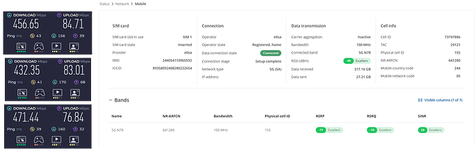

Hi @Daumantas, very glad the info yesterday was useful, I’ve been trying to get the best out of weI have, since mobile is our only option right now and you have really helped a lot, I cannot stress that enough!! :wink:
Yeps on a Sunday morning around 11am local time. I noticed the speeds on early Sunday afternoon the previous weekend were slower than on the following Monday morning so I started to think about a higher speed line (for higher prority, which the ISPs don’t tell you about when you visit a store to sign up for a contract. Or at least in my experience they don’t) and then during that week an Elisa ISP called.

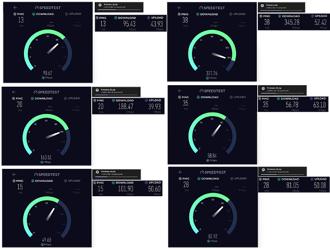

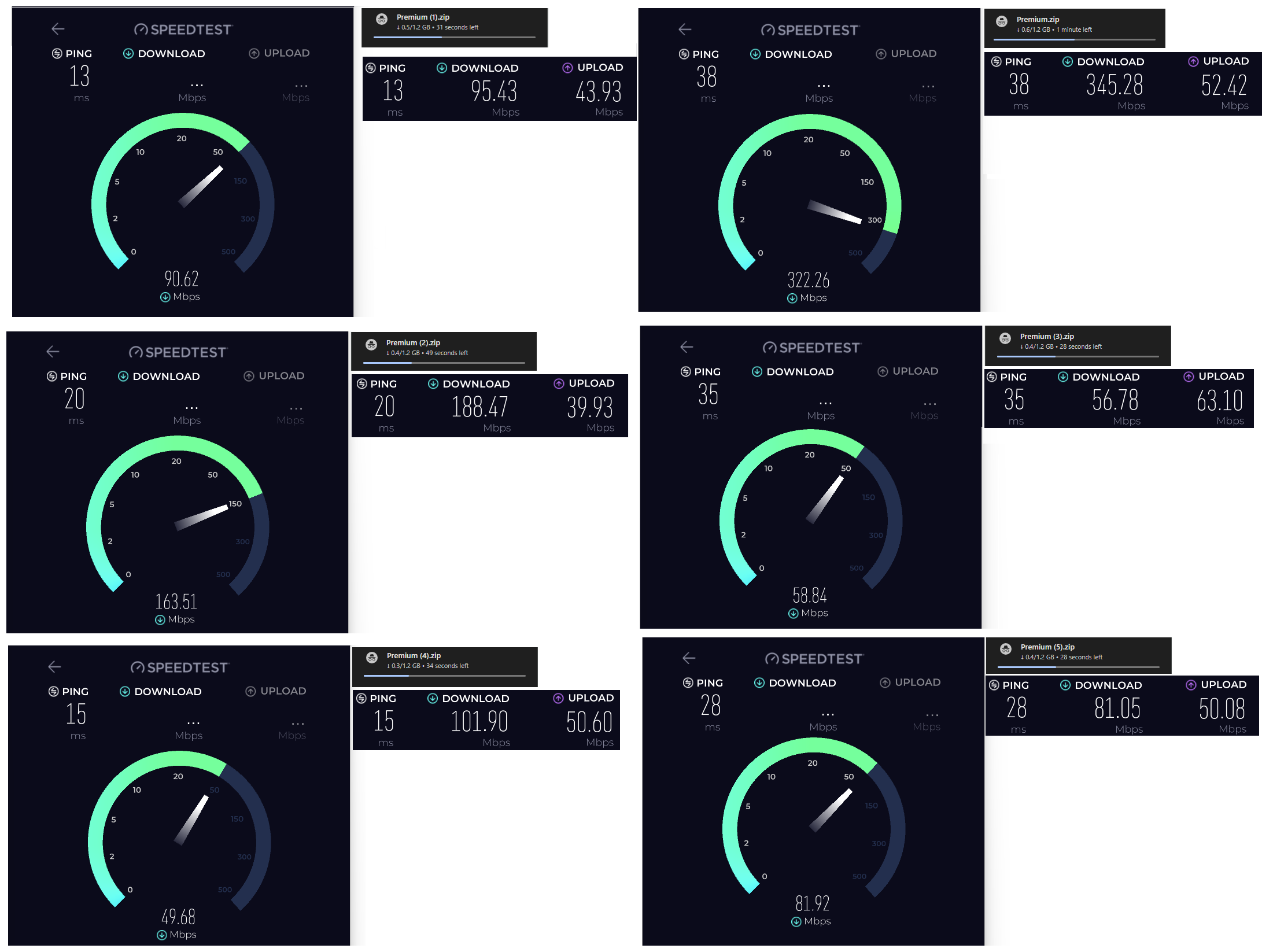

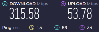

Test data below with file ~1.2 GB is that big enough?

This is normal and is generally a very good indication that this is simply a limitation on either the carrier backhaul connection, or the cell site capabilities. From my personal experience, the speed dips are mostly noticable on evenings (when everyone comes back home), and the best speeds should be expected during very early morning hours. Not really much that can be done here. I don’t suspect that Elisa is hiding some higher priority plan expect for the one intended for emergency services.
As for the file download - I think the limitation is the download server. It’s quite hard to find a server that can max out 600Mbps connection, but I would suggest trying Google Drive or MS OneDrive.
Now regarding antennas - in your scenario I’d suggest using a directional antenna, since you know where the cell site is. Since we’ve established that at least some speed loss is likely caused by the limitations on the carrier side, it’s hard to say if an external antenna would benefit you greatly.
I personally am using QuPanel 5G antenna with TRB500 (same modem as RUTX50), and it has been great. But my device is quite far from the cell site, so that’s where the directional part of this antenna benefits greatly. For your case even an omnidirectional exterior antenna would likely be more then enough. But do keep in mind, that if you’re using RUTX50 WiFi the performance indoors will likely be worse if you go with the combo 5G+WiFi antenna.
Lastly, regarding the Huawei device, I have some doubts on whether it really is being prioritized, as it seems like you’re also consistently hitting over 50Mbps. I’m guessing it’s just what Elisa prefers for the customers to use, since they can likely manage that device remotely and troubleshoot any issues that the customers face, whereas on 3rd party hardware it’s up to the client to diagnose the issues.

And in terms of directional vs omnidirectional we live on the side of the lake where 4501 is and where most of cells are on the other side of the lake. I guess that’s not a factor as such, I mean if an directional antenna was installed on the side of the building where 4501 is I assume that’s okay for the long term, it being closest anyway.
Yes good point, some quick Google drive tests uing the same file, 1.2GB
