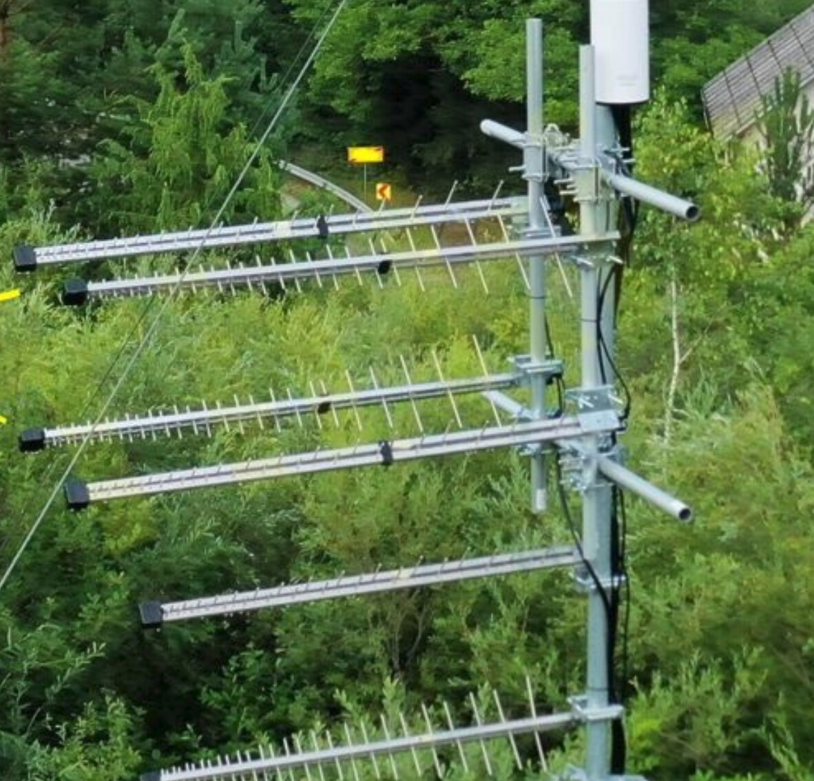

It can help drastically if you are using antenna from reputable manufacturer like Iskra or Poynting. However, nn locations with low signal such as yours, omnidirectional antennas are waste of money. You need something like this if you want results.
These are Iskra P60 and they are not cheap nor easy to install. Cheap antennas can make matters worse. I would recommend, just for testing, trying your device outside. You need to find exact issue before you start throwing money at the problem.

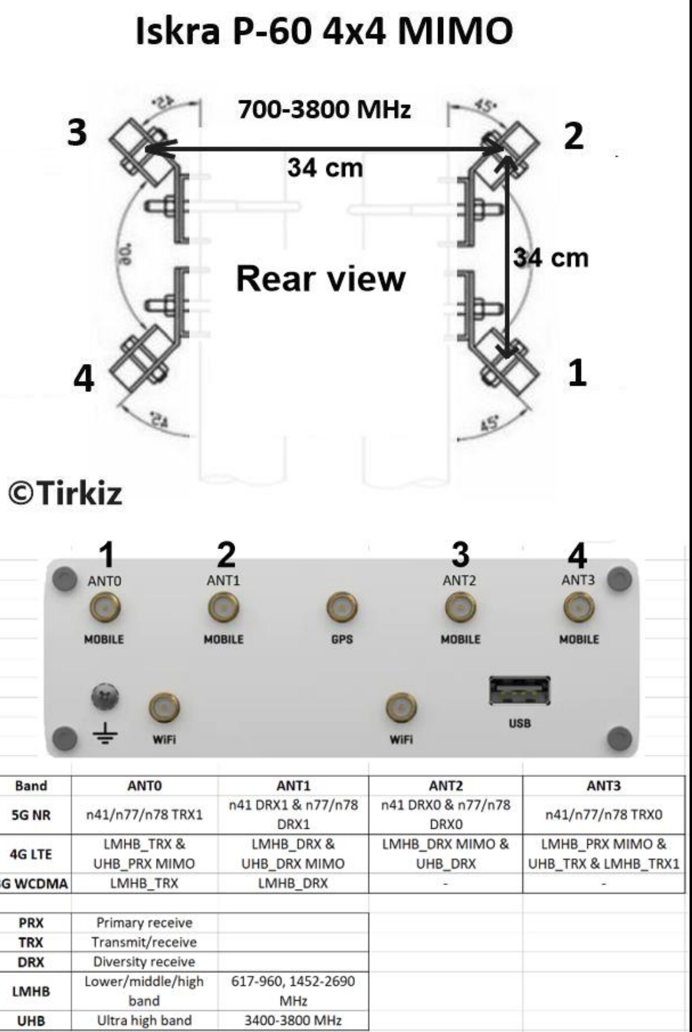

Well, the fact that you need a pole, you need to drill a hole and lay down the cables is sometimes seen as very complicated thing to do by majority of people. Ive seen people that think drilling a hole throgh a concrete ceiling or wall is a huge problem for them. Let alone climbing up the roof or laying cables. If its not a problem for you, thats great. One think you need to pay special attention when it comes do directional antennas is polarisation.

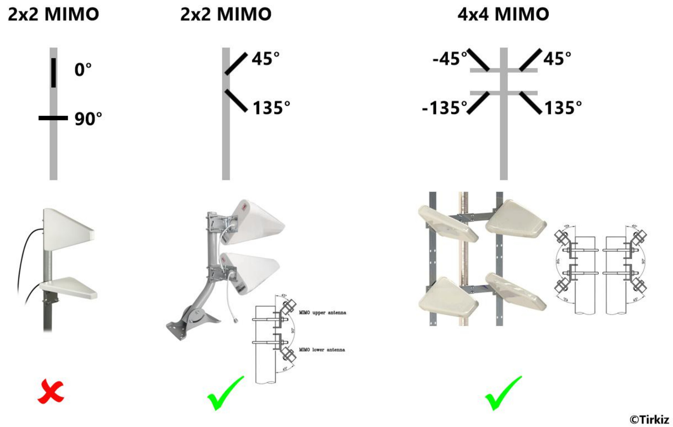

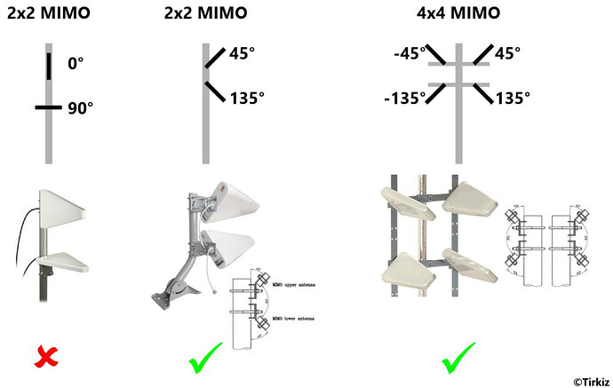

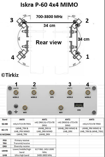

This is how they should be connected to RUTX50
Thanks to @tirkiz for these images.
I looked up the Iskra P-60, but it seems to be just 2x2? Would one need to buy two sets to get 4x4 MIMO? Generally I don’t think this product is sold where I am btw.
Yup. You need two sets.
