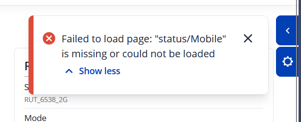

Ok, another one connectivity loss. This time I even could not load status/Mobile page:
Flash your device from boot loader mode in order to fix this issues. First download firmware for your device from here, and then follow these instructions on how to flash. Before you say “my device is already on version 07.24.1 why should i flash again?” That doesnt matter at all. Flashing same firmware from boot loader mode is different than upgrading from web ui. Its a known way of solving many, if not all issues on this device.
Thanks, Heartless.

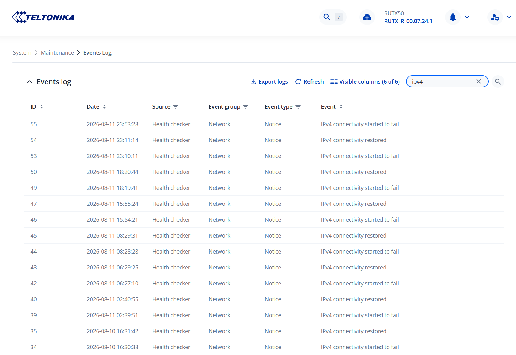

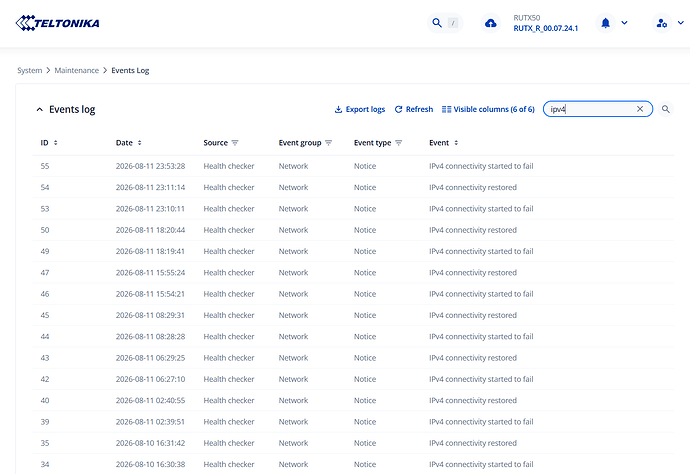

Well, uptime was about 1 day and 11 hours since that reflash and then I noticed that Internet connection was down.
Here is event log filtered by “ipv4”. That last one disconnect I had to manually restart since it has not recovered by itself after about 15 minutes.

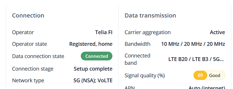

Curiously, modem connection seems to be active while Internet connection is down. It has been every time I checked.
Here is your problem right there. You have VoLTE enabled. Disable it. Also, if your provider is not relying strictly on IPv6, disable that as well.
