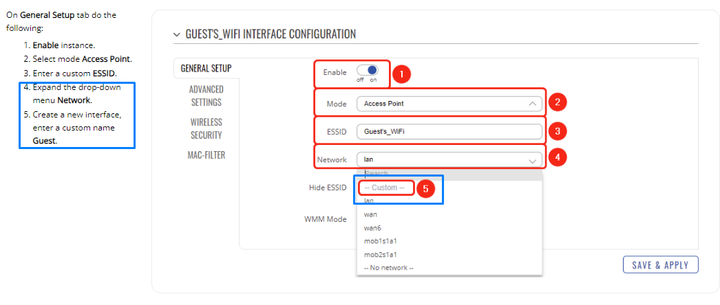

From the screenshots, it seems that when you create a WiFi instance for guests, you select LAN as the network. The LAN network already exists and has an interface, thus this WiFi instance attaches to that network and an interface window does not pop-out when you press save&apply. You need to attach the WiFi instance to a custom (guest) network. This is identical as on the previous firmware versions and is mentioned in the guide (I marked it with blue color):

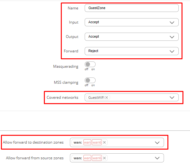

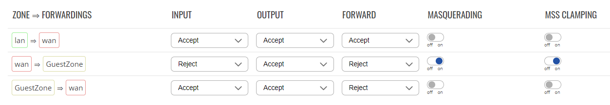

Also, I am not aware of your current configurations, but make sure to check your Firewall settings. Specifically, that guest zone is allowed to WAN, GuestZone covers GuestWiFi, and that the LAN zone does not include the GuestWiFi in covered networks.
Zones:
Guest zone:
LAN zone:
Traffic rule:
If you still experience issues, let me know.
-Custom- can not be selected. Under no circumstances I can select “Custom” as a valid option - it has to be either -No network- or Auto or any of the other options.
Selection of -Custom- is not possible.
If -Custom- is selected nothing happens, as soon as click off the list it reverts to lan or whatever other valid interface was selected previously.

Sorry to hear that you are having these issues!
Please, when pressing on the network field, ensure that you click on the ‘-- Custom --’ field and enter the name of your network directly in the drop-down menu where you have just clicked:
Please keep me updated on the results.
Thank you for your help. It works now. I had to figure out that I need to separately assign firewall zone in interface page, but it was trivial.
