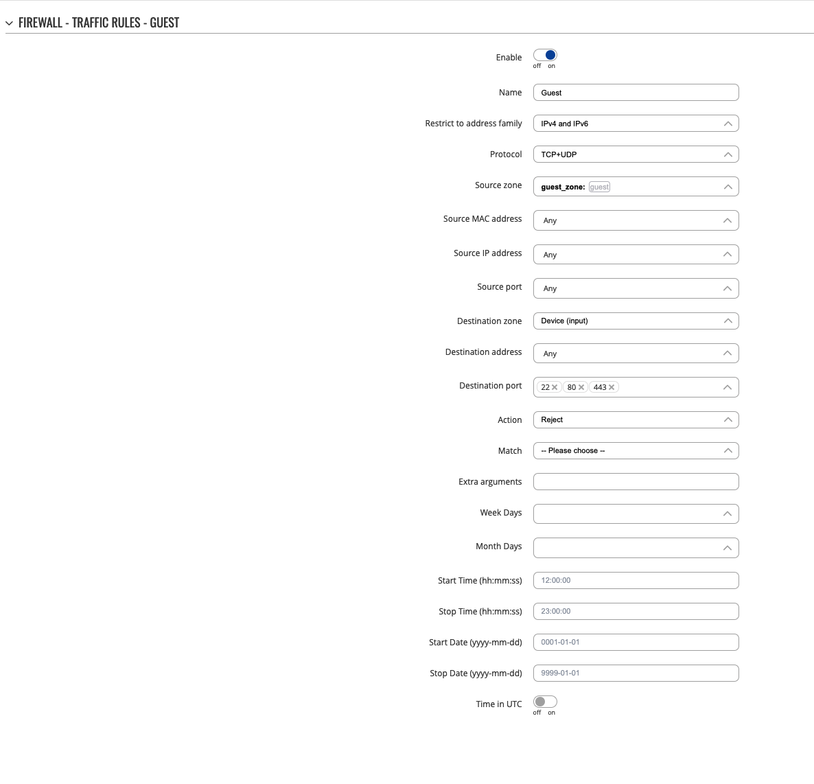

Finally, I’d like you to attach a screenshot of the firewall rule configuration, that blocks the access to ports 22, 80, and 443.
As per the Wiki page firmware, the configuration is still the same (except for the few icons), and the GIF is only for reference-purposes to show where the Advanced mode can be enabled.

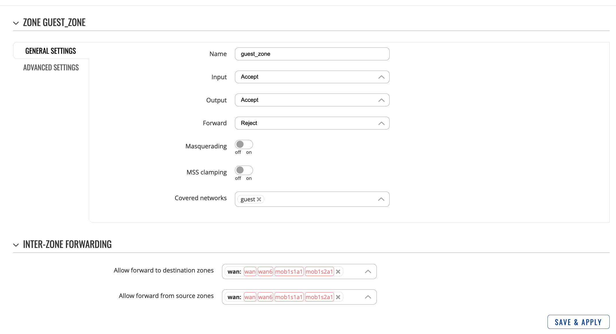

Here are the 3 requested screenshots. (As I am a new forum user I have to post the screenshots in separate posts.) A restart did not change the behavior.

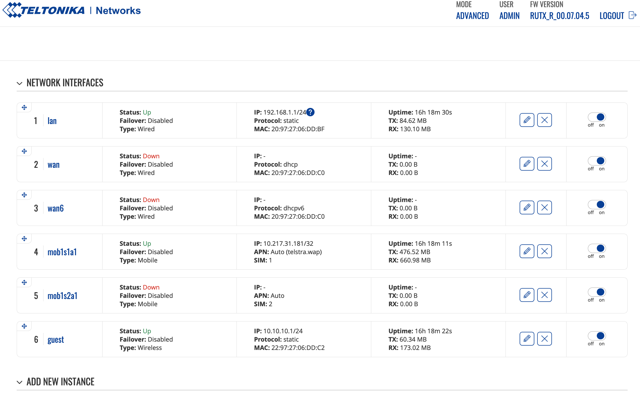

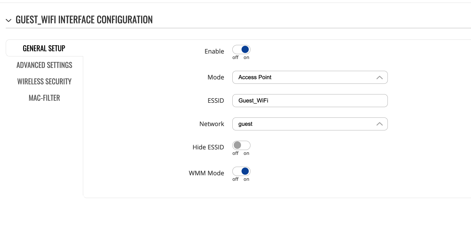

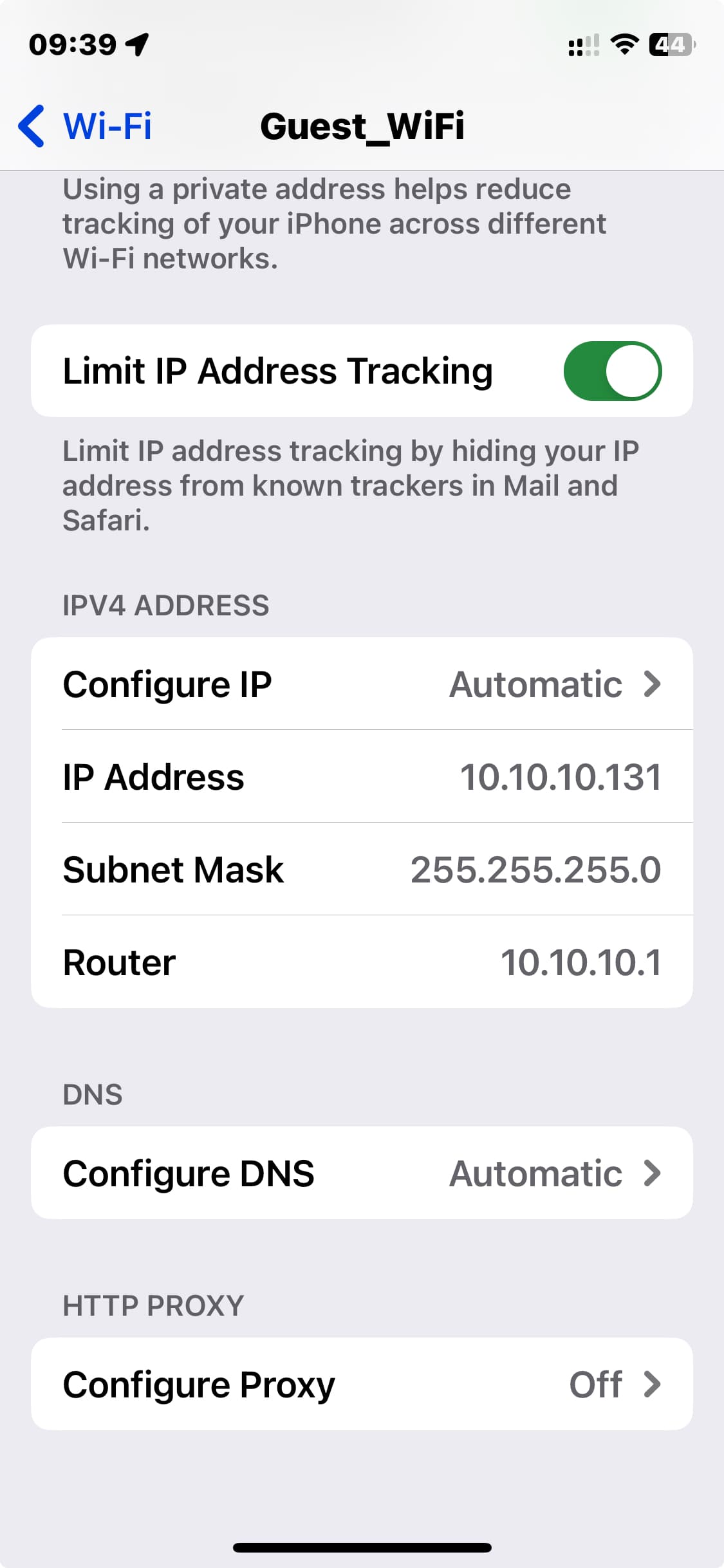

Could you also upload screenshots of the Wireless Guest interface (Network β†’ Wireless β†’ Guest), as well as the the network interface (Network β†’ Interfaces β†’ General) configuration?
Additionally, could you check if the clients that are connecting to the guest network are getting an IP address from the Guest network?
Here are screenshots of Network-Wireless-Guest and Network-Interfaces-General. Also screenshot of client IP operating on guest network.

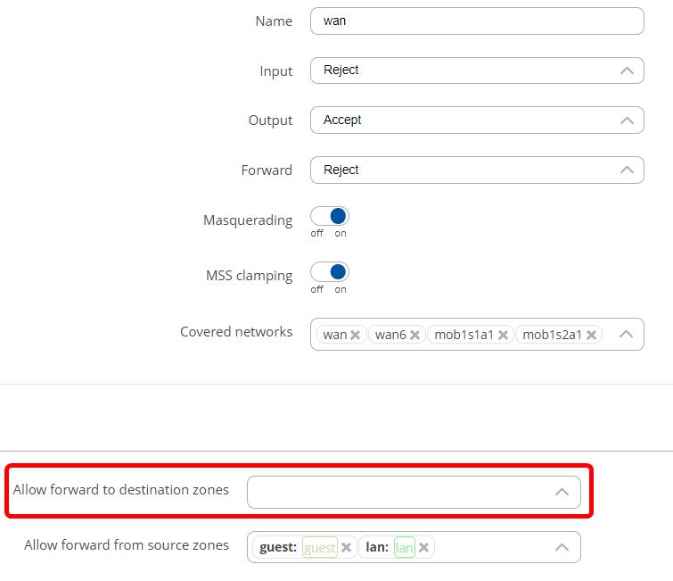

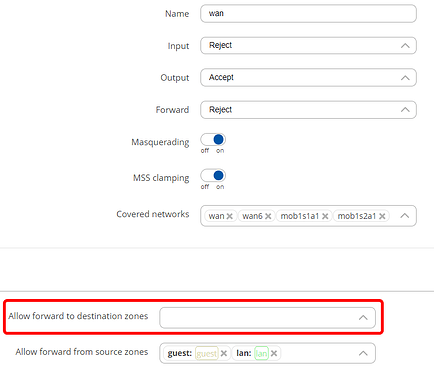

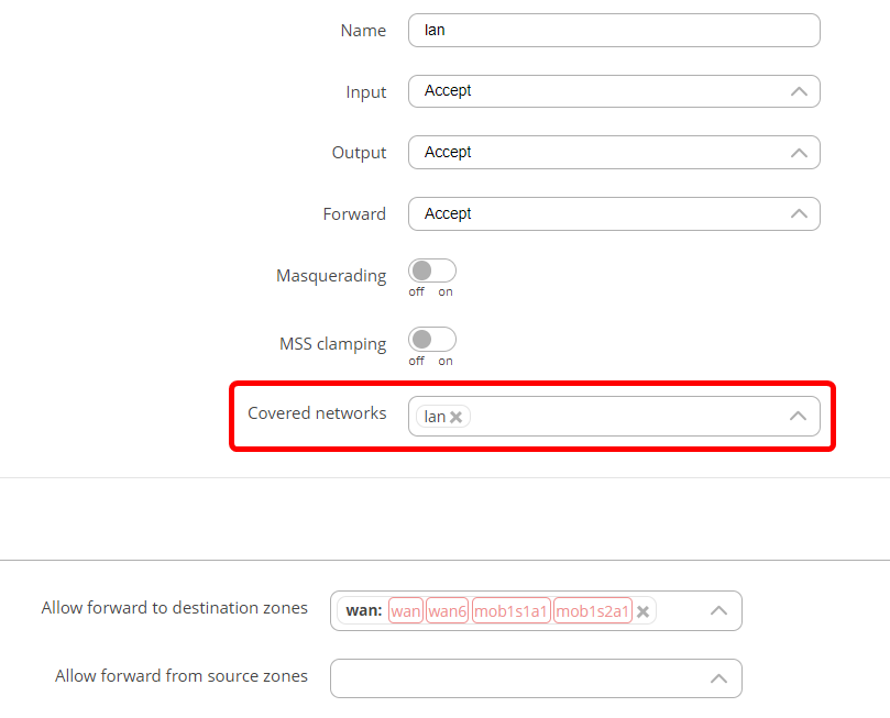

Could you make sure that:
  • Guest network is removed from the LAN zone networks:
  • WAN zone cannot forward to any destination zones (unless you know you need this):
  • FORWARD flag can be left to Accept in the general firewall settings;

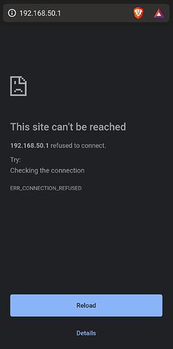

Other than that, I’ve checked your configuration and it seems to be working fine:
As mentioned, try restarting the firewall or the entire device once the configuration is finished.
Thank you Daumantas, your advice has fixed this issue. Very much appreciated!
