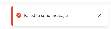

From the webUI:
The system log has no entry with these requests.

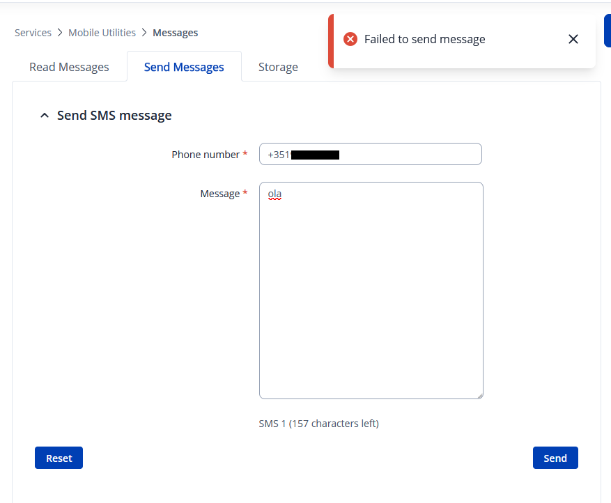

Have you tried sending yourself a message via:
Messages > Mobile Utilities > Messages > Send Messages?
Hi akwe-xavante,
I did. This is the result:

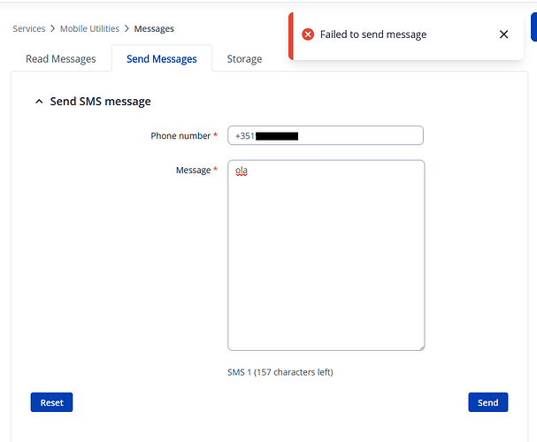

Hi akwe-xavante,
Thank you for the suggestions.
Tried the variants in WebUI:
  • +351NUMBER
  • 00351NUMBER
  • 0351NUMBER
  • 351NUMBER
  • 00NUMBER
  • 0NUMBER
None with success, unfortunately.
