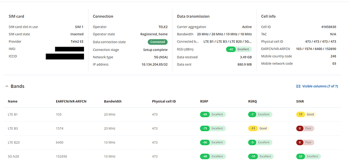

And after that, nothing works anymore until reboot.
In webui, i see briefly that router is connected to N28 and also several 4g bands, but none of the packets go trough. After a while, whole connetion is dropped and only way to get it back is to disable 5G completely.
Is that SW or HW issue?

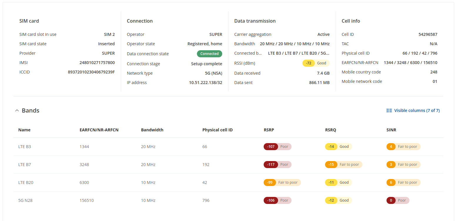

Could you also share a screenshot of the Status → Network → Mobile page where the N28 band signal strength is displayed? You can find recommendations for optimal signal strength here: Mobile Signal Strength Recommendations.

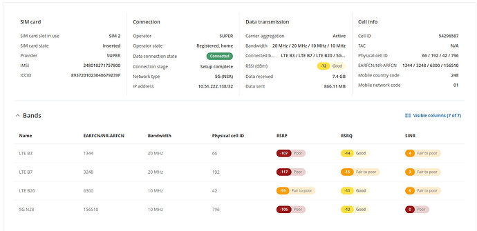

Thank you for providing the information. From your screenshot, it appears that the signal strength is poor, which is likely the cause of the issue you are experiencing.

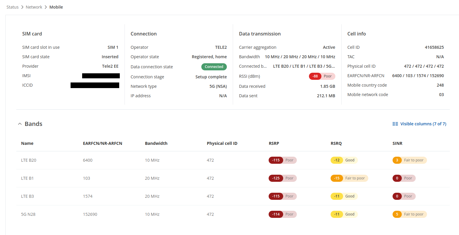

Previous screenshot does not represent normal state.
Since qmi_wwan module is failing, i had to make sure i get screenshot as fast as i can (during connection initiating) because in later state, there is nothing to see, all values are N/A.

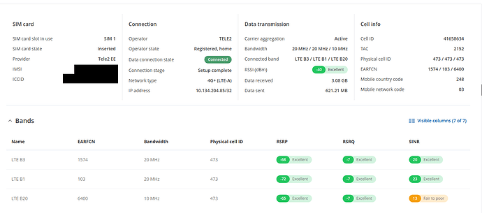

But if connection is made normally (4G), then signal is also poor at the beginning, but in some seconds it gets better and stays so.
This screenshot is when router is workink on 4G only, and download speed during that time is about 60-70Mbit/s.
And i do use two 18dBi directional antennas.

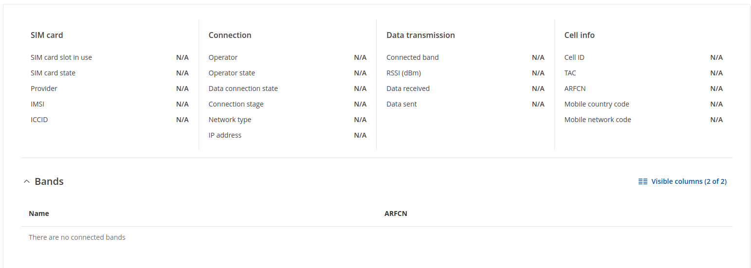

But since modem goes away right after connection is made, most of the times UI will end up showing N/A before i see green RSRQ, but it did happen. If you like, i could try to get screenshot for you where N28, B3, B20 are green and B1 is orange (this band never has been green).

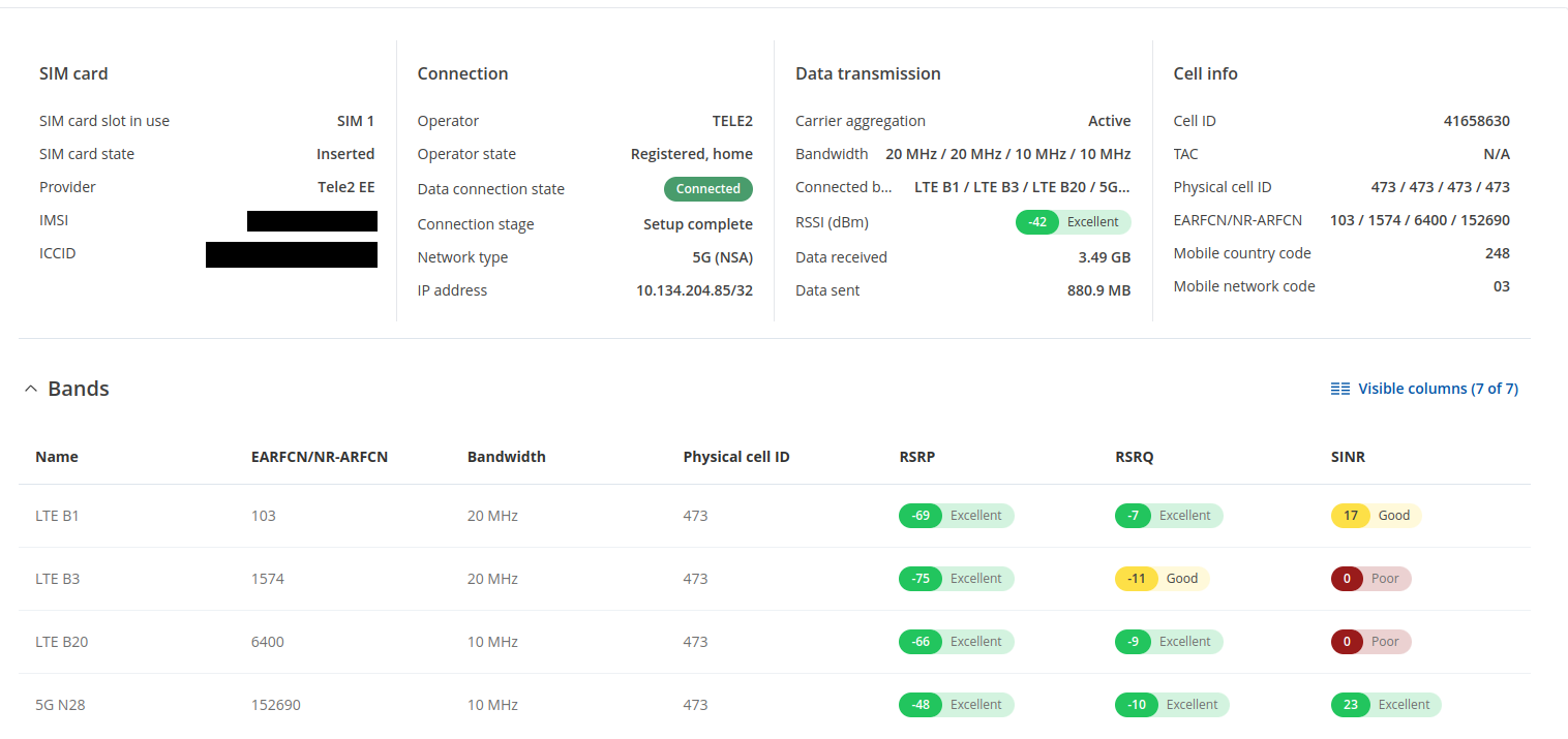

OK, i went close (150m) to tower. Signal was good, Speedtest showed ~200Mbit/s down and ~100Mbit/s up. This was 4G only.

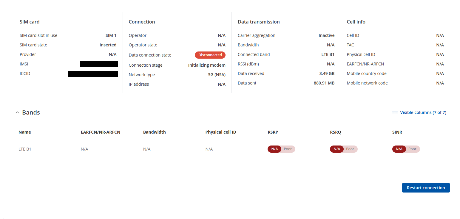

Now, i switched router to 5G/4G/3G auto mode. Router restarted connection:
Ping was running whole time, IP address was shown by UI, but no packets got answer.
Then, again, after 10 seconds, same qmi_wwan module problem appeared on log:

After that, modem was gone and UI showed N/A everywhere:
After that i monitored log some more, and i saw modem (sort of) reappear and several different errors were logged:

After that, UI showed weird things:
And router tried and tried to restart connection again and again, but it failed every time.
Since at this point, modem was (sort of) available, i managed to set config back to 4G only, but even that did not resulted succsessfull connection.
Only thing that helped was reboot, and after that (4G) connection was made, and everything worked again.
Conclusion: this in not signal issue, since close to tower, singal was very good.
I did not test router in its stationary place with antennas that came with router, since there was no point of doing that after test that was made close to tower resulted same behaviour as “low signal” in routers stationary location.
At this point, i’m thinking that we can also rule out SIM issues, since that SIM worked with Nokia router on 5G network.
edit: forgot to mention, that i tested router with different SIM also (same operator), results were same - no 5G connection.
Only thing that i can test more is to switch operator.
In that same tower, tere is also 5G offered by other operator (Telia), but i have to get Telia SIM first, so it will take some time.
Hi, could.you please test with standard antennas? It can cause this too, better to know that antennas is not a root cause for this.
I did test it with standard antennas close to cell tower where signal was good.

Update:
Bought prepaid SIM that works on Telia EE (24801) network.
And this SIM works without problems. Signal is not the best, DL is about 60Mbit/s and UL is about 10Mbit/s.
This Telia sim is now in socket 2.
Previously i tested this socket also with Tele2 EE SIM, but result was same as if Tele2 EE SIM was in socket1.
Now i’m suspecting those Tele2 SIMs. Both SIMs are about same age (~4y).
Maybe i will exhange one of them to newer one.
Also, in next week i’ll get another operator (Elisa) SIM for testing.

Small update:
Got different Tele2 SIM, looks completely different, maybe other manufacturer or different batch, idk.
But result is same, as soon as i switch on 5G, no more internet.
And in this case that module problem was again in log:

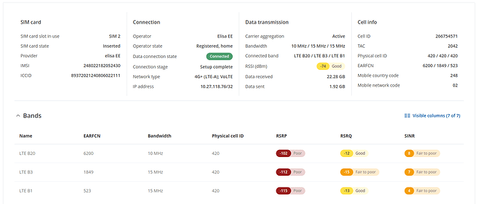

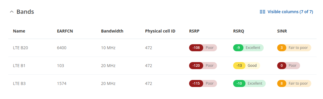

Got also third operator SIM (Elisa), but Elisa has so poor coverage here that only B20 is stable, other bands keep appearing sometimes, but they are useless, signal is so low that they dissapear after some seconds, also Elisa 5G coverage does not seem to reach here, so i was unable to test 5G on Elisa network.
