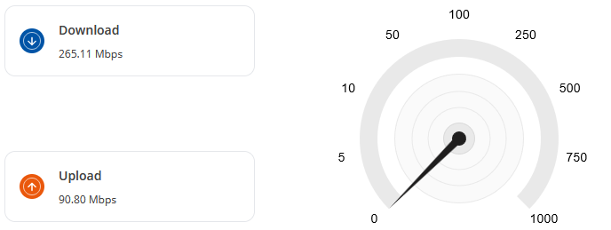

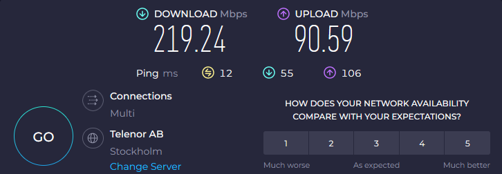

In Stockholm suburbia I get about 210-300 Mbps in the evening, 130-160 Mbps during the day. XPOL-2 is hooked to terminals 2 and 3, bunny ears on 1 and 4. Signal is between -43 and -50.
Overall it works, more or less. As long as it does not get any worse, I can live with it, but Teltonika were next to useless with advice on how to actually fix it.

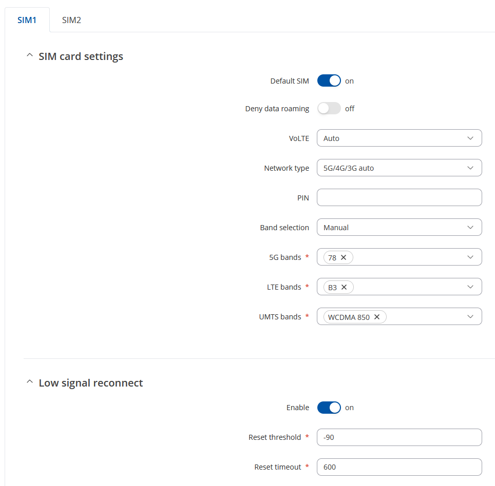

@DelphiC Perhaps you could try blacklisting the n78 5G band to check if the issue reappears? This can be done by navigating to Network → Mobile → General, selecting the network type as 4G + 5G, adding all 4G bands, and all 5G bands except 78. Thank you.

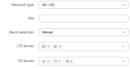

I have managed to perform a “cargo cult” procedure some time ago and set settings that actually made the difference and stopped this issue from re-appearing, AFAICS!
Procedure: reset the to factory and re-flash everything from CLI (to RUTX_R_00.07.04.5), set ping modem reboot to on, 3 min/ 10 s/ int 2.
And for me, this worked:
B7 and B1 are the strongest LTE bands around where I am and 78 is what is in use for 5G. Speeds are 300+ down/100 up.
With that, I do not get “3 flashing LEDs death” any more. Router still looses connection every now and then, but is capable of soft-rebooting itself on its own, without power cycle from me. Also, when I’m in WEB UI under “status network mobile” WEB UI reports occasional disconnect/connect events but it does not affect anything as far as user experience goes.

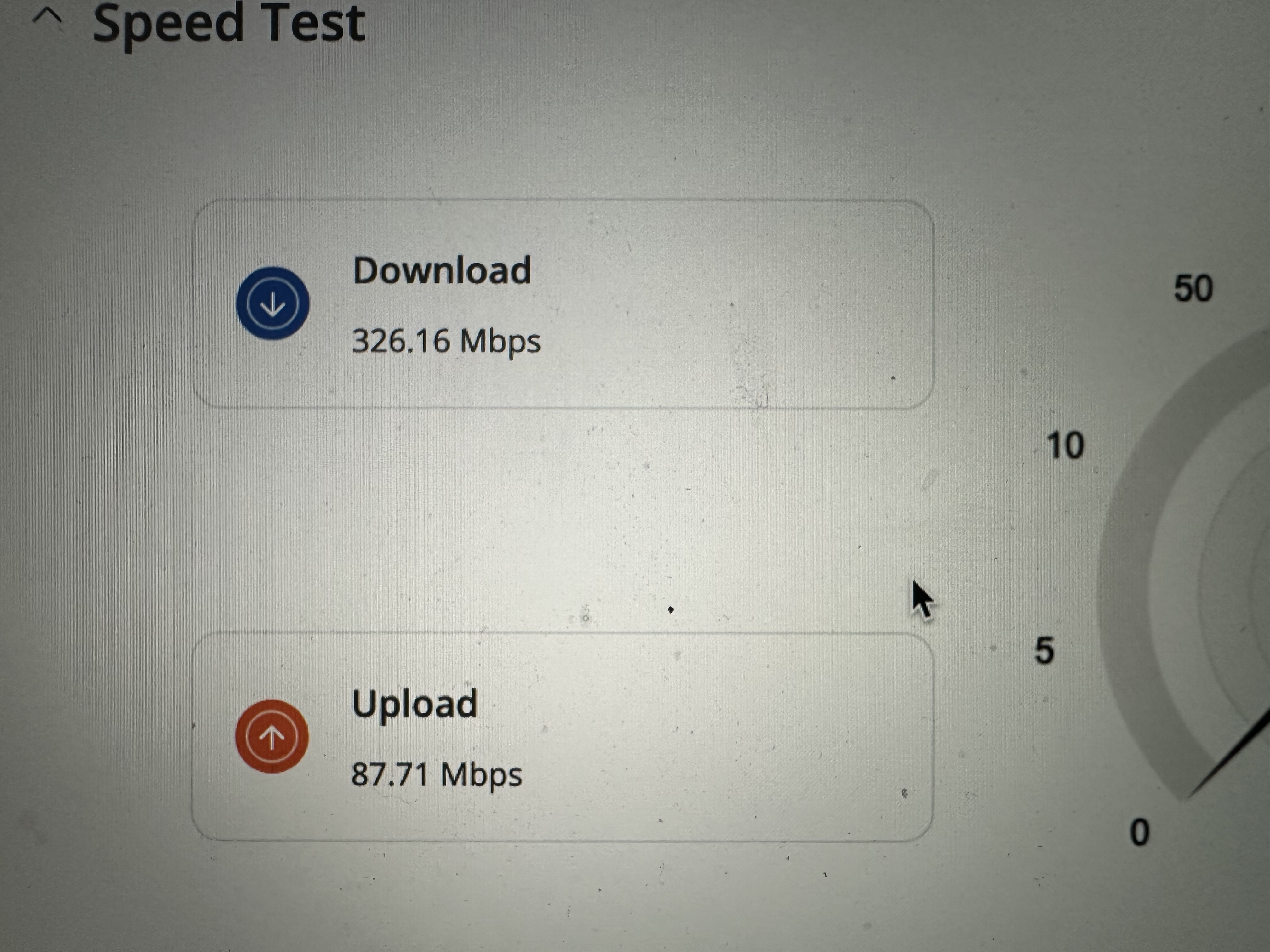

I’m using a Poynting XPOL-0001-V2-41 4x4 mimo on a pole on top of my house roof with the 5m included cables not extended.
I’ve been in contact with Poynting and they have been helpful with the installation. I’m pretty close to antennas in rural area. Mobile phone and Netgear M5 gets 5G indoors without antennas.
I’ve done field testing down town in Stockholm and areas with perfect 5G NSA and there I get 1Gbps down with Netgear M5 and IPhones but only around 400Mbps with Rutx50. Obviously connected with network cable…

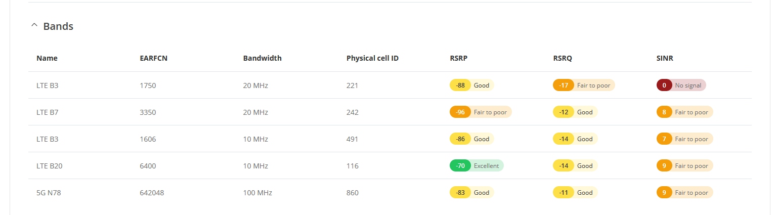

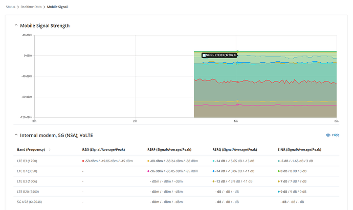

I’ll reply later, not at PC now. Say, can you post screengrab of signal levels and bands? this one?

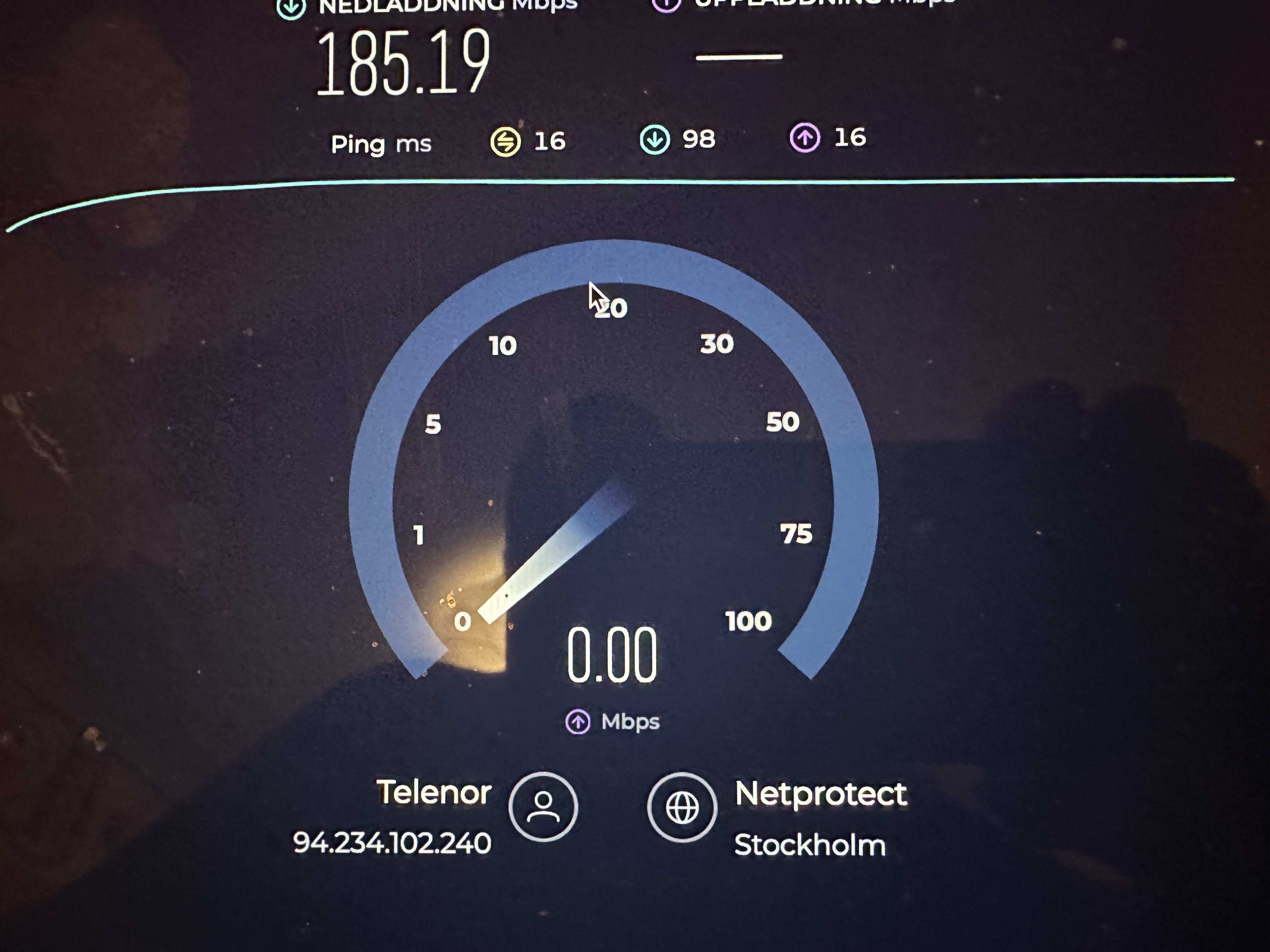

True about speed but I do care about ping and ping is excellent as long as it stays 5G. I have two very demanding users here (my daughters gaming) and when 4 users/family members are streaming 4K it’s perfectly OK in 5G (when it works). We run medium size bank offices with 100Mbps and 20 employees so the speed incitement is just a selling argument from our fibre providers, fully agree with you. As you can see ping was 16 in 5G, fully acceptable even for gaming.
I’m beginning to think the RUT50X is hanging/becoming unresponsive because I do LAN LAN with port forwarding thru a switch to my WLC/ROUTER but that’s just theories so far.

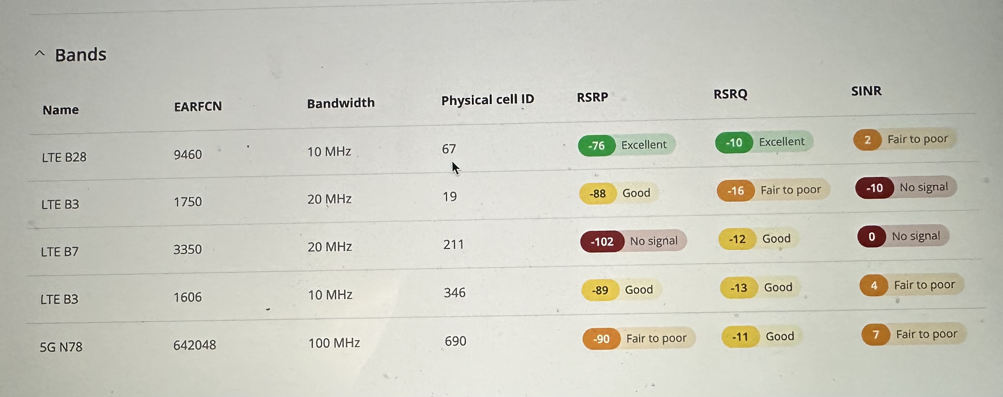

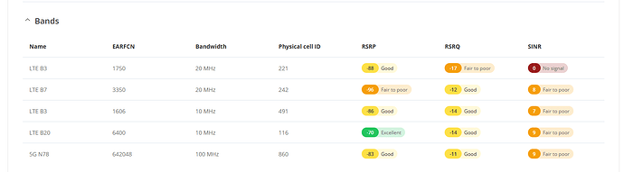

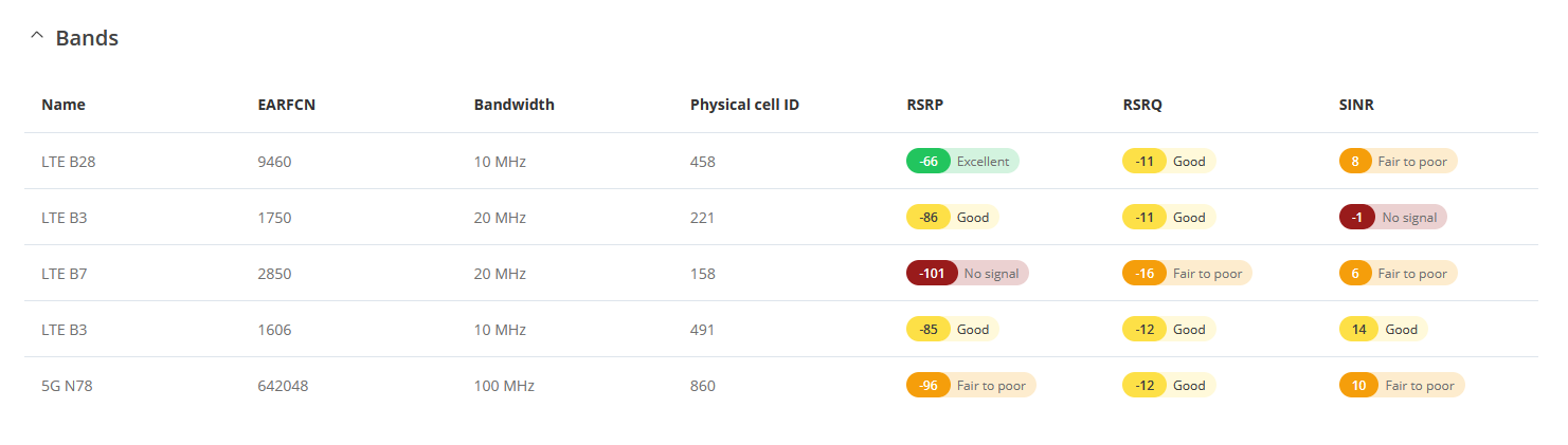

What do you know after toggling settings I was on 5G for a while. Il post some pictures in 4g and 5G below. I tend to not allow LTE B8.
Hej,
It’s a bit weird. I never seen “that” when I was having issues. It looks like router just dropping a bunch of channels and ignoring them altogether? Never seen that happen while I was tinkering with mine. Say, can you try going to modem settings and mess with the bands a bit? Switch “Band selection” to manual and restrict to 5G, one LTE band and some useless 3G you are not using and maybe flip Low Signal Reconnect to “on”.

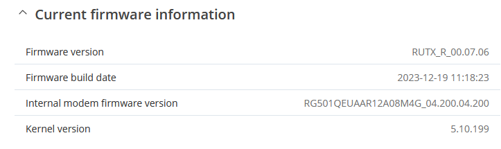

This is what on the router now, firmware-wise:
There was also this issue reported earlier - RUTX50 internal modem firmware issue - #3. Regarding reset - don’t know what you have done when resetting - I did mine from CLI - RUTX50 Device Recovery Options - Teltonika Networks Wiki and also updated from CLI.

I’ve tested disconnecting the antennas and it sure makes a difference so I’m sure it’s ok, as you see my signal strength is ok-good.

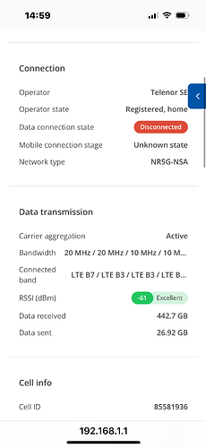

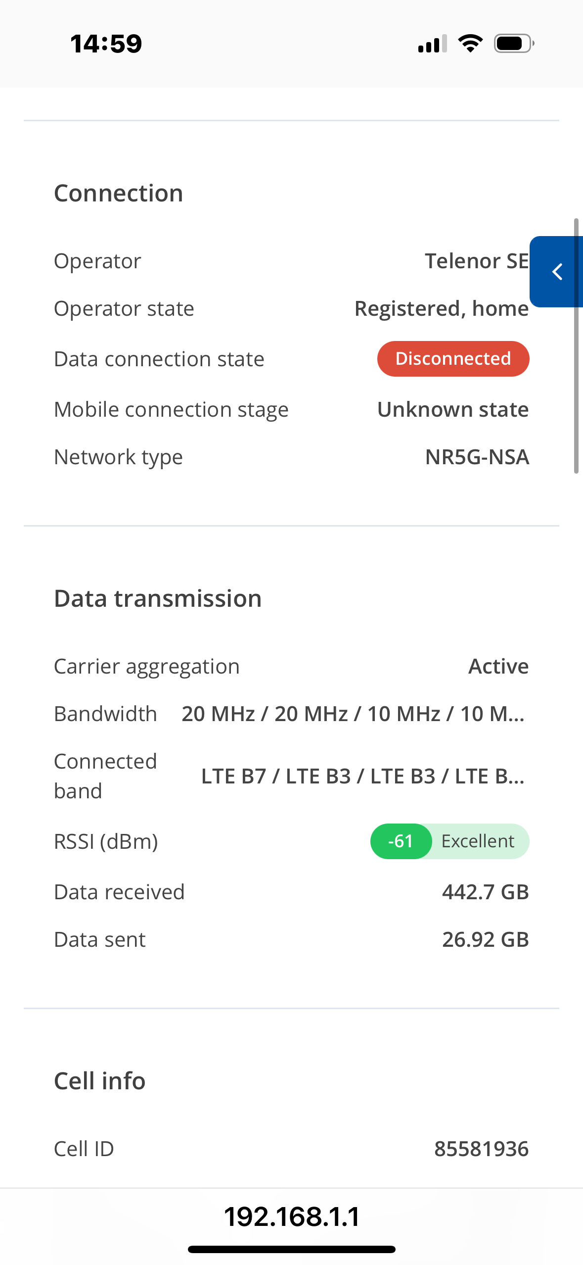

Router has been running ok for a while so I’ve connected it to my wifi, it’s actually not been hanging up for 5 days until today… it’s strange it all happened when we where downloading a few ps5 games. The router was still accessible so I tried resetting restarting the modem and this is what happened…

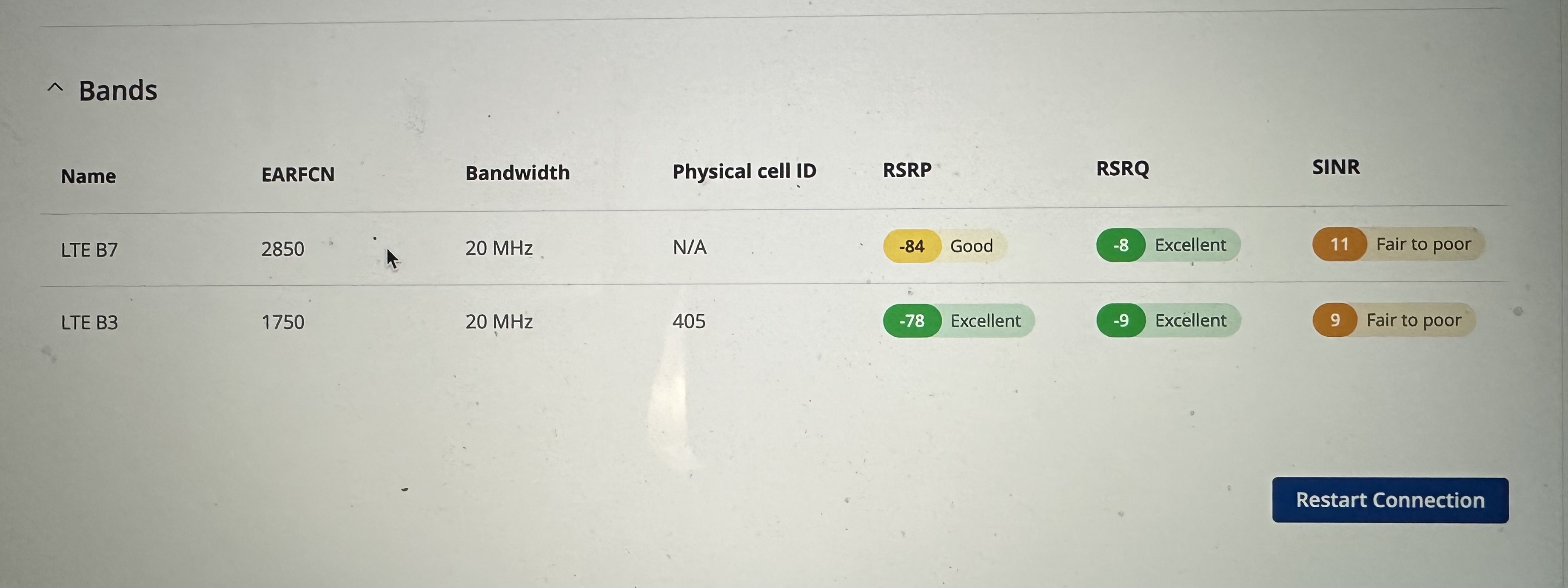

As you can see it stayed in disconnected although I restarted the modem several times. After rebooting the router it works again.
I really would like Teltonika to help here, I don’t want to send it to the vendor to have them test it 5 minutes and returning it saying it works. Especially now that it seems to brake down when it’s under heavy load…so much for reliability… please can someone from Teltonika advice here?

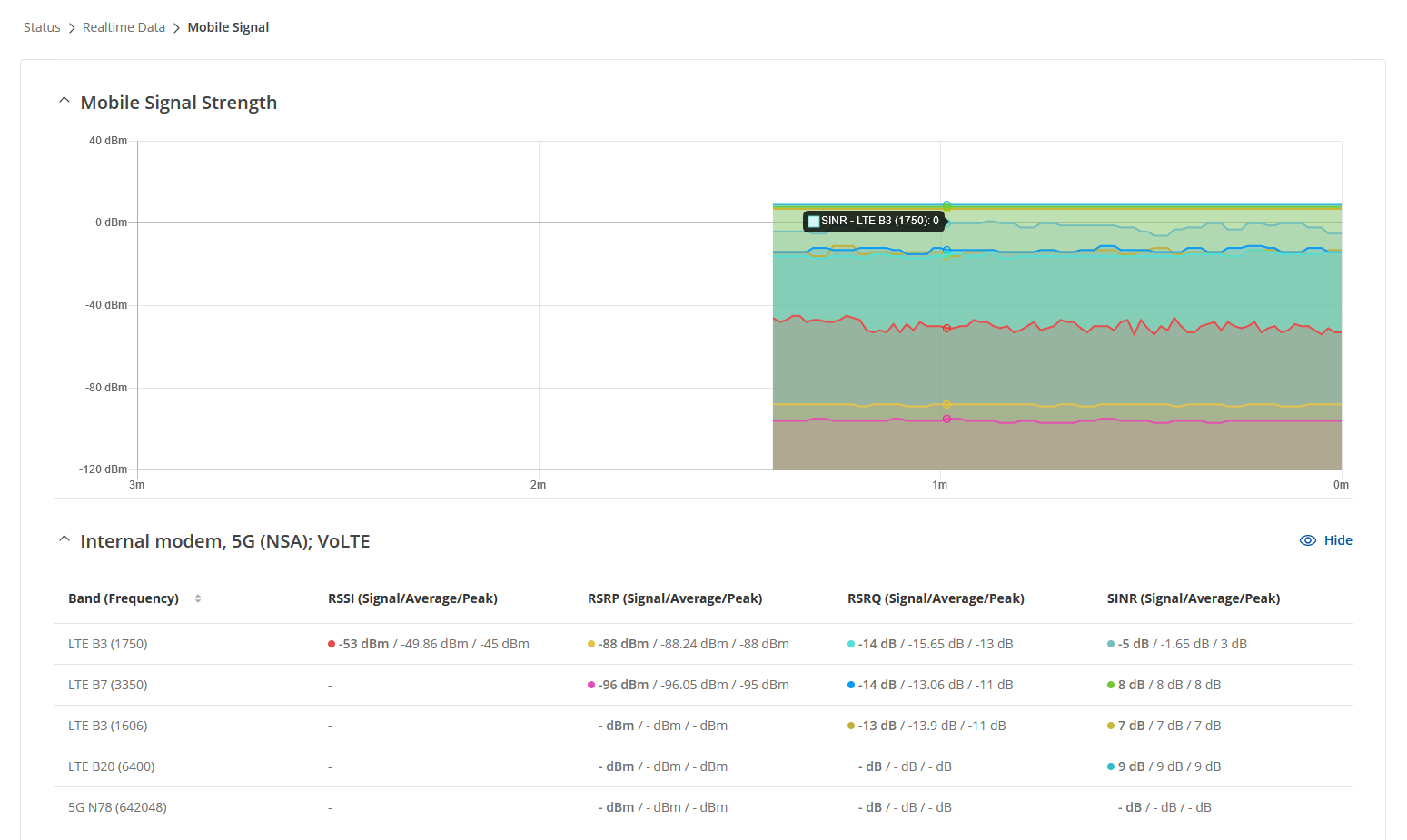

One pane now says 5G is connected:
The other fails to see it:
Looks like came after latest update to 07.06.1. I’m not too fussed about it as router works just as before, speeds are fine, but one can’t help but wonder if there are just too many features on this thing - I’m pretty sure everything is working as it should internally, just reading the data gets mashed up.
