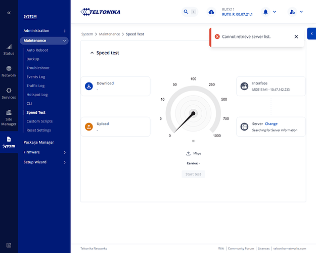

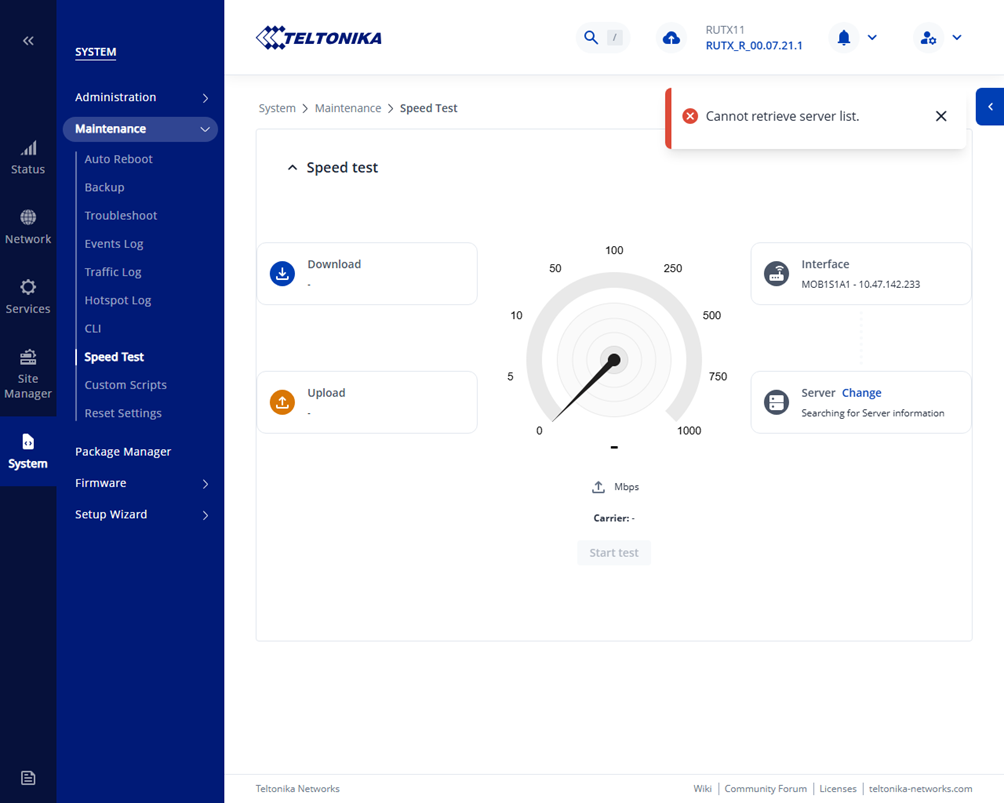

Hello, I can no more able to do speed test after update to 7.20.3 with my RUTX11. I tried to update the last version firmware 7.21.1 but nothing change. I recieve this error: Cannot retrieve server list.”
I tried to a new server list but it doesn’t start.

Could you confirm that you really do have a working internet connection on your device? You can do so by sending a ping to 8.8.8.8 from WebUI → System → Maintenance → Troubleshoot → Diagnostics
Additionally, if you do have internet, please provide a screenshot of the error message you’re getting.
I don’t have any connection problem !!
I have the only problem when I try to do the speedtest inside of my router. This iusse has began after update to 7.20.3 I tried update to 7.21.1 but nothing change.
I can navigate regular and every speed test by ookla or any other but no more inside the router.
this is the ping

I’ll have to collect the troubleshoot file to see the logs of the device. I have sent you a form to fill out, which you will receive in your e-mail inbox that you have registered your account with in the forums. In the Ticket ID field of the form, please enter the ID of this thread, which is 18080. I’ll contact you once the form appears in our system.
