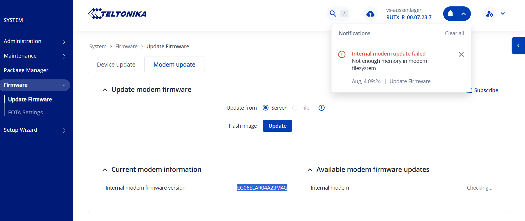

RUTX09: Internal modem update failed / Not enough memory in modem filesystem
Same as in closed topic: RutX09 cannot update modem firmware - Networking Solutions - Teltonika Community
Modem Update per WebUI is failing, Device Update per WebUI file Upload ok.

root@vs-aussenlager:~# df -h
Filesystem Size Used Available Use% Mounted on
/dev/root 20.8M 20.8M 0 100% /
tmpfs 120.1M 692.0K 119.5M 1% /tmp
/dev/mtdblock15 576.0K 272.0K 304.0K 47% /log
/dev/ubi0_2 83.6M 1.7M 77.6M 2% /overlay
/dev/root 20.8M 20.8M 0 100% /rom/etc
overlay 83.6M 1.7M 77.6M 2% /etc
overlay 83.6M 1.7M 77.6M 2% /usr/local
tmpfs 512.0K 0 512.0K 0% /dev
Is there anyway to update the modem firmware?
Without resetting to Factory Reset as Device in located outside.
Thanks and kind regards
Robert
