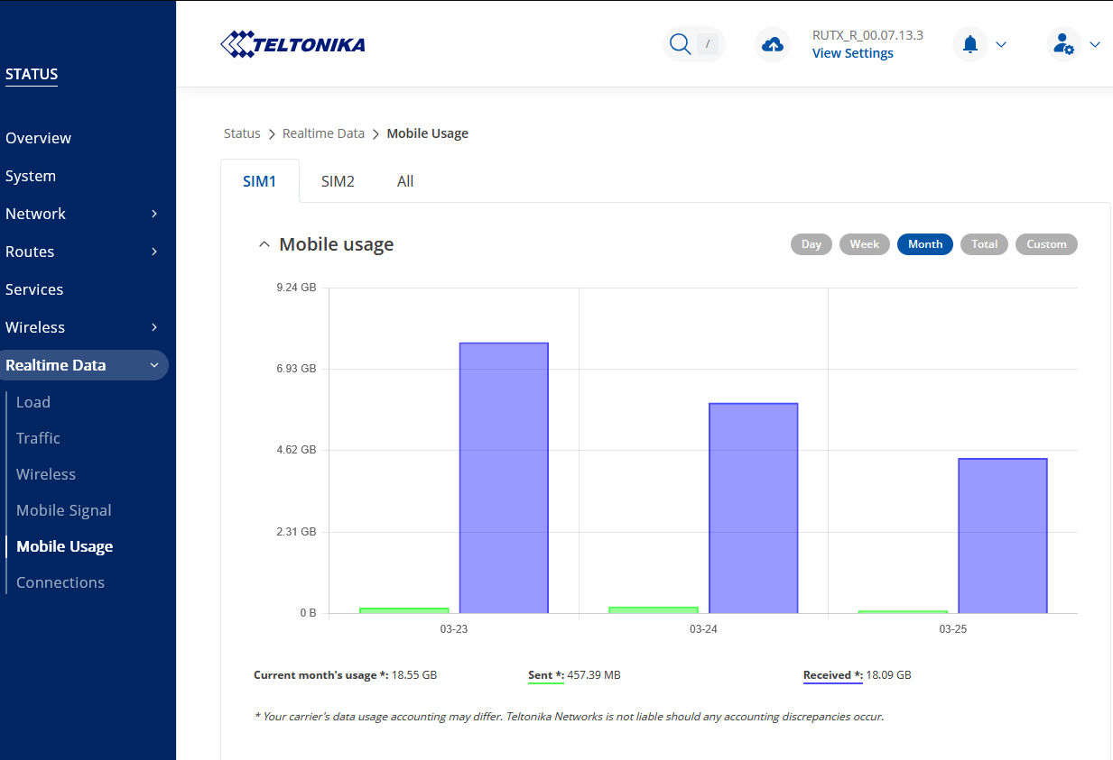

With RUTX_R_00.07.13.3 version on RUTX50 the data usage is only of 3 days in the month tab.
I’ve found topics older than 1 year here that said “devellopers are working on this issue”
Any update ?
it’s a bit annoying because data limit is wrong and count only the 3 last days as month data used

Could you also please provide a screenshot of the tab?

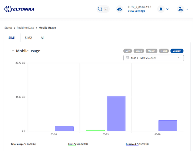

  1. Could you select a custom period to check if the data usage is still being shown for these 3 days? Kindly provide a screenshot as well if you can.

Hello
Please find the screenshot of a custom period that also only show the 3 last days.

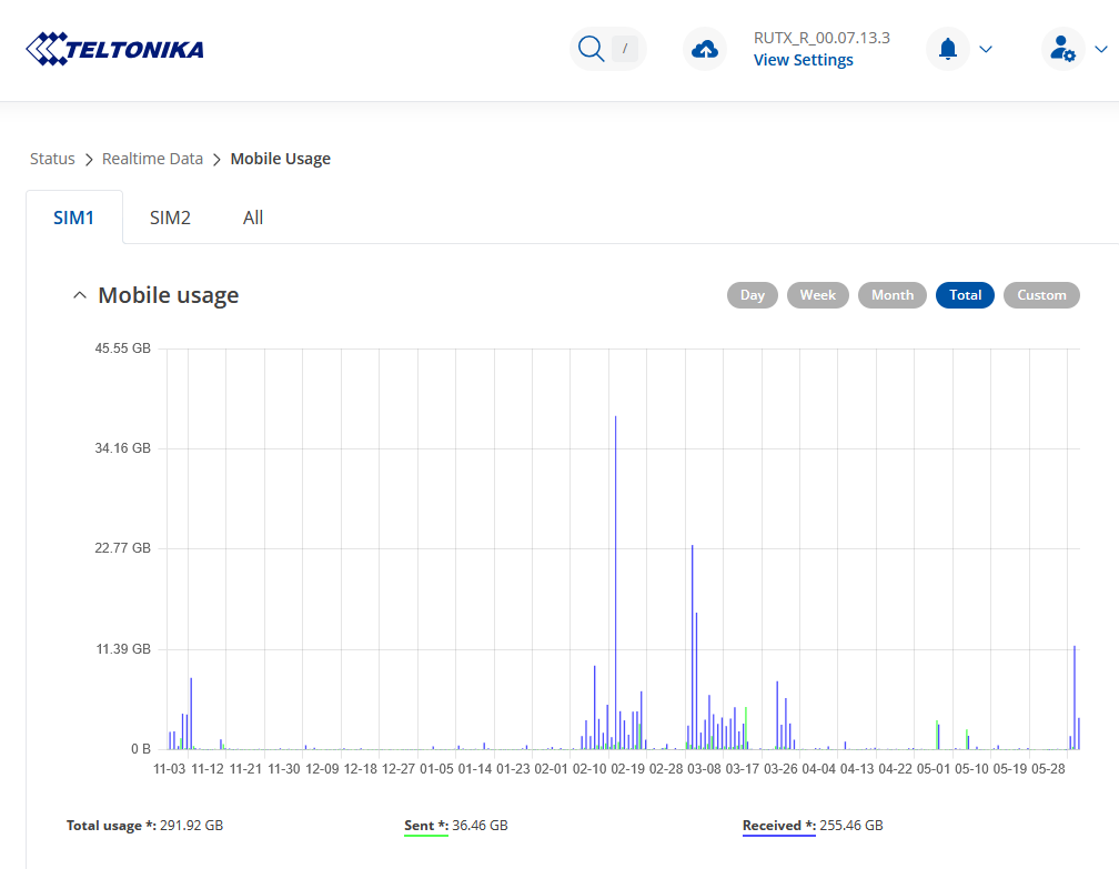

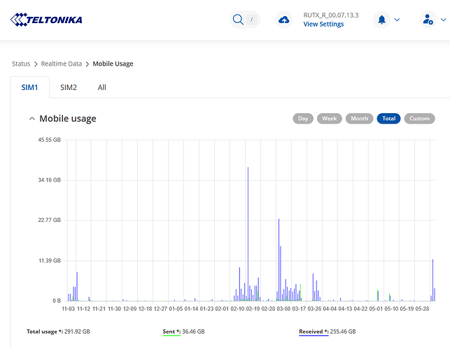

Deleting the db file then reboot did not solve the issue.
Should this delete all collected datas ?
Because there are still datas in the graph after delete and reboot :

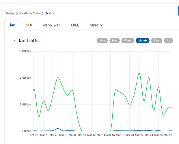

Hello
If it helps i’ve noticed that the traffic’s graph month tab is working fine
