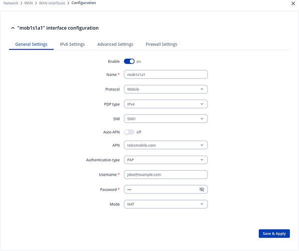

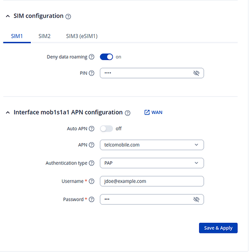

For reference:
My provider requires me to use IPv4 PDP, a specific APN, and PAP authentication.
The network is “Orange” (20801).
Is it RUTM’s fault or my provider’s?
Could you please confirm whether the SIM card works in another device (for example, your phone)? If so, are you able to establish an internet connection there?

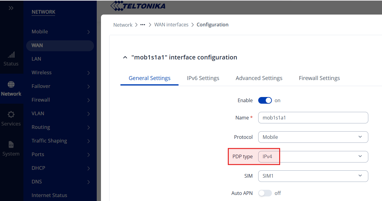

Additionally, have you set the PDP type to IPv4 only and configured the APN manually? You can check this by navigating to Network → WAN and clicking Edit on your mobile interface.
I can’t check whether the SIM is OK or not on another device/phone, I’ll try to next time I’m on site.
But note that out of the two 2 failing RUTMs, one is using a real physical SIM (v7.19.4) while the other one is using an eSIM (v7.17.5).
PDP is set to “IPv4” (only), also tried IPv4/IPv6 without any change.

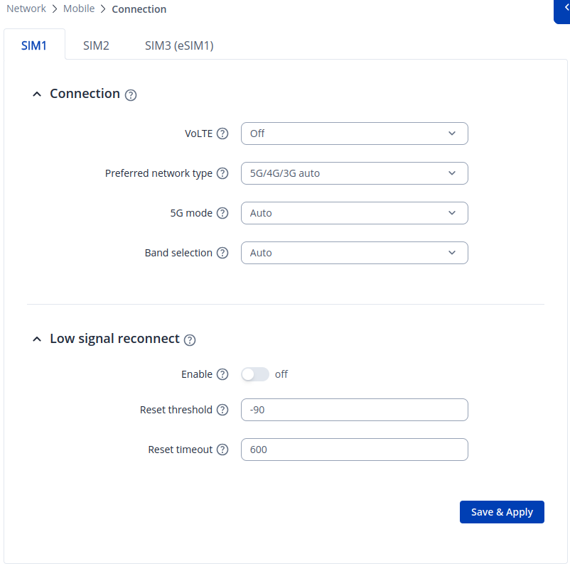

Also tried to play with Network>Mobile>Connection settings (VoLTE, network type, and 5G mode), also no changes.

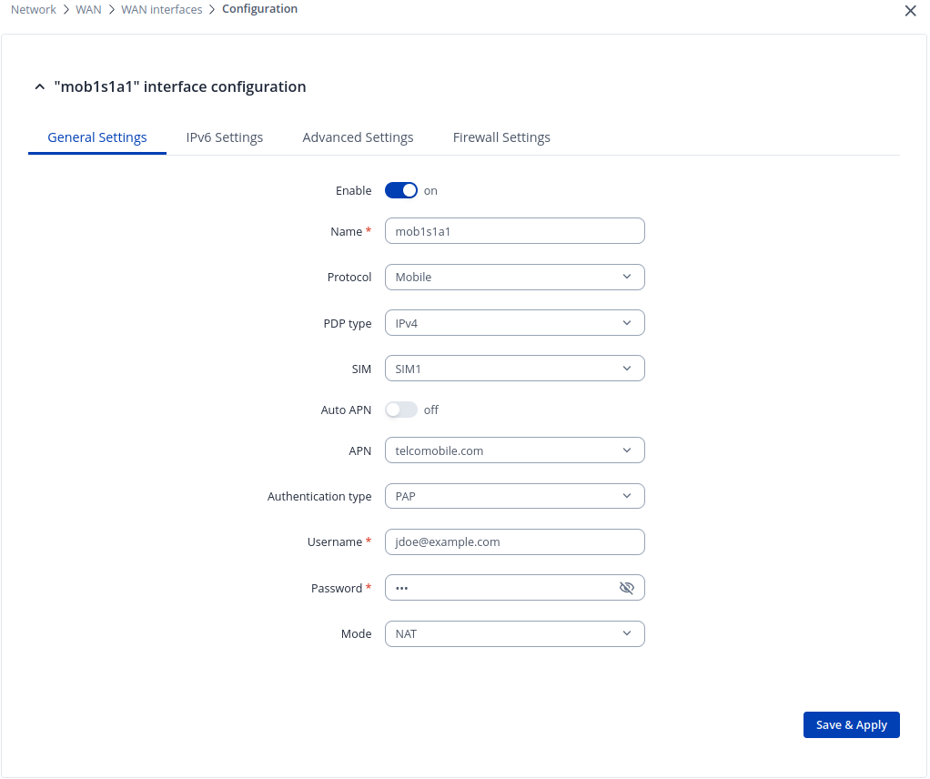

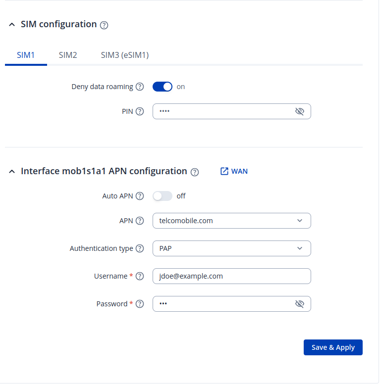

Here is the full configuration:

1244 Fri Jan  2 22:07:15 2026 user.notice qmux: mob1s1a1 teardown successful
Note: In the mean time, since my original post, I’ve updated the v7.19.4 RUTM to v7.20 (latest firmware), without any resolution.
@Justinas Do you have any idea of other settings to check?
For troubleshooting purposes, we will require more sensitive information from your end, such as the troubleshoot file, which may contain passwords, public IP addresses, serial numbers, and such. To avoid leaking this information, we have sent you a form to fill out, which you will receive in your e-mail inbox that you have registered your account with in the forums. In the Ticket ID field of the form, please enter the ID of this thread, which is 16912.
Thanks for re-opening the topic.
It took me time to gather the required information and I’ve sent (by e-mail to the provided hubspot e-mail address) them about 2 weeks ago but did not got any acknowledgment since then, and as this topic was closed in the mean time, I’m not sure if my message was received or got discard by some algorithm.
I’ve just resend the e-mail, we’ll see…
I have sent you an email.
