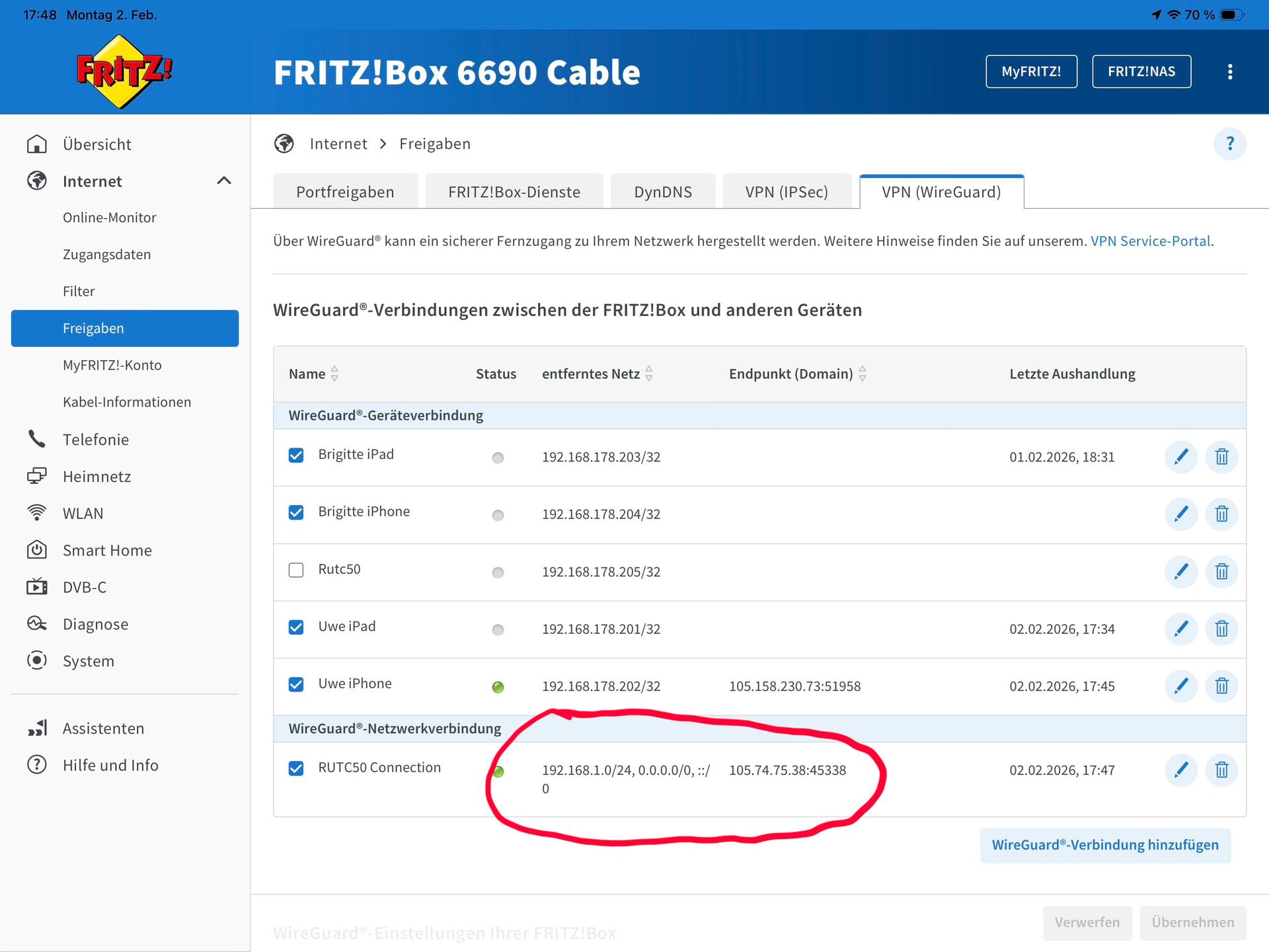

Both with RUTC50 and with iPad VPN I can connect to my FRITZ!Box and all systems at home
Here the connection established is via iPad
Here the connection via Rutc50 VPN

I can reach my FRITZ!Box both with Rutc50 and / or iPad VPN

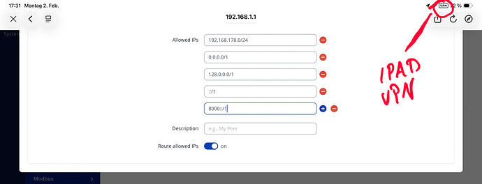

2 - on the RUTC50 set Allowed IPS to 0.0.0.0/1 + 128.0.0.0/1 + ::/1 + 8000::/1 in the wireguard config, this will force all traffic through the VPN.

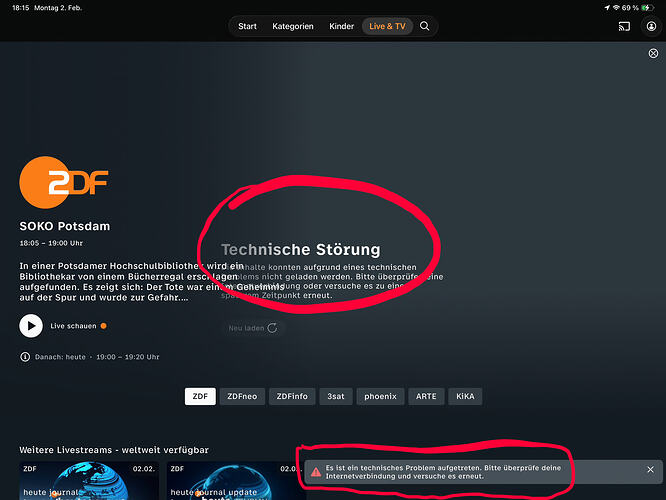

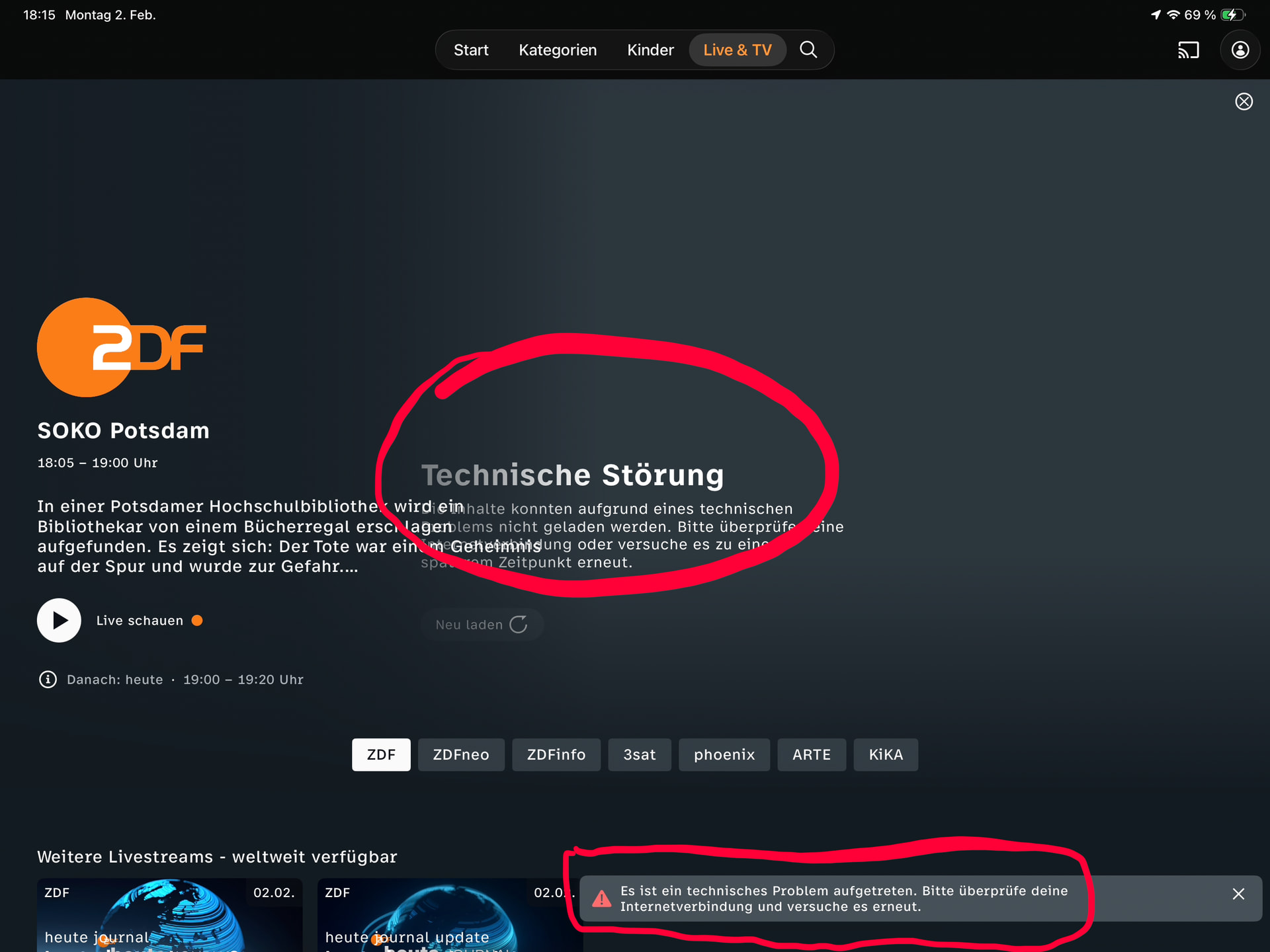

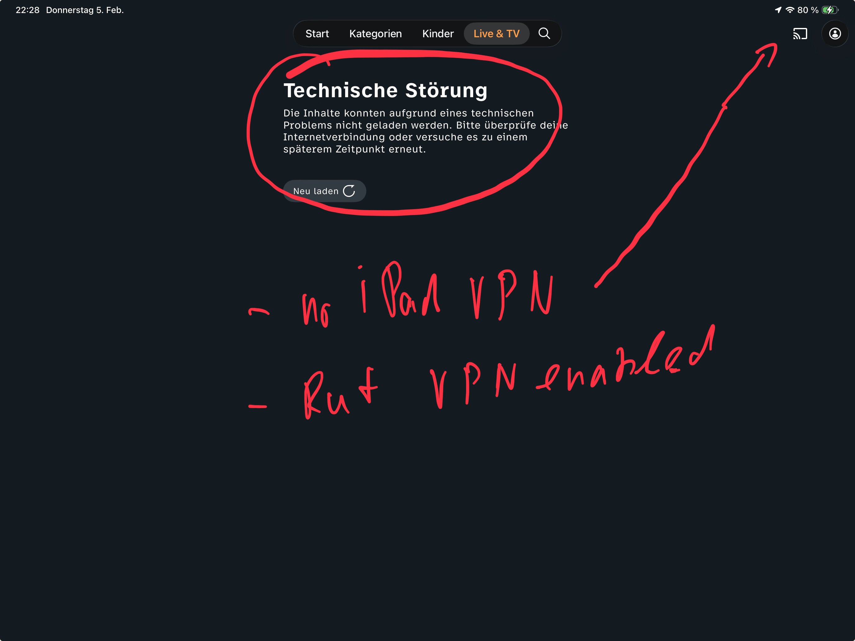

Enabling only VPN on Rutc50 :
the error is different now : instead of stating ‚German TV‘ not allowed in your country ( Marocco ) it now says : ‚Technical Problem‘. But no further details

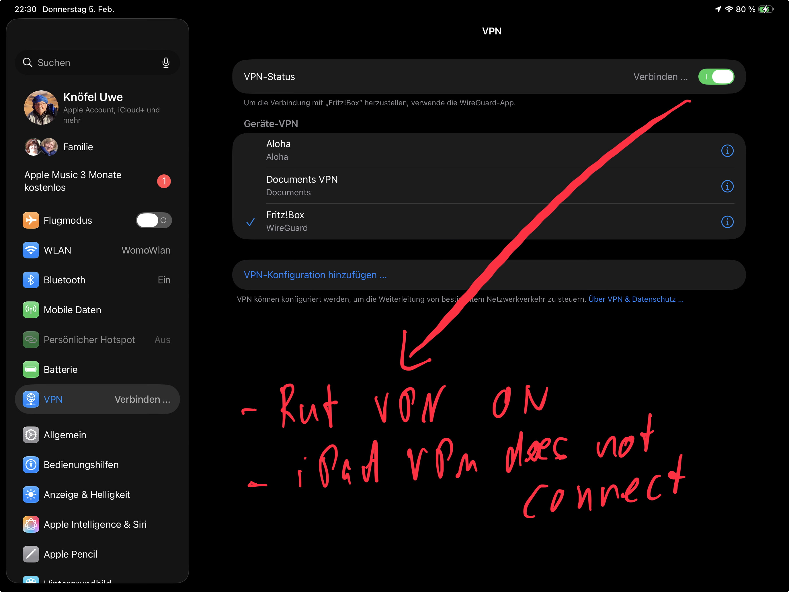

enabling both VPN on Rutc50 and iPhone causes somewhere an issue : TV apps try to stream, but TV stream cannot established at all and no error as well.

This is what the tv app is showing now

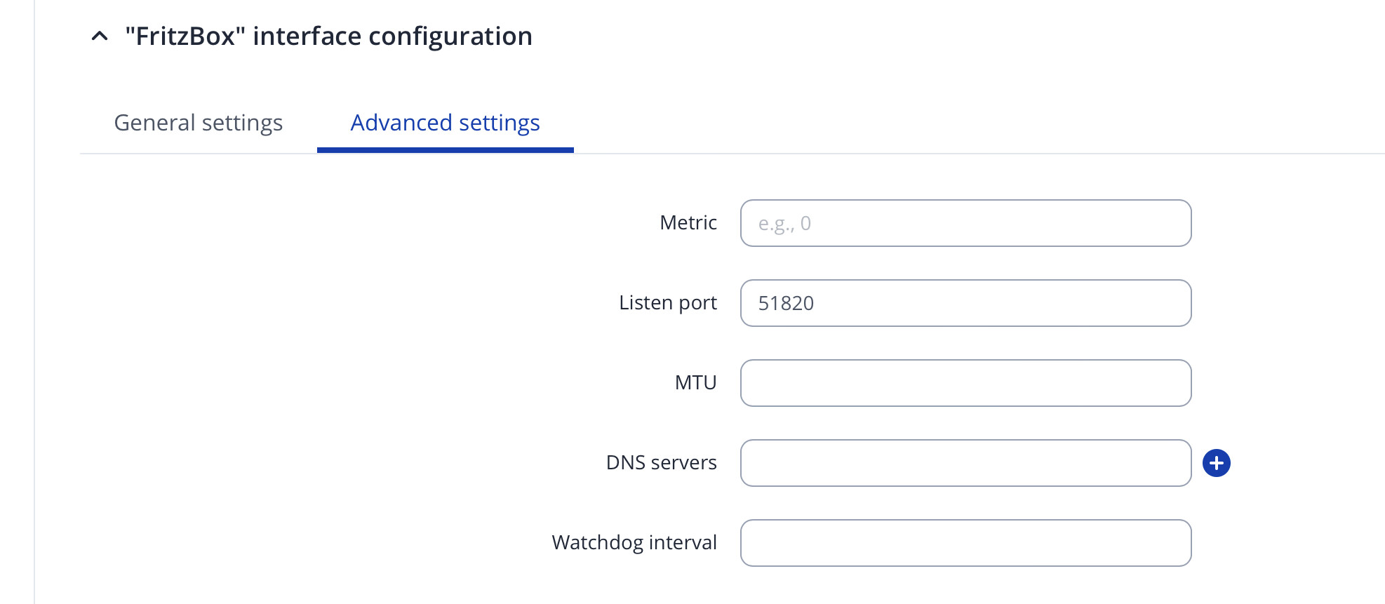

What MTU value do you use on the FB and RUT ?

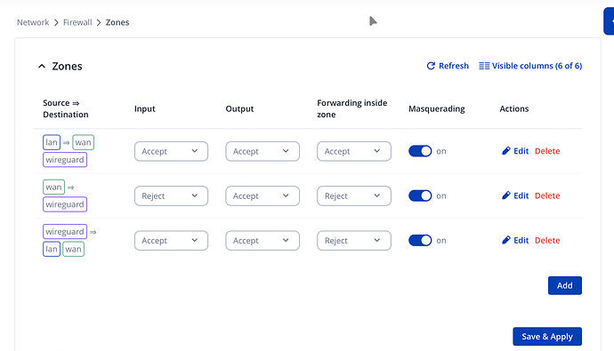

Next, could you go to Network → Firewall → Zones and edit the firewall zone that is Wireguard => LAN :

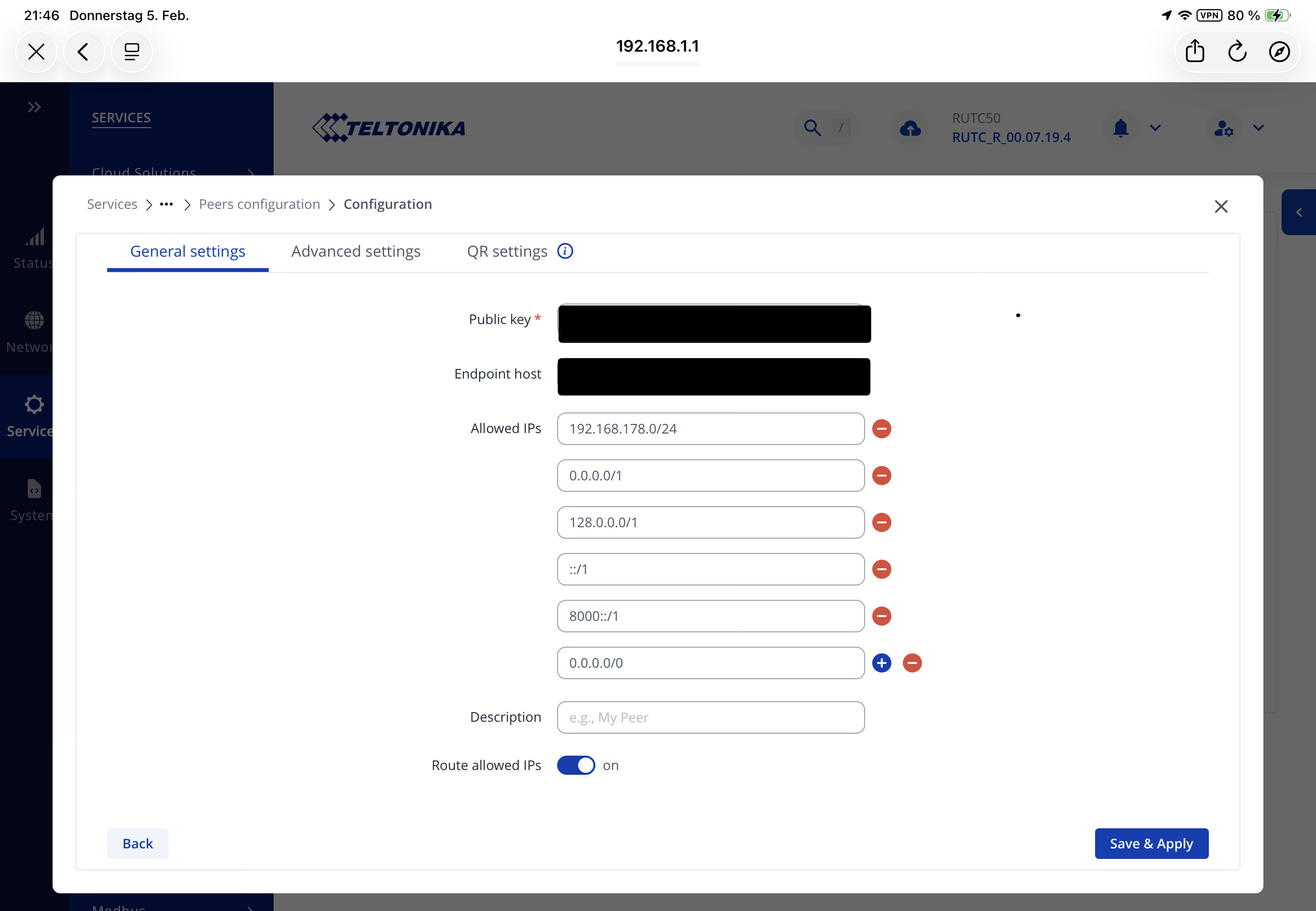

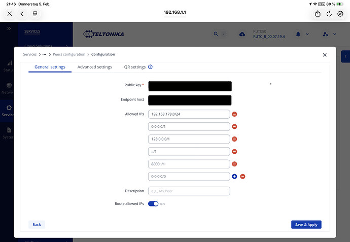

Next, on your RUTC50, head to the WireGuard settings, edit your Peer settings, and add 0.0.0.0/0 to the allowed IPs list, if you haven’t already - this will, however, create a full tunnel & route ALL the traffic through the VPN tunnel.

The MTU in Rut config is empty and on the FB side there is no MTU to set in the Wireguard config.

have edited the zones as per advice
Here how the peer setting now looks like :slight_smile:

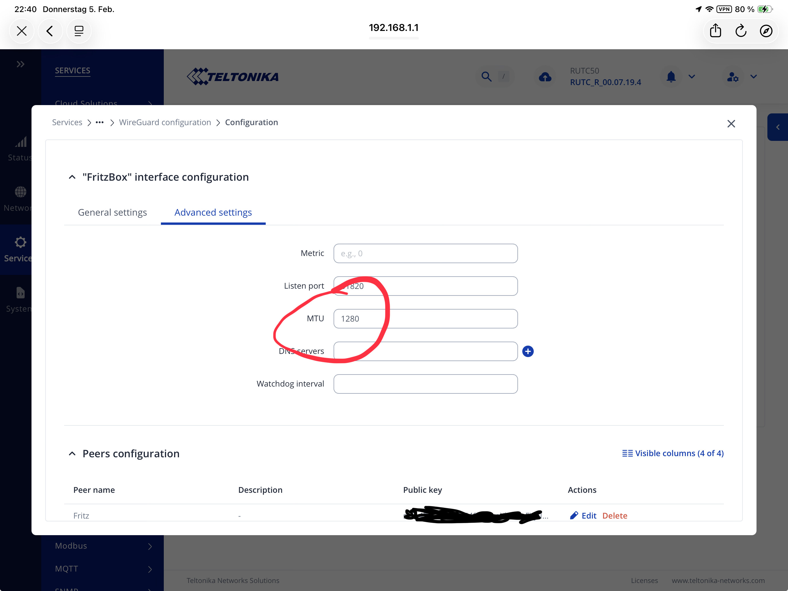

The absolute highest MTU value you can use for wg tunnels is 1420 bytes, and a commonly used one is 1280 bytes.
Could you retry with the MTU set at 1280 bytes on the RUT side ?
Changed the empty mtu to 1280

  • Rut vpn on, iPad VPN off → no tv
  • Rut vpn off, iPad vpn on → German tv works
  • Both rut vpn and iPad vpn on : the tv app tries forever, imcannot even connect to the FB

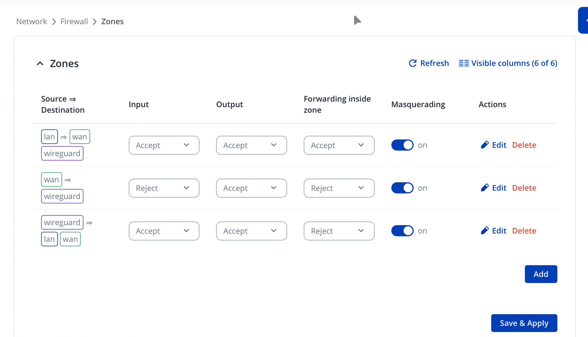

  • with regards to the zones, maybe I missunderstood what I should do. Here again the current zone config. Could you please tell me or mark which Zone could be deleted or changed ?

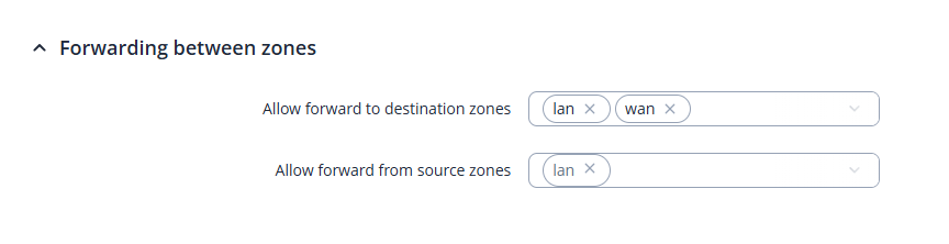

Here I’ll compare your Zones to mine:
Yours:
For some reason, your second zone is wan => wireguard instead of wan => reject; the other two zones look to be okay.
Next, as mentioned, in the Allow forward from source zones, you do not need to add the WAN zone; by default, it should only have LAN in it, like so:

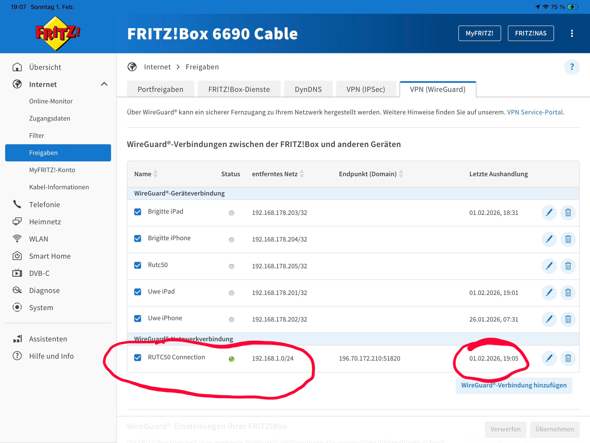

Yes, the RUTC50 connection appeared always as green ( connected ) in the Fritz!Box VPN list once I switch on VPN on the RUT, this was always the case since we configured as in the remote session July / August.
