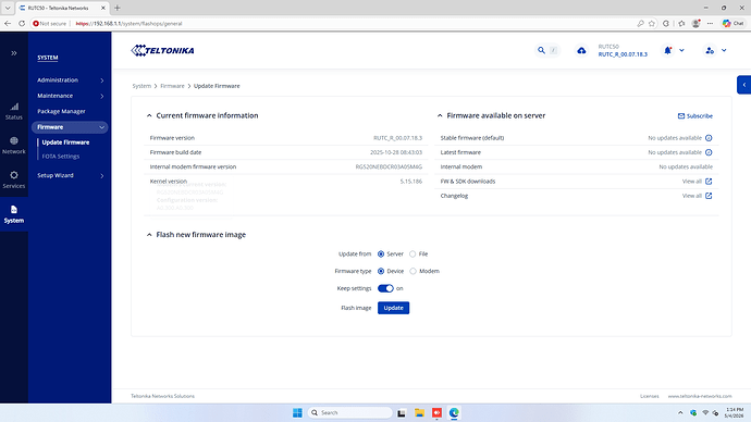

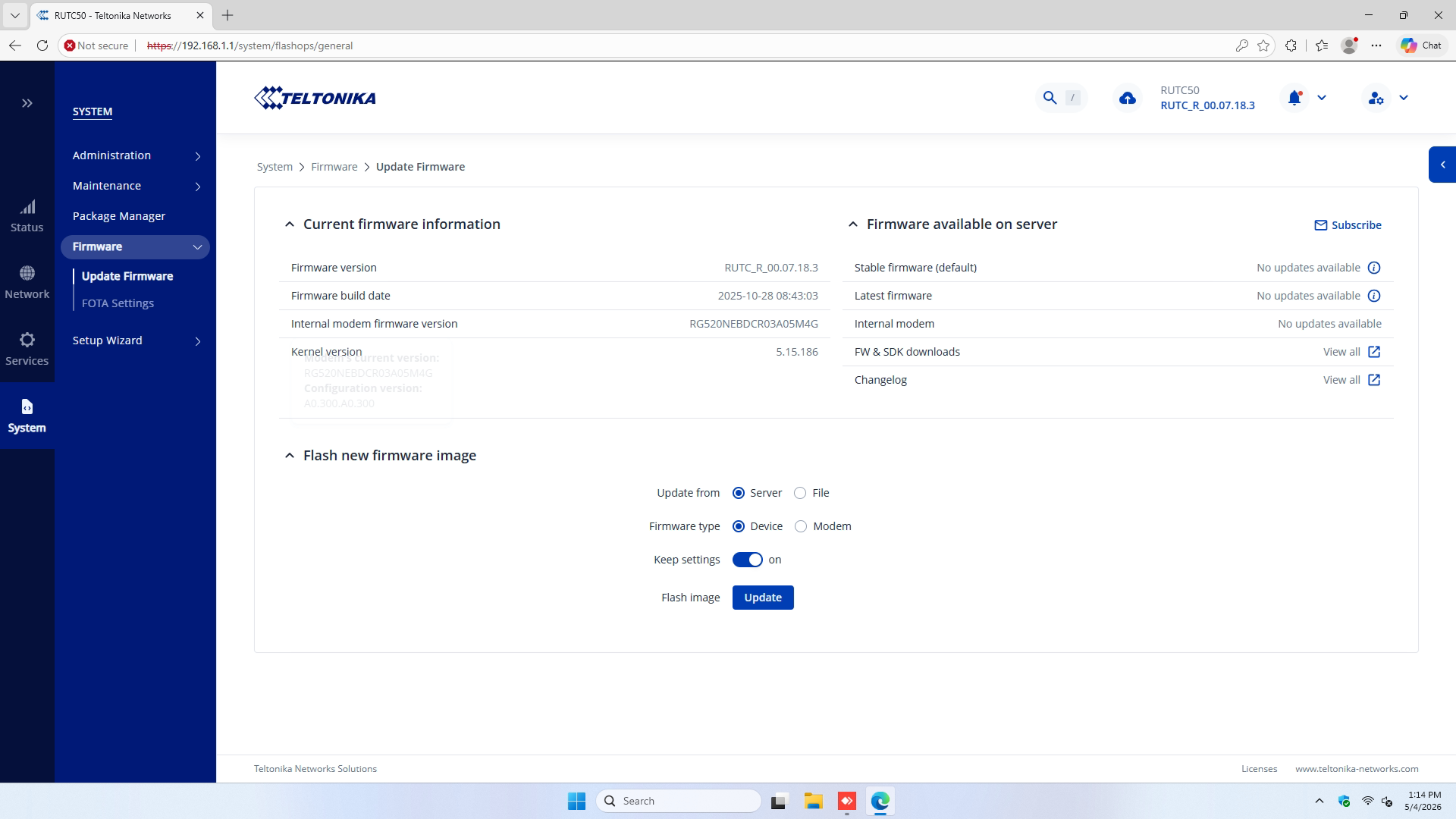

I just installed a RUTC50 (SN 6008268032) in an aluminum yacht with an external antenna A-MIMO-0003-V2-17. The mobile service is T-Mobile with a SIM card in slot 1. Firmware version RUTC_R_00.07.18.3, date 2025-10-28 08:43:03, Internal modem firmware version RG520NEBDCR03A05M4G_A0.300.A0.300, Kernel version 5.15.186. No more updates available.

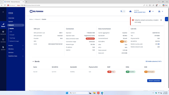

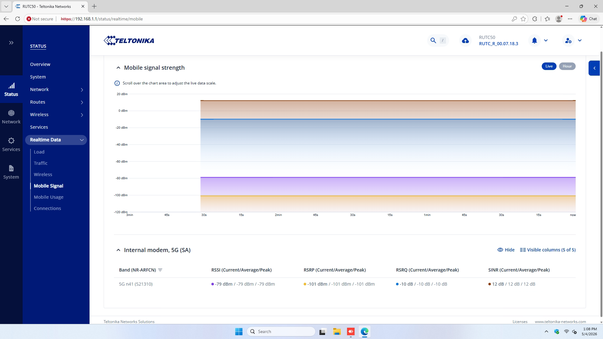

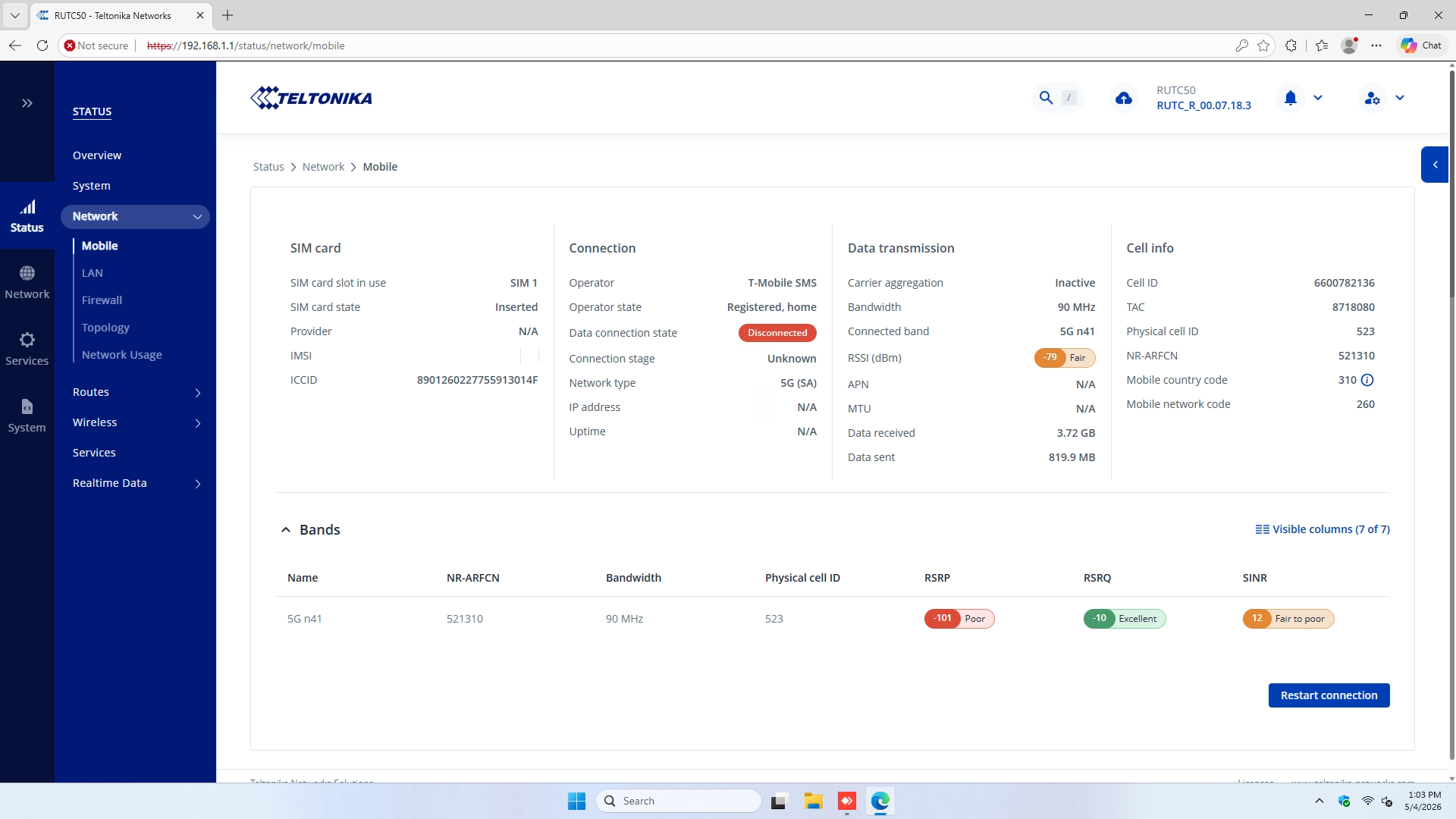

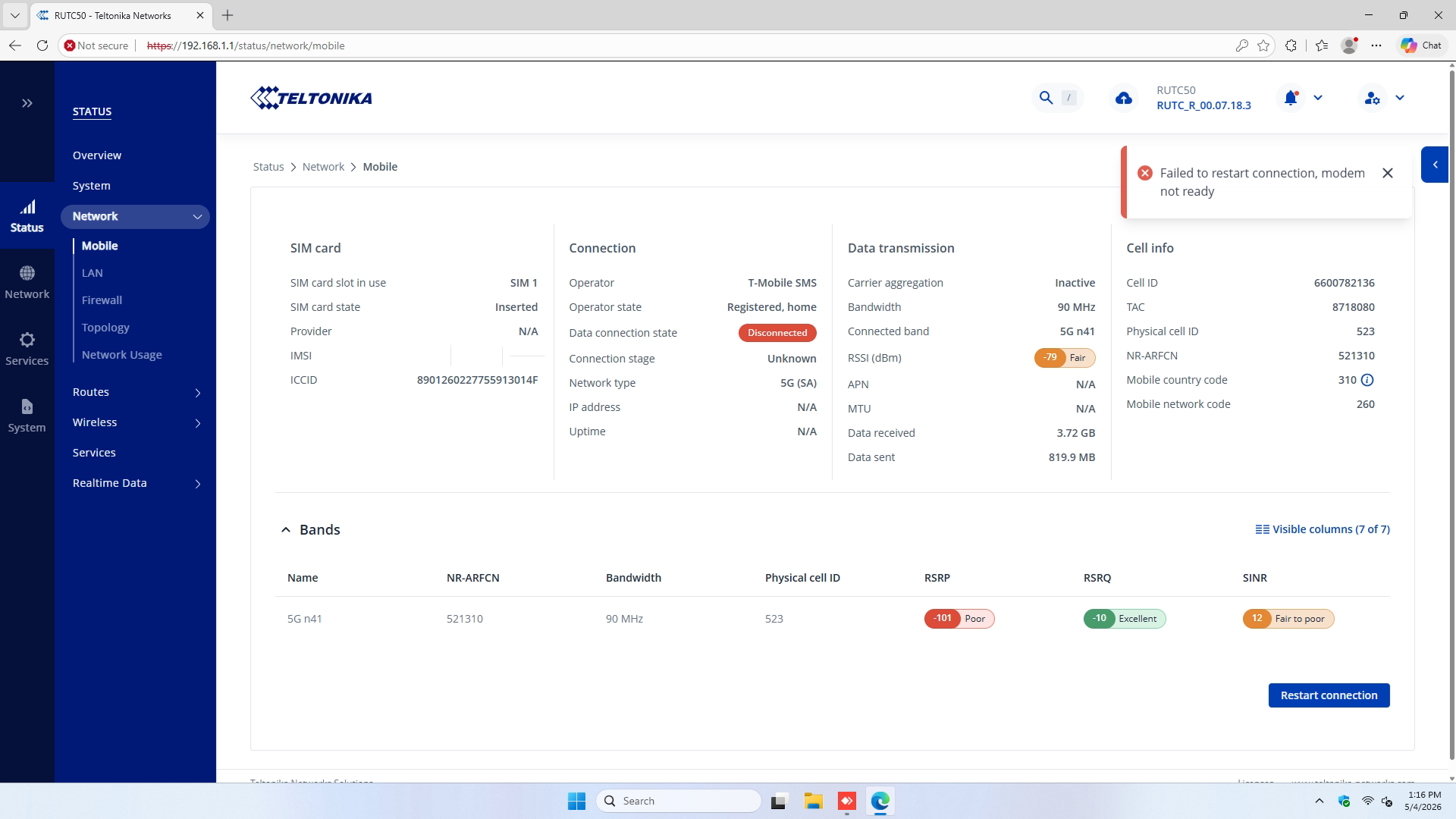

The connection cycle between connected and disconnected occurs every few minutes.

It sounds like you’re suffering from the problematic modem firmware update, of which there are several long posts in the last month.
Teltonika are working on a new firmware update but if you look at the other posts, there is a workaround and one of the posts describes the method to revert back to the previous firmware version. The downside is that to effect the ‘fix’, you will have to take the device home (or somewhere), where you can plug the Teltonika’s WAN port into a lan port of your home router with an internet connection.
