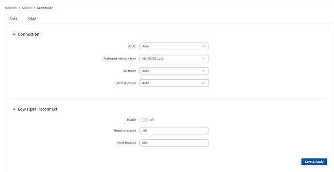

In your case, I would like to clarify whether low signal reconnect setting is switched on?
Also, do you use a manual APN? Are using Band lock functionality?

Hello, i have APN auto, and now i changed to manual. with same settings as i have the other device (Rutx50). Low signal recconect is disabled on both devices. Band is set on auto.
