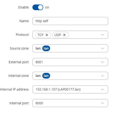

And if I understand correctly, your end goal is to access the Raspberry Pi / SSH (or web server) remotely from the WAN, and you already have a static public IP assigned, correct?
In that case, the port forwarding rule should point to the source zone “WAN” rather than “LAN”.
