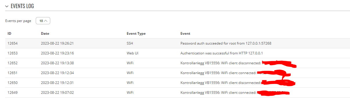

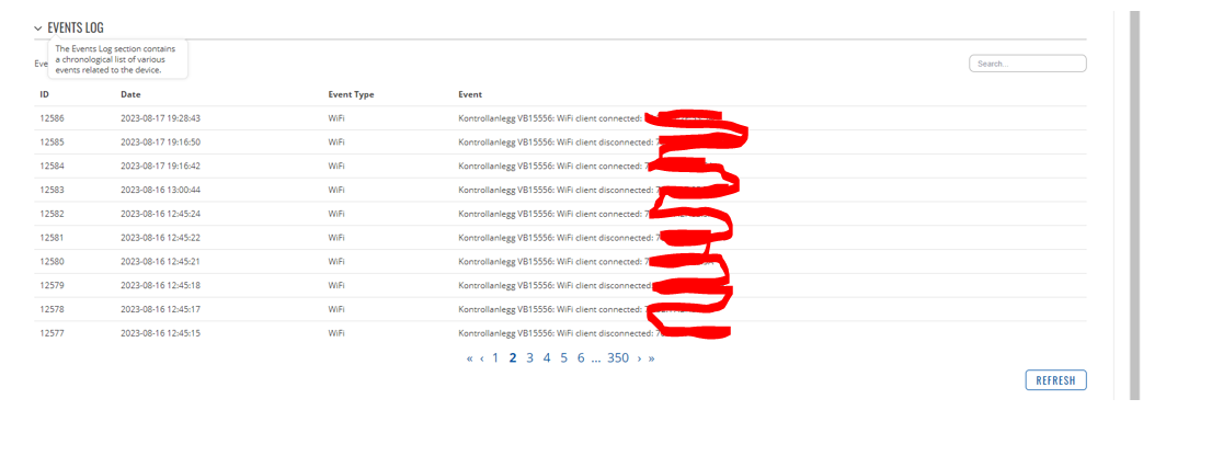

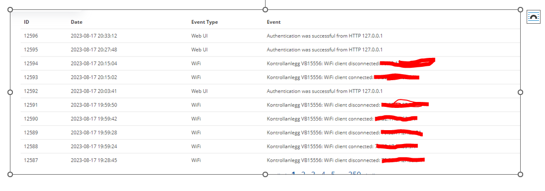

The PC cant find the WiFi, or it can see it but it wont connect the connecting to WiFi just “spins” endlessly with not result.

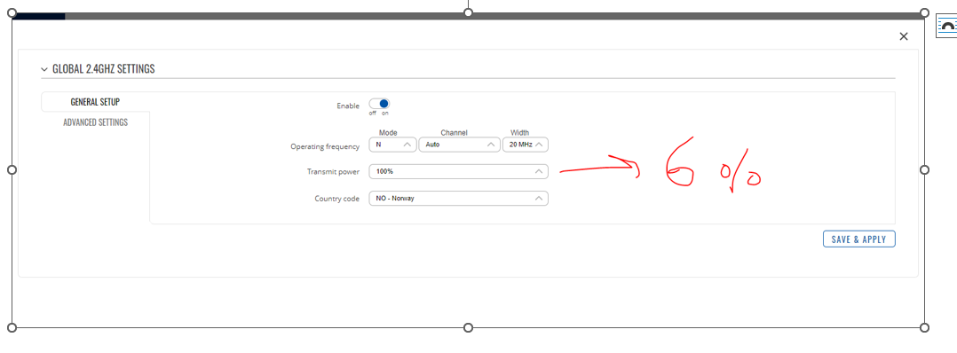

Last time i changed the transmit power from 6% to 100%, then it worked. But the same problem is happening now, so i gues it didnt change anything.
Could you please check if changing the operating frequency mode to legacy results in the same behaviour? It is available on the same page where you have changed the transmit power.

This is the systemlog for attached picture:
Tue Aug 22 19:07:02 2023 kern.notice Kontrollanlegg VB15556: WiFi client connected: sensored
Tue Aug 22 19:07:02 2023 daemon.info hostapd: wlan0: STA sensored RADIUS: starting accounting session 615303E0457493FC
Tue Aug 22 19:07:02 2023 daemon.info hostapd: wlan0: STA sensored WPA: pairwise key handshake completed (RSN)
Tue Aug 22 19:07:04 2023 daemon.warn openvpn(rms_9Gs86SvoeCNKAqYM)[4945]: NOTE: the current --script-security setting may allow this configuration to call user-defined scripts
Tue Aug 22 19:07:04 2023 daemon.notice openvpn(rms_9Gs86SvoeCNKAqYM)[4945]: TCP/UDP: Preserving recently used remote address: [AF_INET]3.69.106.81:36578
Tue Aug 22 19:07:04 2023 daemon.notice openvpn(rms_9Gs86SvoeCNKAqYM)[4945]: UDP link local: (not bound)
Tue Aug 22 19:07:04 2023 daemon.notice openvpn(rms_9Gs86SvoeCNKAqYM)[4945]: UDP link remote: [AF_INET]3.69.106.81:36578
Tue Aug 22 19:07:04 2023 daemon.info dnsmasq-dhcp[1434]: DHCPREQUEST(br-lan) 192.168.0.199 sensored
Tue Aug 22 19:07:04 2023 daemon.info dnsmasq-dhcp[1434]: DHCPACK(br-lan) 192.168.0.199 sensored DESKTOP-JABEACT
Tue Aug 22 19:07:19 2023 daemon.notice openvpn(rms_9Gs86SvoeCNKAqYM)[4945]: [UNDEF] Inactivity timeout (–ping-restart), restarting
Tue Aug 22 19:07:19 2023 daemon.notice openvpn(rms_9Gs86SvoeCNKAqYM)[4945]: SIGUSR1[soft,ping-restart] received, process restarting
Tue Aug 22 19:07:24 2023 daemon.warn openvpn(rms_9Gs86SvoeCNKAqYM)[4945]: NOTE: the current --script-security setting may allow this configuration to call user-defined scripts
Tue Aug 22 19:07:24 2023 daemon.notice openvpn(rms_9Gs86SvoeCNKAqYM)[4945]: TCP/UDP: Preserving recently used remote address: [AF_INET]3.65.167.143:36578
Tue Aug 22 19:07:24 2023 daemon.notice openvpn(rms_9Gs86SvoeCNKAqYM)[4945]: UDP link local: (not bound)
Tue Aug 22 19:07:24 2023 daemon.notice openvpn(rms_9Gs86SvoeCNKAqYM)[4945]: UDP link remote: [AF_INET]3.65.167.143:36578
Tue Aug 22 19:07:25 2023 daemon.notice openvpn(rms_9Gs86SvoeCNKAqYM)[4945]: [teltonika-vpn-9Gs86SvoeCNKAqYM] Peer Connection Initiated with [AF_INET]3.65.167.143:36578
Tue Aug 22 19:07:25 2023 daemon.notice openvpn(rms_9Gs86SvoeCNKAqYM)[4945]: TUN/TAP device tun_c_rms_9Gs86 opened
Tue Aug 22 19:07:25 2023 daemon.notice openvpn(rms_9Gs86SvoeCNKAqYM)[4945]: net_iface_mtu_set: mtu 1500 for tun_c_rms_9Gs86
Tue Aug 22 19:07:25 2023 daemon.notice openvpn(rms_9Gs86SvoeCNKAqYM)[4945]: net_iface_up: set tun_c_rms_9Gs86 up
Tue Aug 22 19:07:25 2023 daemon.notice openvpn(rms_9Gs86SvoeCNKAqYM)[4945]: net_addr_ptp_v4_add: 192.168.255.6 peer 192.168.255.5 dev tun_c_rms_9Gs86
Tue Aug 22 19:07:25 2023 daemon.notice openvpn(rms_9Gs86SvoeCNKAqYM)[4945]: /etc/openvpn/updown.sh tun_c_rms_9Gs86 1500 1553 192.168.255.6 192.168.255.5 init
Tue Aug 22 19:07:25 2023 daemon.notice openvpn(rms_9Gs86SvoeCNKAqYM)[4945]: Initialization Sequence Completed
Tue Aug 22 19:07:27 2023 daemon.info dnsmasq[1434]: exiting on receipt of SIGTERM
Tue Aug 22 19:07:27 2023 daemon.info dnsmasq[1827]: Connected to system UBus
Tue Aug 22 19:07:27 2023 daemon.info dnsmasq[1827]: started, version 2.85 cachesize 150
Tue Aug 22 19:07:27 2023 daemon.info dnsmasq[1827]: compile time options: IPv6 GNU-getopt no-DBus UBus no-i18n no-regex no-IDN DHCP no-DHCPv6 no-Lua TFTP no-conntrack no-ipset no-auth no-cryptohash no-DNSSEC no-ID loop-detect inotify dumpfile
Tue Aug 22 19:07:27 2023 daemon.info dnsmasq[1827]: UBus support enabled: connected to system bus
Tue Aug 22 19:07:27 2023 daemon.info dnsmasq-dhcp[1827]: DHCP, IP range 192.168.0.100 – 192.168.0.249, lease time 12h
Tue Aug 22 19:07:28 2023 daemon.info dnsmasq[1827]: using only locally-known addresses for domain test
Tue Aug 22 19:07:28 2023 daemon.info dnsmasq[1827]: using only locally-known addresses for domain onion
Tue Aug 22 19:07:28 2023 daemon.info dnsmasq[1827]: using only locally-known addresses for domain localhost
Tue Aug 22 19:07:28 2023 daemon.info dnsmasq[1827]: using only locally-known addresses for domain invalid
Tue Aug 22 19:07:28 2023 daemon.info dnsmasq[1827]: using only locally-known addresses for domain bind
Tue Aug 22 19:07:28 2023 daemon.info dnsmasq[1827]: using only locally-known addresses for domain lan
Tue Aug 22 19:07:28 2023 daemon.info dnsmasq[1827]: reading /tmp/resolv.conf.d/resolv.conf.auto
Tue Aug 22 19:07:28 2023 daemon.info dnsmasq[1827]: using nameserver 193.213.112.4#53
Tue Aug 22 19:07:28 2023 daemon.info dnsmasq[1827]: using nameserver 130.67.15.198#53
Tue Aug 22 19:07:28 2023 daemon.info dnsmasq[1827]: read /etc/hosts - 4 addresses
Tue Aug 22 19:07:28 2023 daemon.info dnsmasq[1827]: read /tmp/hosts/dhcp.cfg01411c - 1 addresses
Tue Aug 22 19:07:28 2023 daemon.info dnsmasq-dhcp[1827]: read /etc/ethers - 0 addresses
Tue Aug 22 19:07:28 2023 daemon.info hostapd: wlan0: STA sensored WPA: group key handshake completed (RSN)
Tue Aug 22 19:12:17 2023 daemon.notice openvpn(rms_9Gs86SvoeCNKAqYM)[4945]: [teltonika-vpn-9Gs86SvoeCNKAqYM] Inactivity timeout (–ping-restart), restarting

Tue Aug 22 19:12:31 2023 daemon.notice hostapd: wlan0: AP-STA-DISCONNECTED sensored
Tue Aug 22 19:12:31 2023 kern.notice Kontrollanlegg VB15556: WiFi client disconnected: sensored
Tue Aug 22 19:12:31 2023 daemon.notice hostapd: wlan0: STA sensored IEEE 802.11: did not acknowledge authentication response
Tue Aug 22 19:12:32 2023 daemon.notice hostapd: wlan0: STA sensored IEEE 802.11: did not acknowledge authentication response
Tue Aug 22 19:12:33 2023 daemon.notice hostapd: wlan0: STA sensored IEEE 802.11: did not acknowledge authentication response
Tue Aug 22 19:12:34 2023 daemon.info hostapd: wlan0: STA sensored IEEE 802.11: authenticated
Tue Aug 22 19:12:34 2023 daemon.info hostapd: wlan0: STA sensored IEEE 802.11: associated (aid 1)
Tue Aug 22 19:12:34 2023 daemon.notice hostapd: wlan0: AP-STA-CONNECTED sensored
Tue Aug 22 19:12:34 2023 kern.notice Kontrollanlegg VB15556: WiFi client connected: sensored
Tue Aug 22 19:12:34 2023 daemon.info hostapd: wlan0: STA sensored RADIUS: starting accounting session 615303E0457493FC
Tue Aug 22 19:12:34 2023 daemon.info hostapd: wlan0: STA sensored WPA: pairwise key handshake completed (RSN)
Tue Aug 22 19:12:40 2023 daemon.info dnsmasq-dhcp[3298]: DHCPREQUEST(br-lan) 192.168.0.199 sensored
Tue Aug 22 19:12:40 2023 daemon.info dnsmasq-dhcp[3298]: DHCPACK(br-lan) 192.168.0.199 sensored DESKTOP-JABEACT
Tue Aug 22 19:13:38 2023 daemon.info hostapd: wlan0: STA sensored IEEE 802.11: disconnected due to excessive missing ACKs
Tue Aug 22 19:13:38 2023 daemon.notice hostapd: wlan0: AP-STA-DISCONNECTED sensored
Tue Aug 22 19:13:38 2023 kern.notice Kontrollanlegg VB15556: WiFi client disconnected: sensored
Tue Aug 22 19:13:49 2023 daemon.info hostapd: wlan0: STA sensored IEEE 802.11: authenticated

Could you try disabling ‘Disassociate On Low Acknowledgement’ option in Advanced settings for your WiFi instance?
You have also mentioned that the situation improved when you increased transmission power. What is the environment like where the device is located? Are your devices close to RUT955? Are the WiFi antennas properly attached?
Other than that, I suggest trying the legacy mode to see if the issue reoccurs. You can also try changing the WiFi channel width to see if there are improvements.
